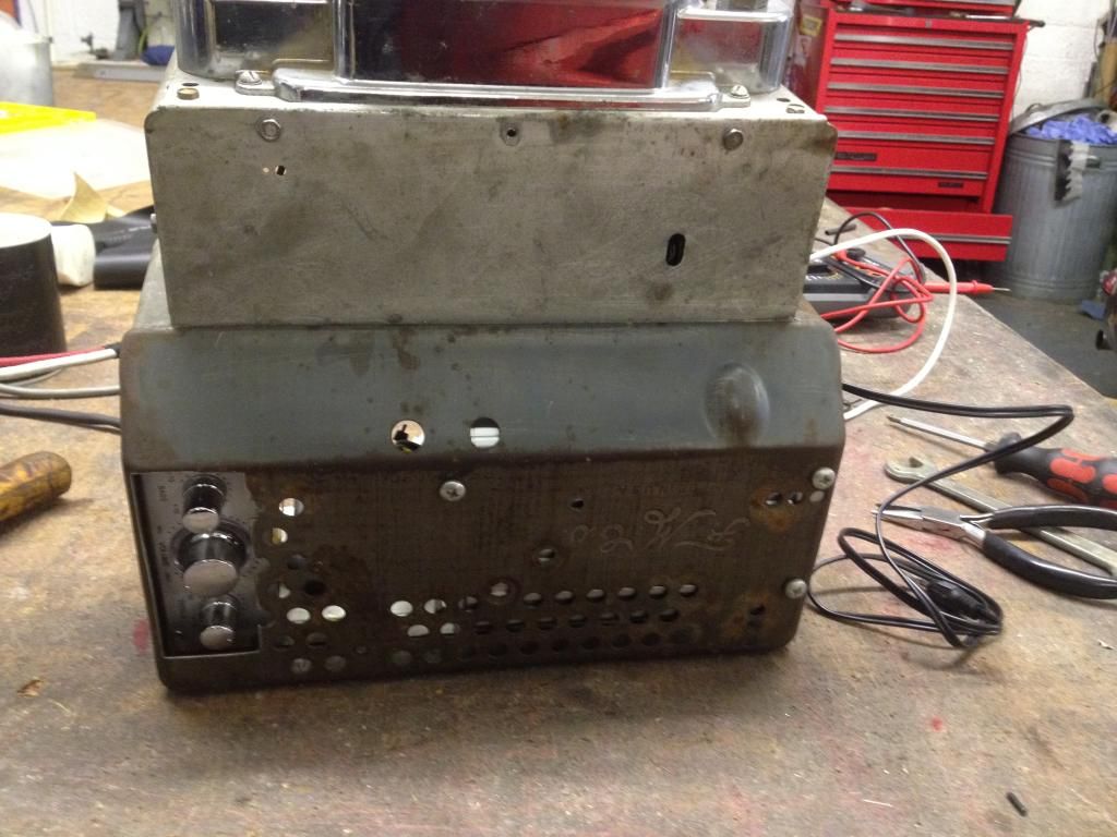

  23. KFC
    Joined: Jul 17, 2008
    Posts: 456
    KFC
    from UK
    I ended up doing this , retro sounds twin voice coil speaker in original location , Chinese 25w ebay amp, s beefy voltage converter from newzealand inside the original radio, I will also connect the cigarette lighter to it to charge and run sat nav.
    The whole set up turns on as the original radio did and lights up, I will set the amp to full and use the volume on my I phone .
    daddio211 and stealthcruiser like this.
