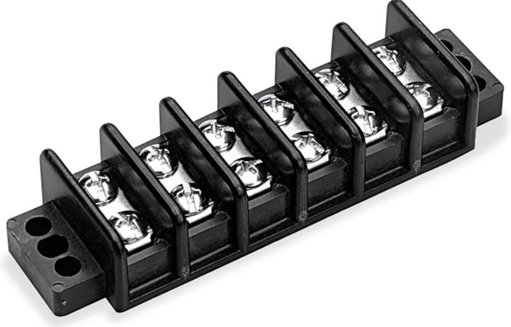

    I did my core support junctions behind the head lamps (inside the bucket) on the avatar car. IMG_2871.jpeg
