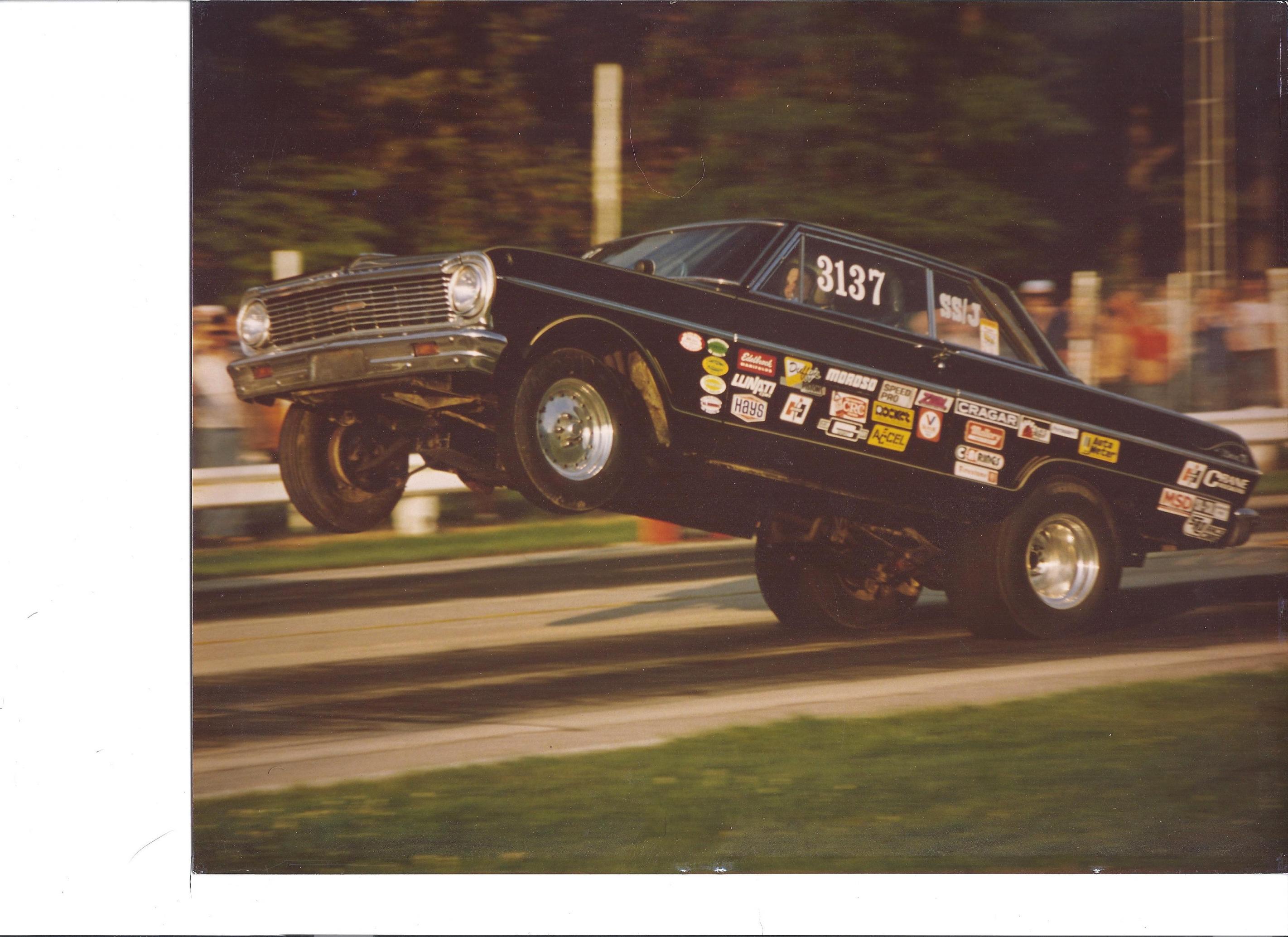

  27. my C/SM nova only ran 11.40 on a 11.00 index and 118mph budget motor and a newby 25 year old builder(me) I don't have many pics I'll try to find some,we didn't take many pics back then
    I just got THE 302 crank back to-day needed to be machined as it had rust on it do to poor storage the 302 is going into an altered the build has been slow because i'm retired on a limited income.
