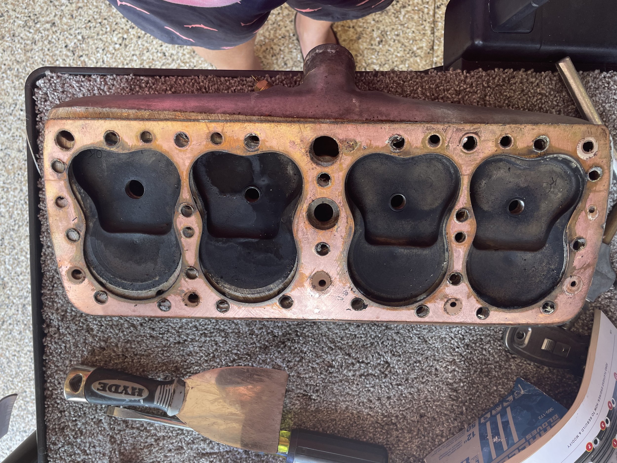

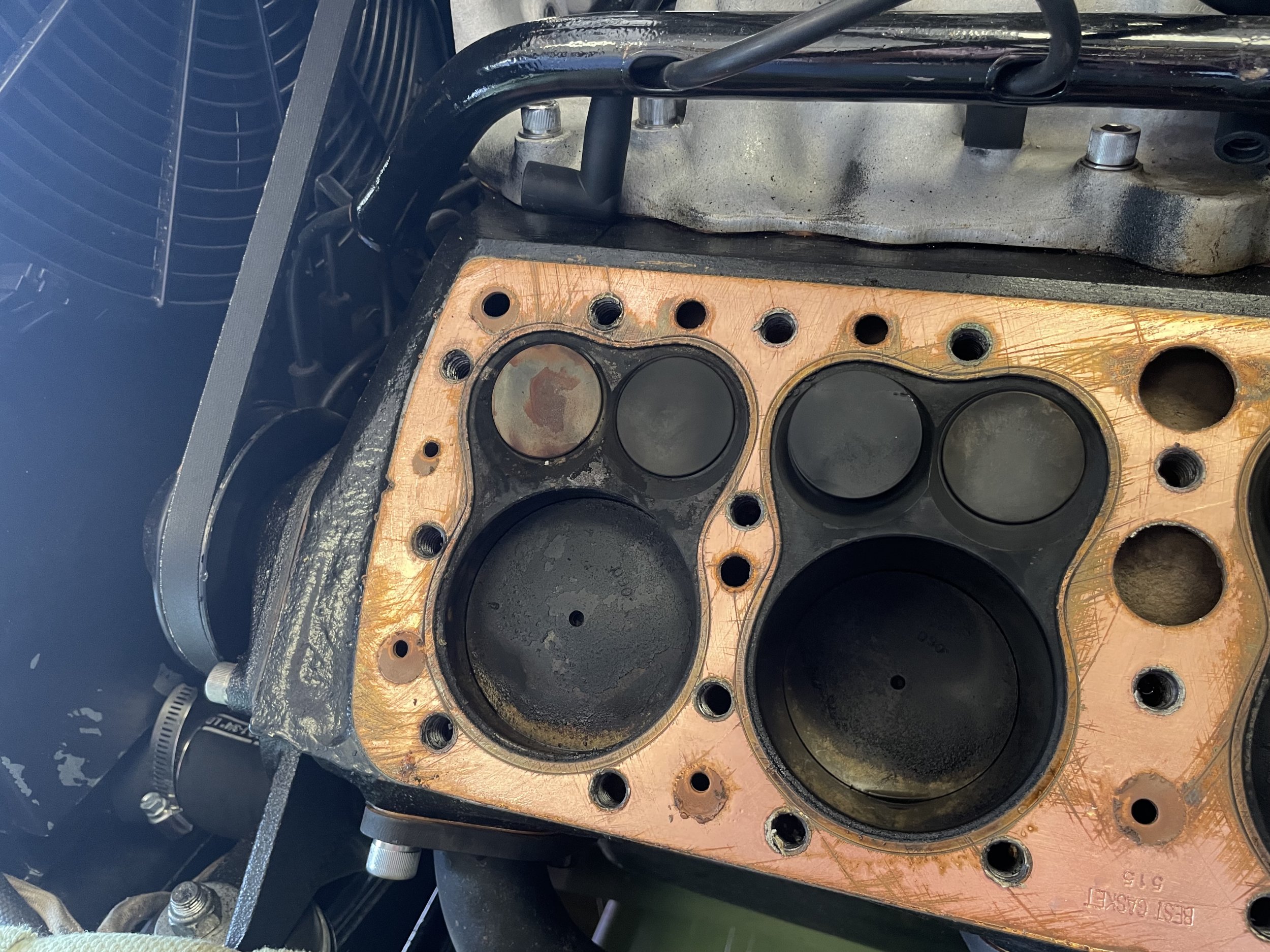

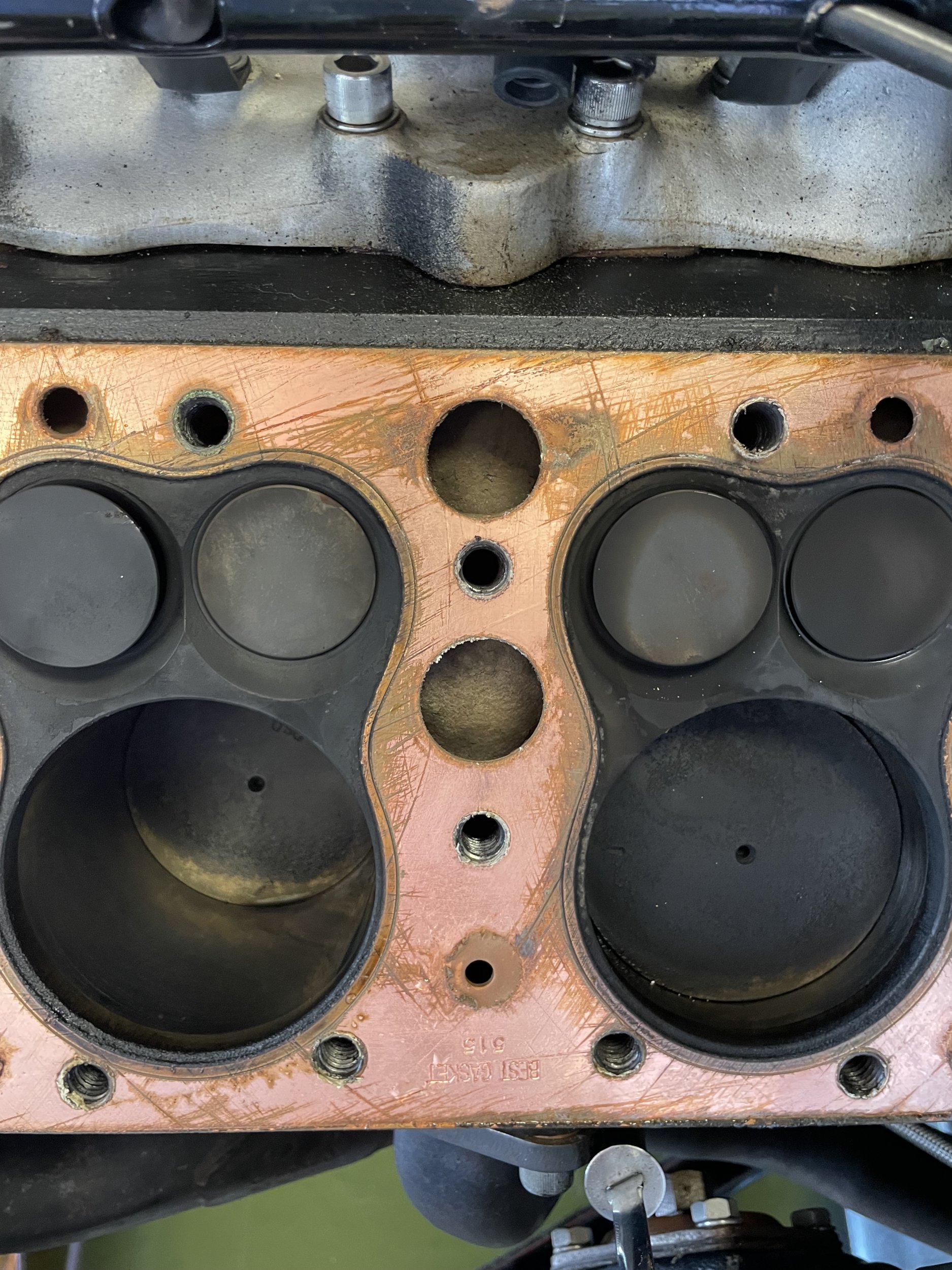

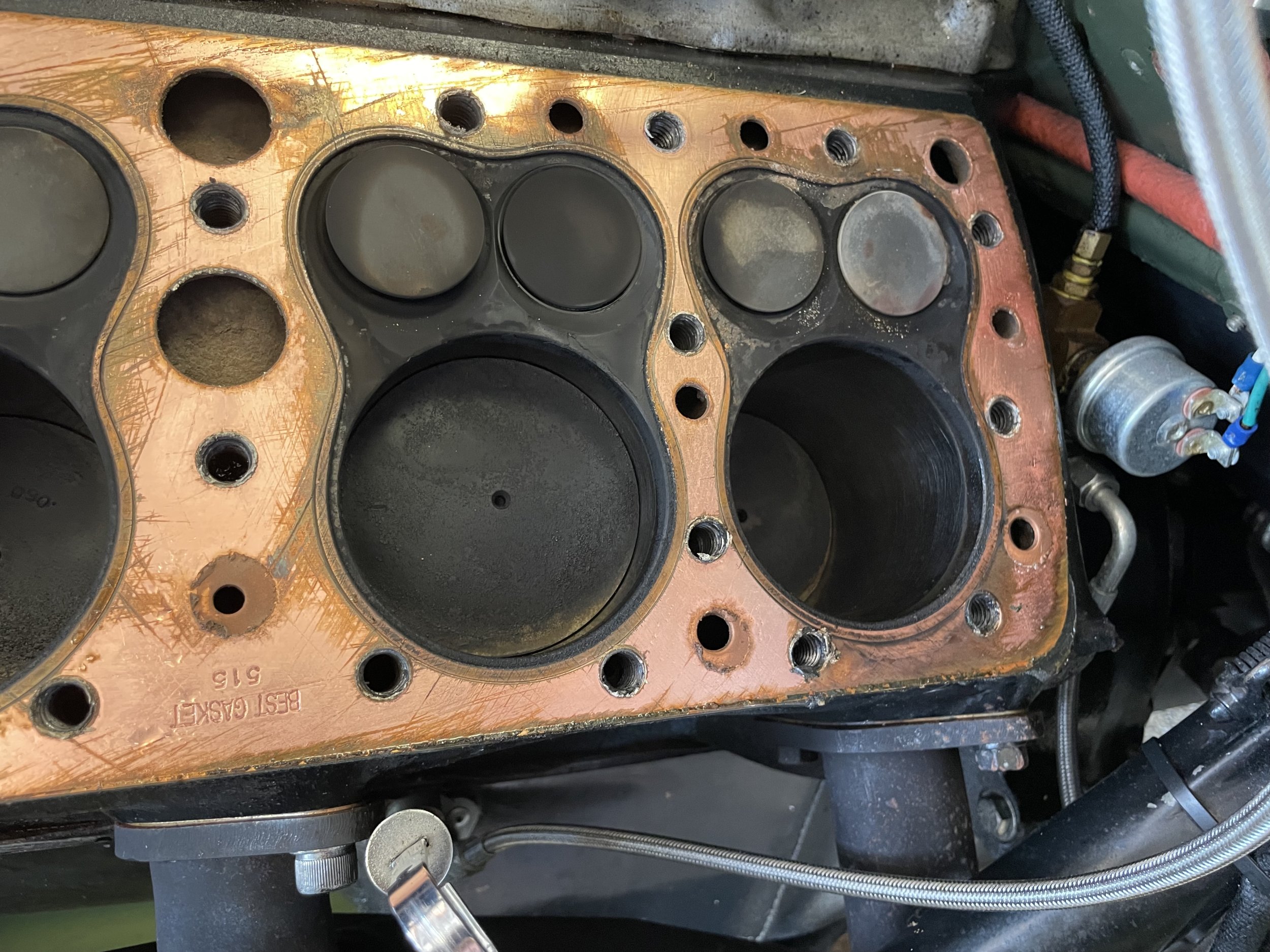

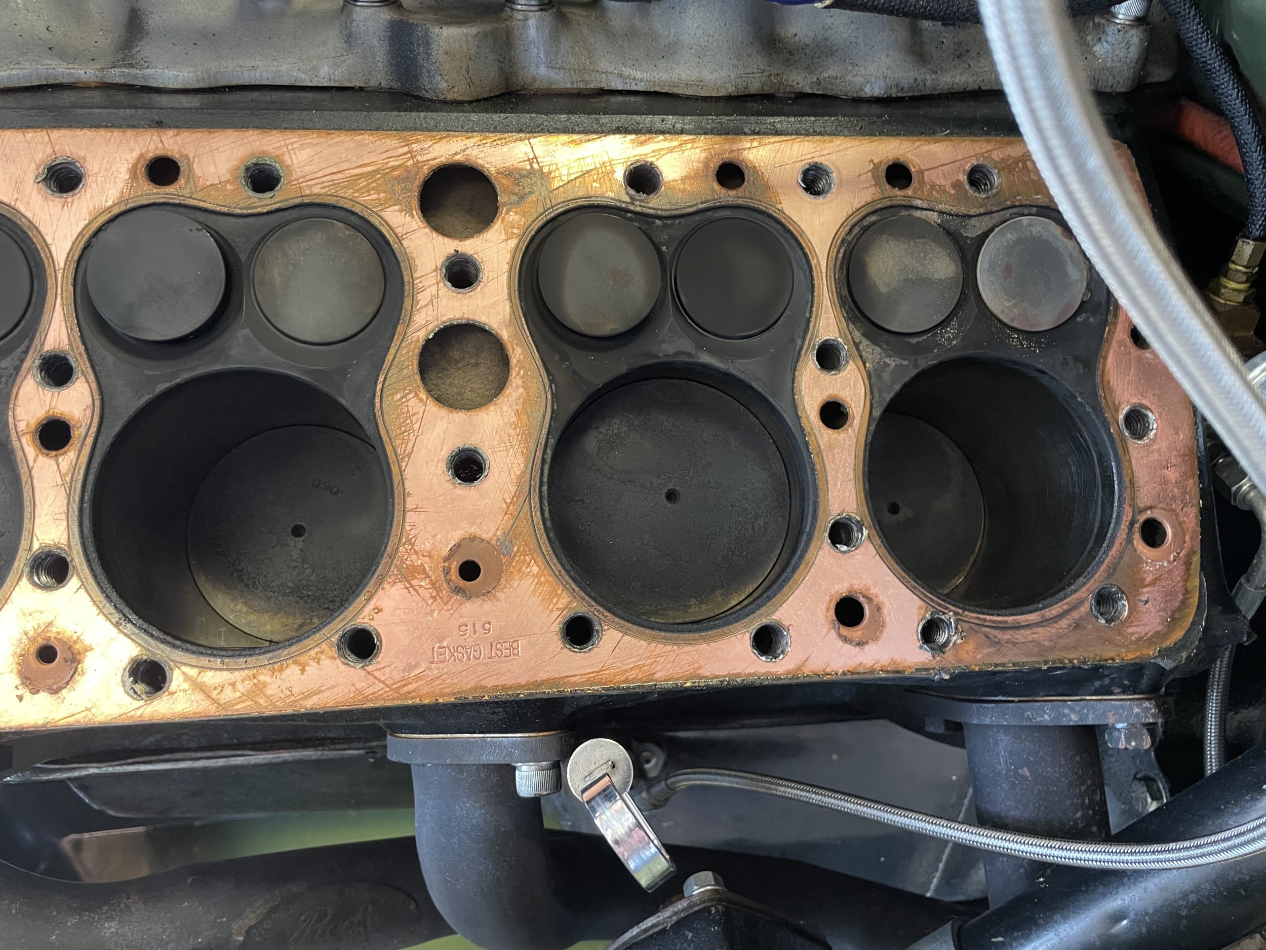

    Well here’s what I found so far, 48 flat head Edmunds 52 era heads. Found a small water drip at driver corner of head. Isolated it between head and block just a slight leak. Decided to pull head. I could tell on copper Best Gasket (speedway) #1550 with added copper coat upon installation. I could see the darkness on copper of leak. Head and gasket latterly just came off easy. I laid every thing out on bench itching my head. Looking for why. Then bang the light came on. The water jack holes were really reduced in size on copper gasket very restrictive. Thinking this right here could be lots of my wonders and whys. I’ve purchased fel-pro #7548 since the water p***ages are matched to block. Now to pull p***enger side and give it a run. I just can’t believe I did not catch this on build. I’ve taken photos of gaskets and head and block to give reference. I’ll give a heads up further down the road folks.

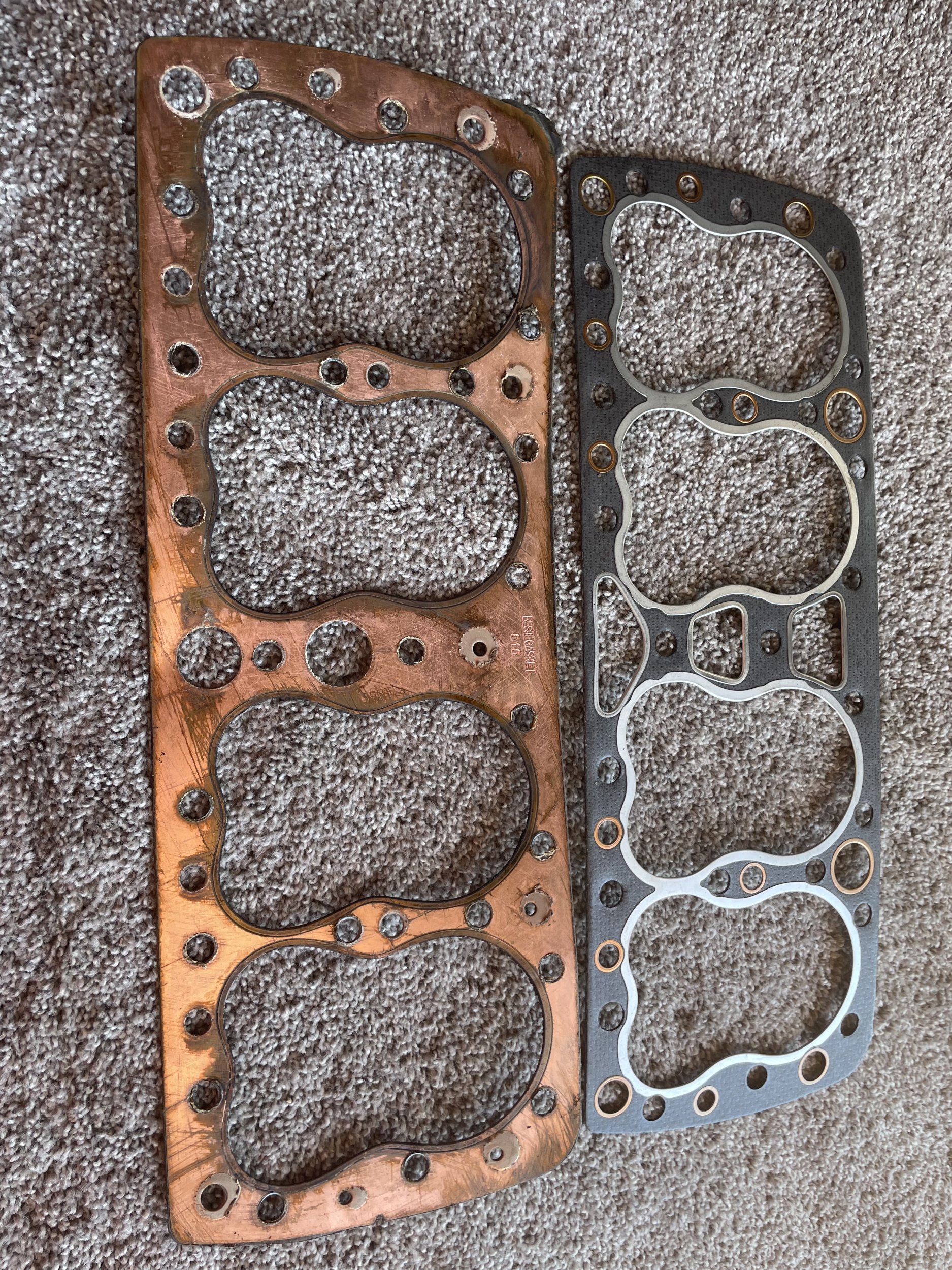

  5. mark hogan
    Joined: Jul 27, 2022
    Posts: 164
    mark hogan

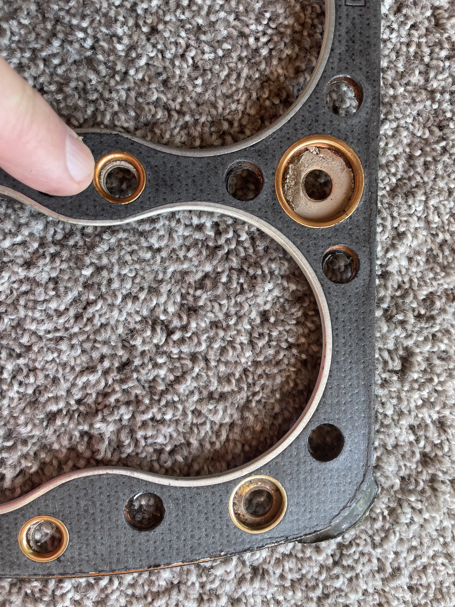

    Here’s some better photos so you’ll understand and understand flow restriction. I’ve got a twenty degree warmer running built motor. Thinking this could be the ticket. Look closely you can see the whitish rings around gasket reducing flow to block to head note reduced in these areas and not a hole creates hot spots.

    There was another thread about this a few months ago. Yes, absolutely you should open up the Best gaskets to the size of the holes on your heads. It is really odd why they did this. Someone on the thread even called Best and they didn't know why either.
    I used stones and thin carbide to open my gaskets up. Out of the box, it is certainly causing a restriction of water flow and allowing overheated water to remain in the block longer.

    Original gaskets have the correct sized holes. Original poster has a picture comparing the different between the two gaskets as well.
    I've also compared them. I needed big bore so I couldn't use OE copper gaskets.
    It's a known issue if you want to ensure your flathead cools properly. There is no reason to keep heated water in the block except to raise the coolant temp which is not needed on a flathead.
