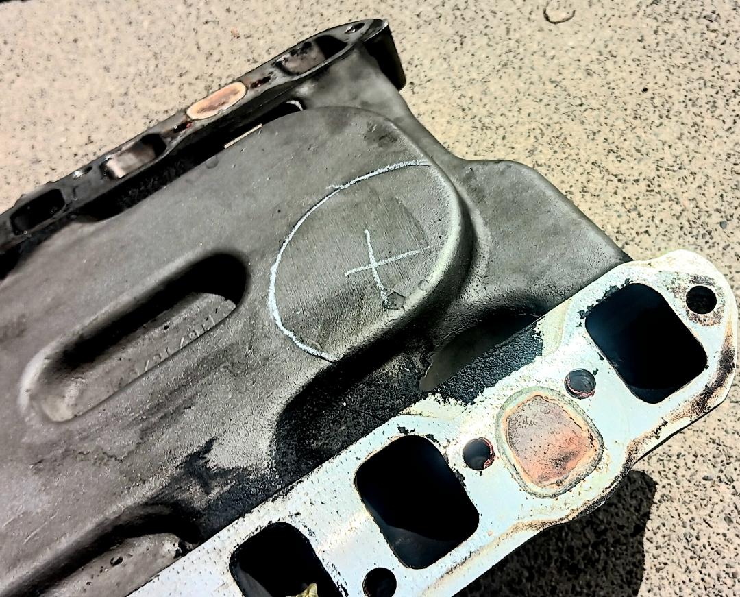

    I have searched this forum without much success. Chat on this subject has left me still asking "what about????" Since replacement of my flawed 3x2 intake is not possible, (no longer made) I need to discover a satisfactory repair. Welding on the sand cast aluminum is an option however, I worry about #1) difficulty of getting a suitable weld on the sand cast substrate and #2) warpage.
    My problem;...the wall between the intake chamber below the carburetor and the exhaust heat chamber on the manifold has developed a hole. I will need to cut away part of the bottom of the manifold to access the hole. Once I get there and clean everything up, I'm thinking, "why not High Temp Epoxy?" Googling that subject gets me "JB Weld EXTREME HEAT" good to 1000 degrees and "Blue Magic Metal Repair HIGH TEMP" good to 2400 degrees.
    Has anyone experienced a similar issue thumbnail (13).jpg and what was their solution?

  5. I’m ***uming the problem is to the right of the X,,,lower leg area of X ?
    Epoxy or welding,,,whichever you prefer .
    I had a sand hole come into a blower intake,,,,flaw from the casting process .
    Ground it,,,had a friend tig it,,,,,no problem !
    Just like Serv Pro,,,,,Like it never even happened !

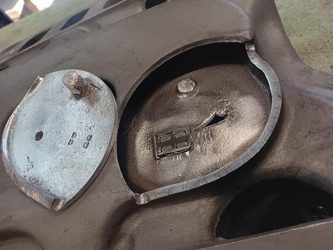

    Well boys,....I was able to avoid the High Temp Epoxy issue. A good friend, who has done other projects for me, said, "no problem". He's done similar repairs in the past. Yes,...extreme scrubbing and cleaning of the weld area is important. And, he warns that still with the cast aluminum and **** that comes to the surface, it won't be pretty!!! Not worried about appearance. The repair area will not be visible. He preheats the manifold in his back yard BBQ, carefully welds small areas, and does a cool down in the BBQ to finish.
    Y'all might enjoy seeing my journey even tho it doesn't include HIGH TEMP EPOXY! :rolleyes: thumbnail (17).jpg View attachment 6023834 thumbnail(25).jpg thumbnail(28).jpg
    Cutting away the floor of the preheat chamber revealed the suspected hole. Obviously it was a production flaw as the molten aluminum never completely filled the mold. This hole will be welded up as well as the part removed for access. All this not visible when the manifold is back in place.

    Got 'er done! A whole lot nicer than I could have anticipated. Good friend Mike popped it in the "barbie", laid down some pretty nice beads and returned it to the barbie for cool down.
    Thanks to all who offered advice and experiences, good and bad, with epoxy. thumbnail(29).jpg thumbnail(30).jpg thumbnail(32).jpg thumbnail(33).jpg

    Real nice! People get very weird when you mention welding aluminum, it's really no big deal. Much of the theatrical truss work and scenery we did was TIG aluminum. Your manifold is as good as new.
