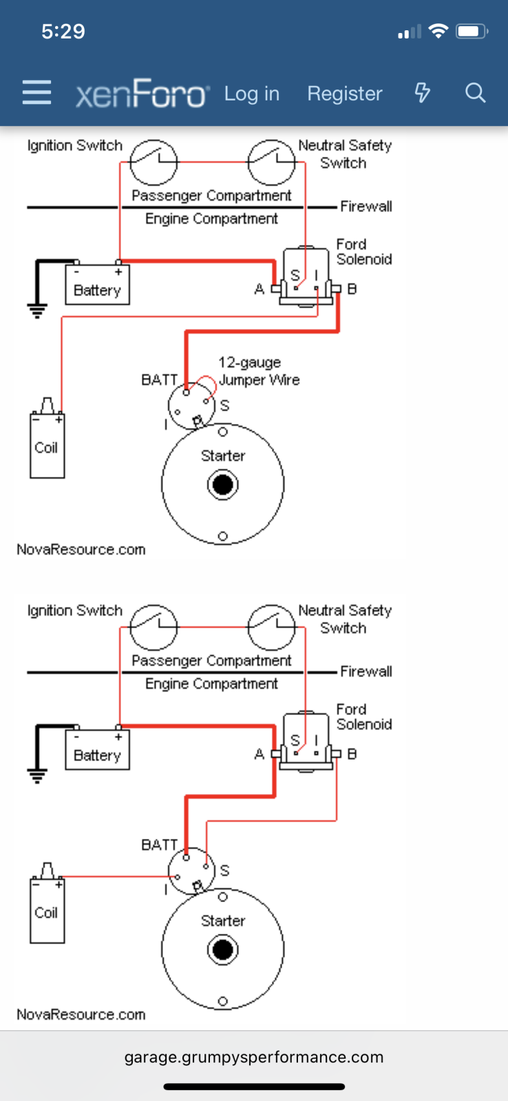

    If I understand, the solenoid (Ford) is not carrying the load to the starter, but just used as a remote supply tonthe GM starter?
  12. Johnny Gee
    Joined: Dec 3, 2009
    Posts: 14,611
    Johnny Gee
    from Downey, Ca
    So which one of the two pics caused issues? Then the other was the fix as I understand it. 47B01FD7-629B-49B4-BBCE-438AECD92F8E.png

    BamaMav
    from Berry, AL
    That's correct. The hot cable is hot all the time, the start wire is only hot when in the start mode of the Ford solenoid, that insures it gets full voltage. We used to do the same thing to VW dune buggies running headers, it helped with hot starts. It works on GM starters, too, if you are having problems with hot starts.
    Someone mentioned the I terminal, you can still use that to get full voltage to your coil on startup, too.

  17. Budget36
    Joined: Nov 29, 2014
    Posts: 15,452
    Budget36
    Pretty sure @BamaMav is referring to the bottom pic.
  18. BamaMav
    Joined: Jun 19, 2011
    Posts: 6,969
    BamaMav
    from Berry, AL
    Yep, bottom diagram is correct.
