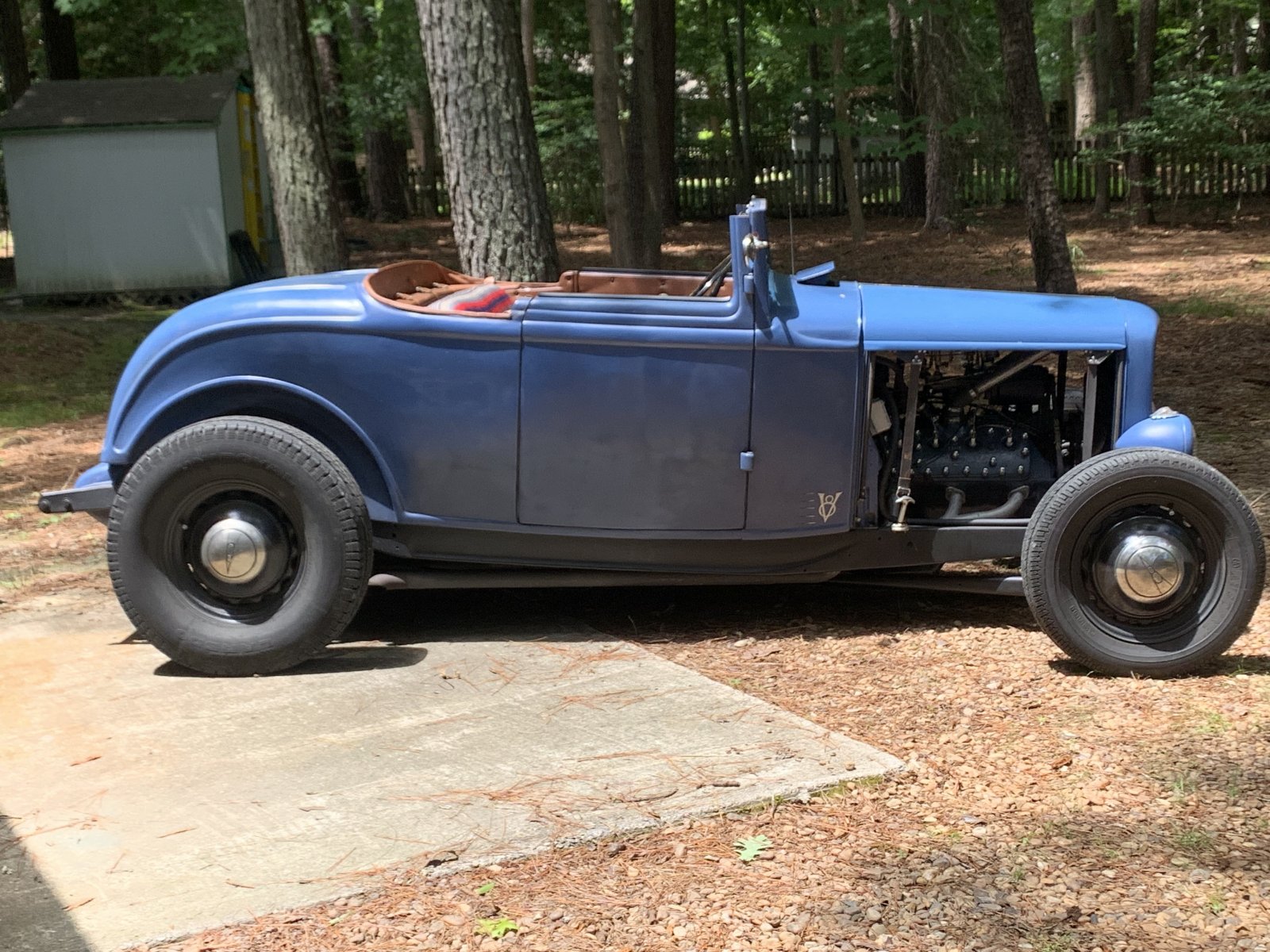

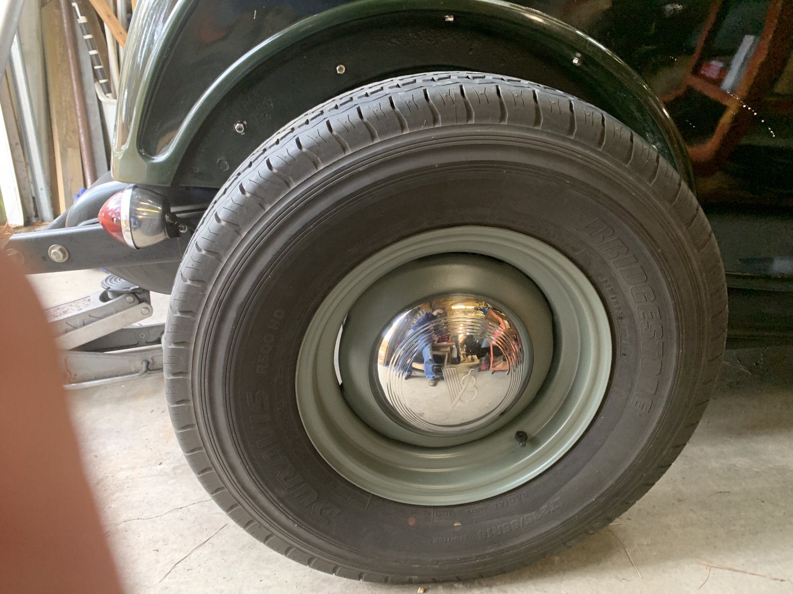

    43548856-3652-47BD-9095-5179E0E98433.jpeg 681B821D-23A7-4884-89B6-10B730D5899C.jpeg My avatar runs 235/85-R16s and are just a little bit under 31.5” tall inflated won 4.5” 40 Ford rims tubeless with a 46 banjo rear. My 32 5-window rinds the same tire on 16” Int Harvester rims which I believe are 5” wide again tubeless on a Canadian Maverick 9” rear (narrower than the 8” American counterpart). Found the avatar set used at Carlisle and the 5-window set from tire rack.com a Durvais tire I think it’s spelled …..

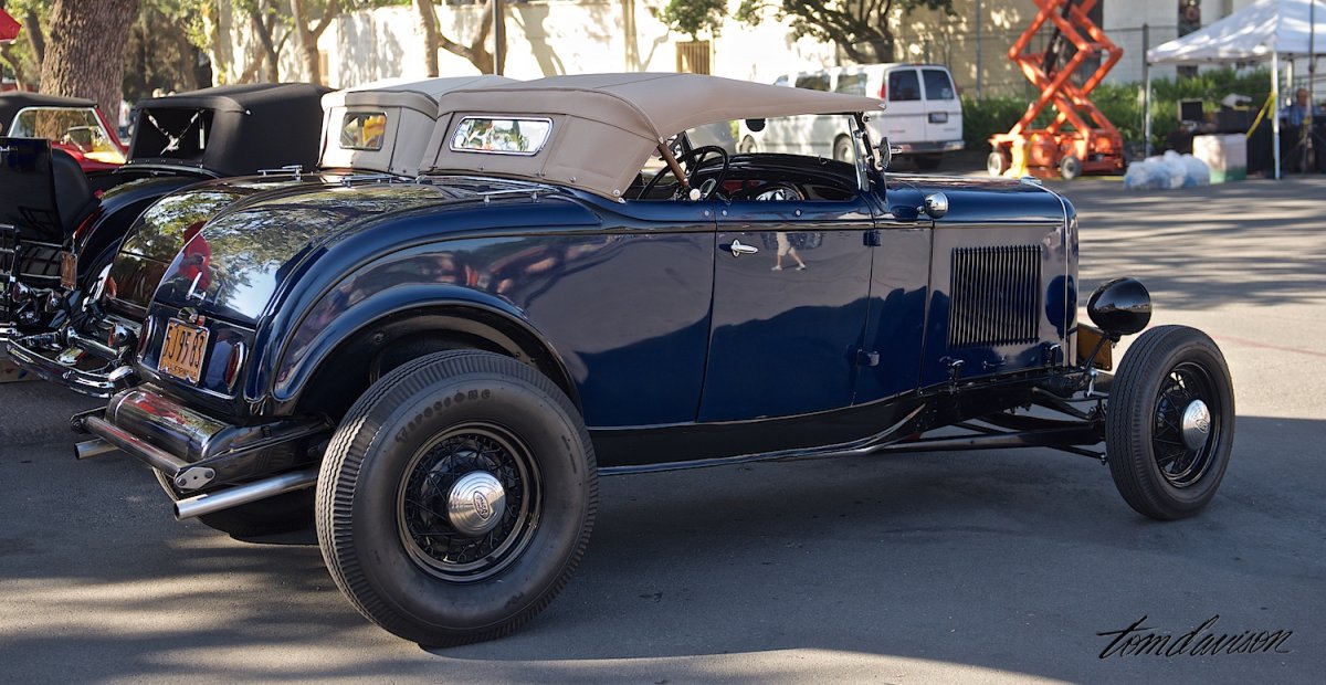

    I have to say that the blue Cabriolet that Tom T showed in his first photo says tons though. Perfectly centered in the opening with an even gap all the way around. No matter what size tire that is an absolute if you want it to look right. Tom T blue Cab.jpeg

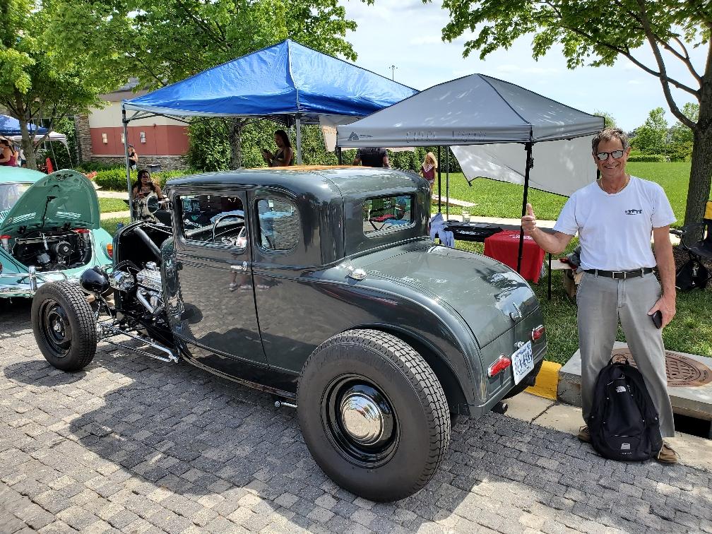

    I run 235 85 16's on all mine

  10. Haven't bought the tires yet. I have 40 Ford 16" rims with 6:00 X16 RO
    I have 40 Ford rims and 6:00 x 16 rollers presently, but am thinking 5:50 x 16's.
  11. This is the look I like. At the present time the rear (59 Ford with 68 3rd member) is not in, but that is next. I want to get it rolling around with the tires I will use. Got worried that some sizes are going away.

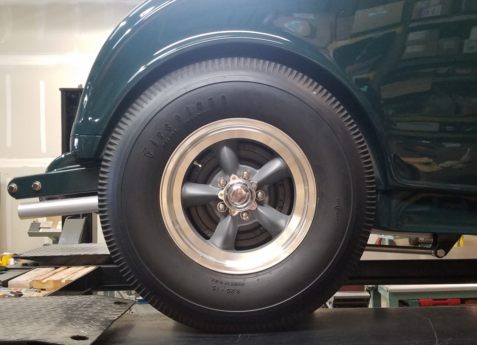

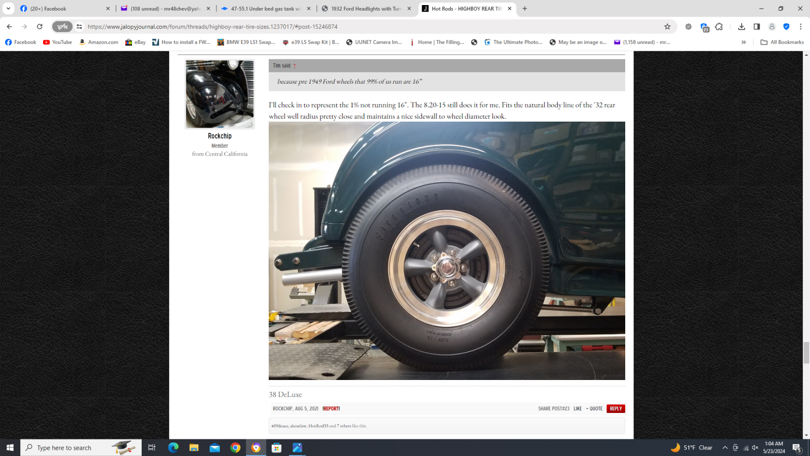

  23. Rockchip
    Joined: Jul 31, 2014
    Posts: 29
    Rockchip
    I'll check in to represent the 1% not running 16". The 8.20-15 still does it for me. Fits the natural body line of the '32 rear wheel well radius pretty close and maintains a nice sidewall to wheel diameter look.

  29. Mr48chev
    Joined: Dec 28, 2007
    Posts: 36,501
    Mr48chev
    That is what the whole thread was about rear tires that fit the rear wheel opening correctly.
    That 8:20 in post 23 should be the text book fit. the gap between the tire and the lip is as close to perfect as you can get
