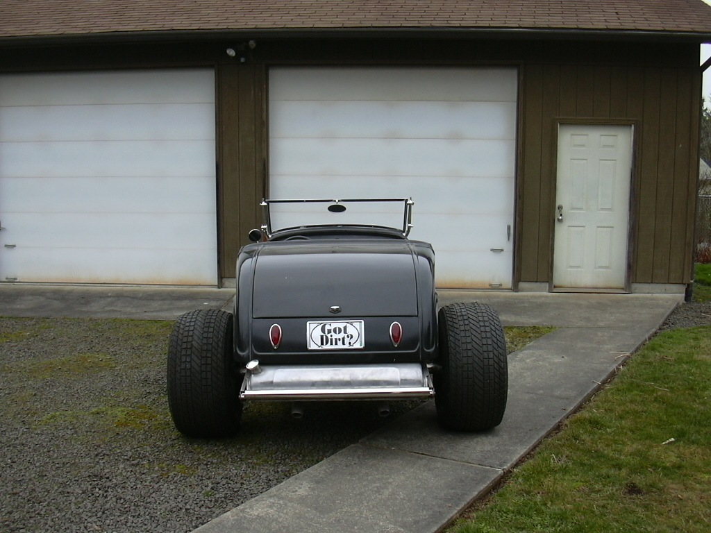

  4. DDDenny
    Posts: 23,425
    Affirmative
    Now, what's the backspace?

    6.5

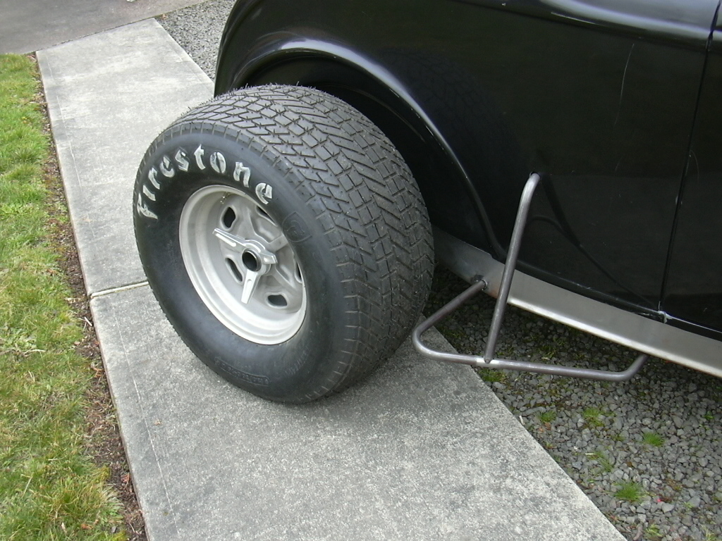

    any more pics showing the side wall....

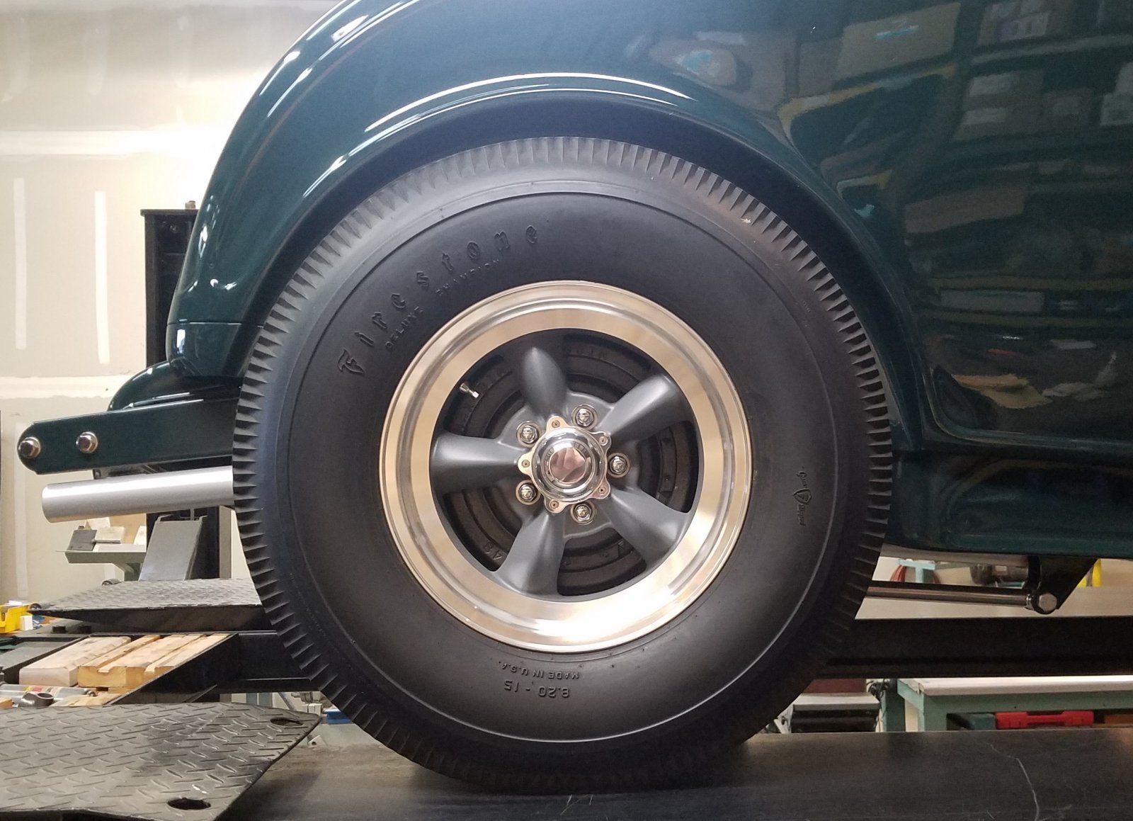

    thanks, those look good... I have some 10's and was wondering about the 14.00... oh and what was the back space?

    I run 8.20's also on my 15's

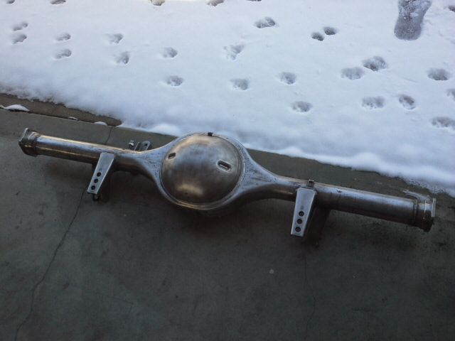

    I don't recall the exact backspace, it may be around 7 inches, they are a welded two-piece custom wheel, I spec'd them with a shallow front side to be able to tighten/loosen the knockoff tri-bar without scarring the wheel with the K.O. hammer.
    Believe it or not, the rearend housing hasn't been narrowed, I actually had to add about 2 inches to one side when the new ends were put on.

    any way.... what did the rear end end up @.. mounting to mounting surface..

    I bought the Firestones over twenty years ago, they are real dirt tires (2 ply), the series after the double diamond style repros that Coker makes.

    20 year old tires are for static display only

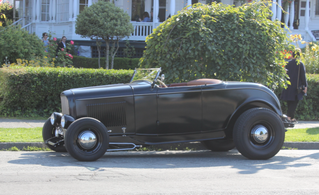

  24. Mr48chev
    Joined: Dec 28, 2007
    Posts: 36,506
    Mr48chev
    I can't tell what size tires they had but when the tire size looks right it just flat looks right as on both of these. Looking through my 2019 Deuce Days NW photos there are plenty that just don't look right being either too small of diameter or too large diameter . Screenshot (877).png Screenshot (894).png
