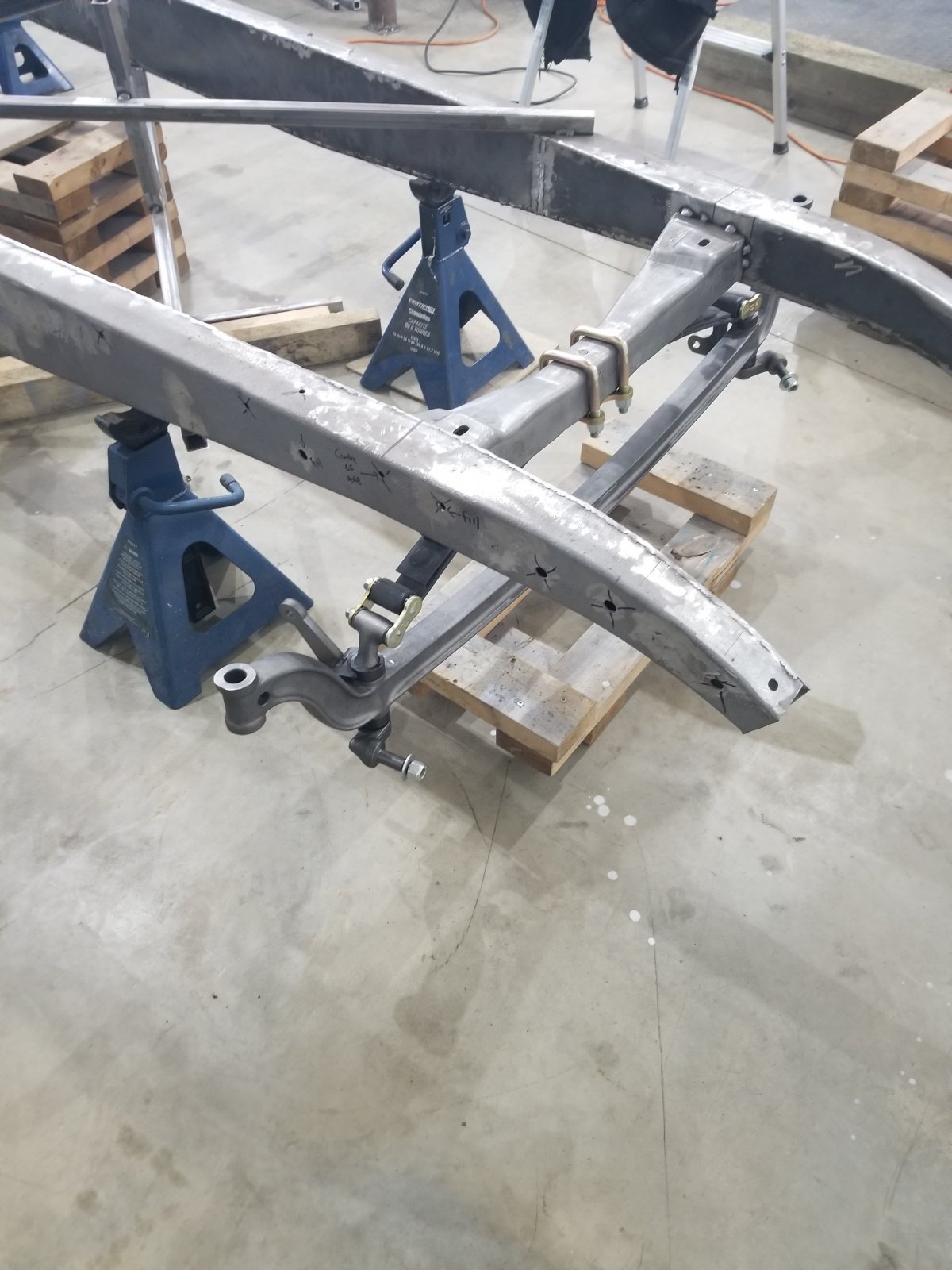

    Ok has anyone ever installed a block between the leaf spring and the crossmember to get a higher front stance? Pics? 20211019_173752.jpg

    Or you could use a stock eye spring .
    If you want to go higher use a stock ( non drop ) axle .

  7. If the picture you posted is yours you have a reversed eye spring which is 1” lower and a dropped axle which is 2” or so lower than stock. Go back to stock style stuff and you will raise it 3”? Not what you asked but same result?

    Did it make a big difference in handling? Im only thinking of maybe an 1" block, or maybe putting an extra leaf in. I mounted my crossmember lower between the frame rails so that gave me a cpl extra inches in height

    Yes , a stock Ford spring has the eye rolled the other way .
    The photo is not a Ford spring , but it shows what I'm saying .

    Right on. Ill just head to my spring shop and get them to make one up for me.

    You have no weight to see ride height but if what you see now is where you want it adding a spring with an original eye and perhaps a spacer might achieve your preferred ride height...it's truly a juggling act...a frame notch is another option...and of course the other details mentioned...
    I have seen Builders clamp down and load the suspension to ride height based on experience to verify it meets the correct desired height and look..

    Exactly! It might seem captain obvious, but when seeking a higher stance, don't use a dropped axle.

    Perhaps the happy medium will require the dropped axle...
    With my limited knowledge of the big picture the shackles will be at a 45° angle when at proper ride height...others will confirm...

    Yup i hear ya. Its been fun building this roadster. Ya i dont want much more height but i do want a bit more height knowing that it will drop once the weight is on. I plan on setting it now then loading a bunch of weight on it to see how far it drops.. thanks for the input

    I’d re-arch the main leaf to save some $$$ on buying another spring …. But I’m cheap. It’s not rocket science.

    You're way ahead of yourself. You may go to all the labor and expense of reversing that main leaf to find the car now sits an inch too high when you're through final ***embly.
    Get all the weight on the car ( body, engine, radiator, etc) for your final mock ***embly, then fine tune it an inch or two-IF you even need to.
    When you blow it all apart for paint, you can then send out for spring work, etc prior to final ***embly.
