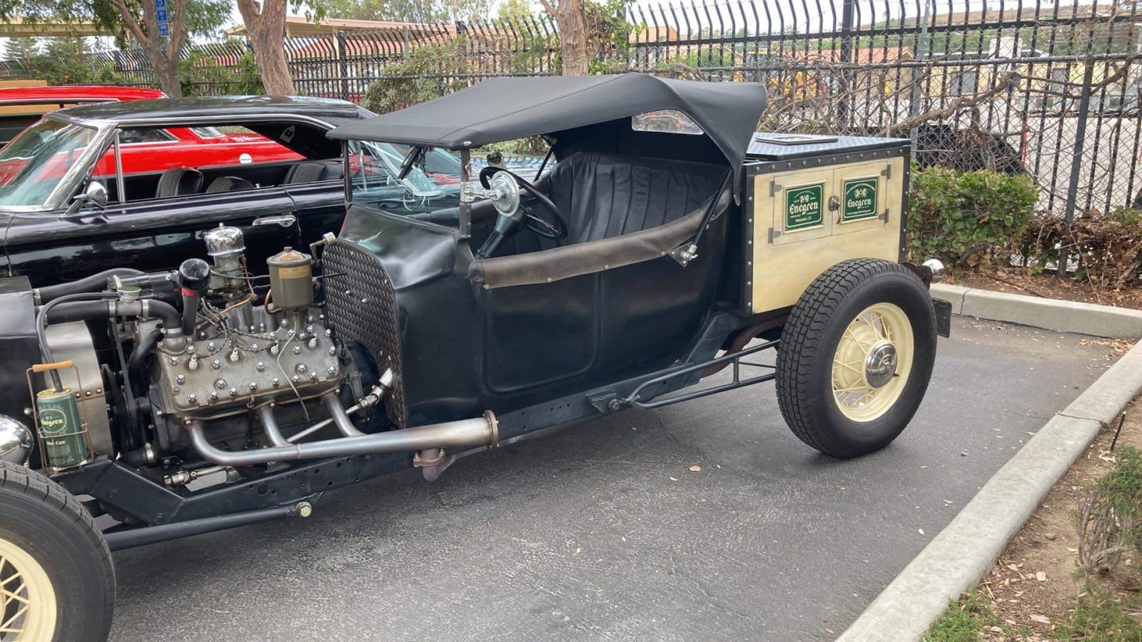

    It’s all about matching the torque output of the engine, weight of the car and then intended use. Our 8BA with overdrive happens to LOVE a 3.00:1 geared differential. With the 30” tall tires the flathead cruises on the open road at 65-70 mph all day long getting pretty fair gas mileage. Because first gear is pretty low it accelerates from a stop without problems. 75B969CA-E352-45FD-8512-84A92E80CA39.jpeg
