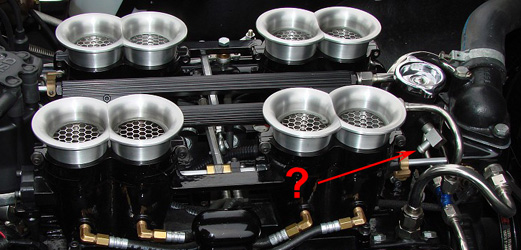

    depends on what type of mechanical injectors yer talking about; CIS systems are completely tuneable with aux air controls and control pressure regulators
  17. budd
    Joined: Oct 31, 2006
    Posts: 3,477
    budd
    what are the outside lines for, just looks?
  18. RugBlaster
    Joined: Nov 12, 2006
    Posts: 563
    RugBlaster
    you can see the fuel rails on the inside of the stacks
  19. panic
    Joined: Jan 3, 2004
    Posts: 1,450
    panic
    Right, the CIS Hilborn, silly me.
    Have a nice day.
  20. panic
    Joined: Jan 3, 2004
    Posts: 1,450
    panic
    Yes, that proves how streetable Hilborn is.
    Look how sparkly those little art-deco screen inserts are, almost like they've never been outside...
    They must get washed frequently from that overflow fitting that ends in mid-air.
    Yah, that car must see a lot of miles - what is it, like 50 feet onto the trailer?

    The fuel logs look like ****, as does that late model MSD cap. Not a very good example. The EFI conversion on the Hollywood Hot Rods '32 has very noticeable spacers that really kill the look. You might want to consider a Weber setup from Inglese, which is now owned by Comp Cams.
