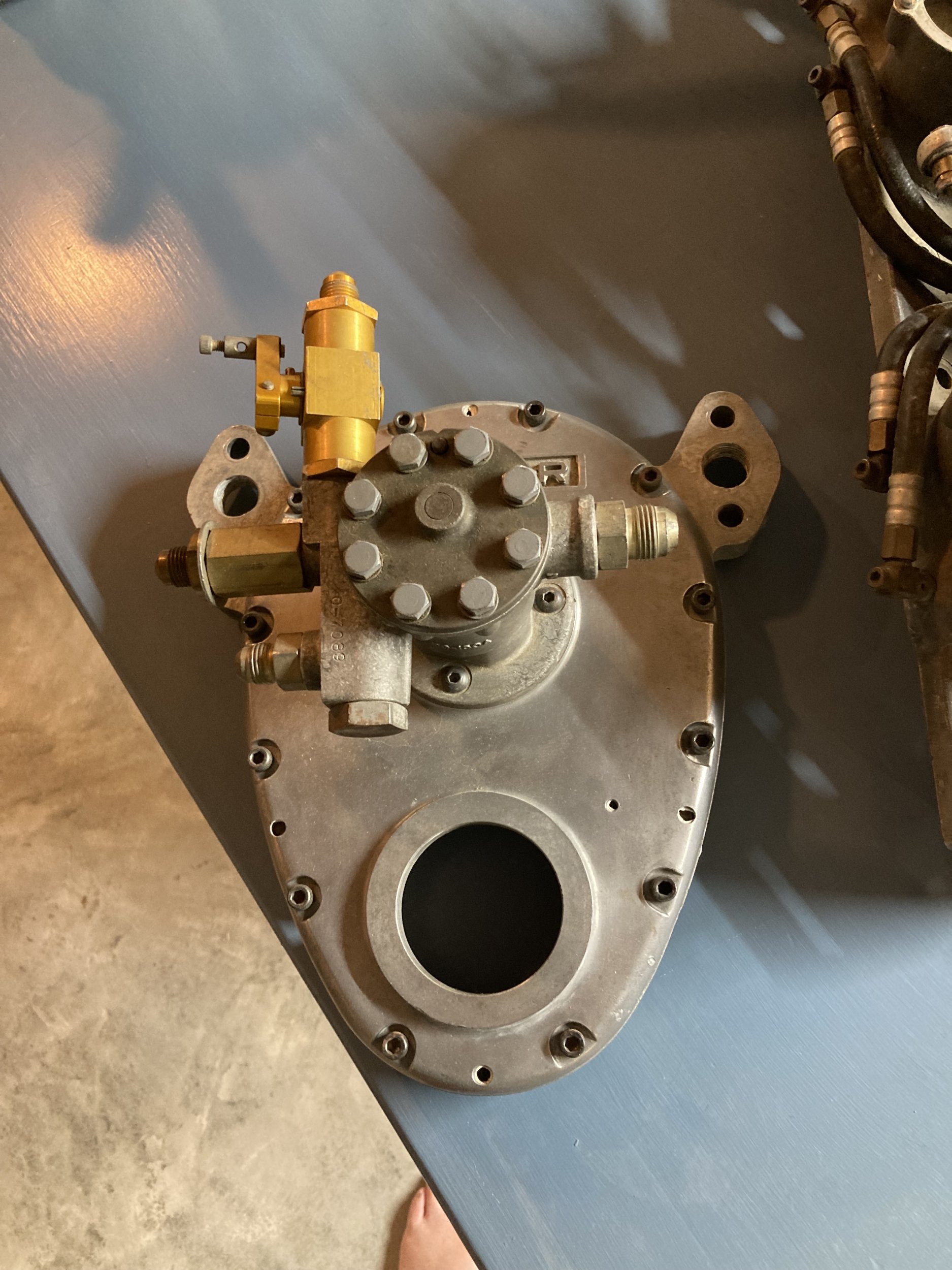

    any one have information on where mechanical cam mount hilborn fuel pump rebuild kits might be found for sale all places i try say they are unavailable the only numbers on the pump are 1/2 - 760 stamped on the flange

    @big john d
    Witch companies &
    What parts needing .
    A picture off
    Seal, bushings ,Orings
    Look into MSC & other industrial

    This is a cam drive front cover with a Hilborn PG150 pump. The only part that is not showing is the drive spud that bolts onto the front of the cam with the same bolts that hold the cam gear on. The only seal beside the crank-harmonic damper seal, which is a standard Chevy part, is the seal on the back side of the pump. And it is available from Kinsler and others still.
