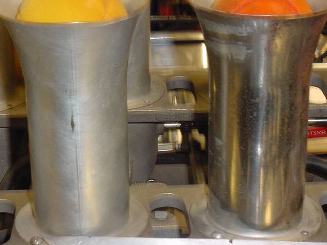

    Anyone KNOW what the "plating" is on the stacks?? It definitely ain't
    chrome (not on this set) and almost looks like they're ALUMINUM.
    Does anyone know what Hilborn plated these with ?? (They are definitely STEEL stacks)
    The appearance has grown on me - so I'd like to have them redone, but I don't know what to ask for.
    TIA

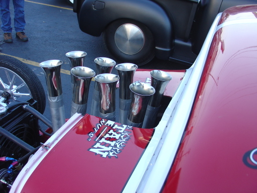

    [​IMG]My (new) ones are nickel plated, so is the manifolds. That picture looks like some of them might be aluminum

    Yeah they "look" aluminum. Actually the two on the right that look different are the two that someone (not me) tried to buff - they buffed right thru the plating makign them look like total crap.
    Origionally I planned on having them chromed, but now I am actually liking the "aluminum" look.
    I wondered about nickle - but I thought that had a more "shiney" appearance. These have a certain "dull" look - that almost looks like aluminum spray paint (not really, but sorta).
    I can give Hilborn a jingle and I may, but I figured the HAMB would have some good information - true to form - you guys certianly have.
    THANKS - for the comments.
    BTW - they ARE steel (magnet test). They WERE a matched set - a dufus has since fixed that. I think restoring them to their former glory - is my goal!

    Any pics?? I realize it's kinda hard to photo this stuff. To describe what I think I have - it's VERY similar to what a set of Stainless Steel SATIN MICROMETERS look like.
    I tried another shot at a pic. You can see on the BRIGHTER one (the screwed up one) where the plating is buffed off. If you look real close there apppears to be yet another plating underneath. Not sure if that helps identify the origional process or not.
