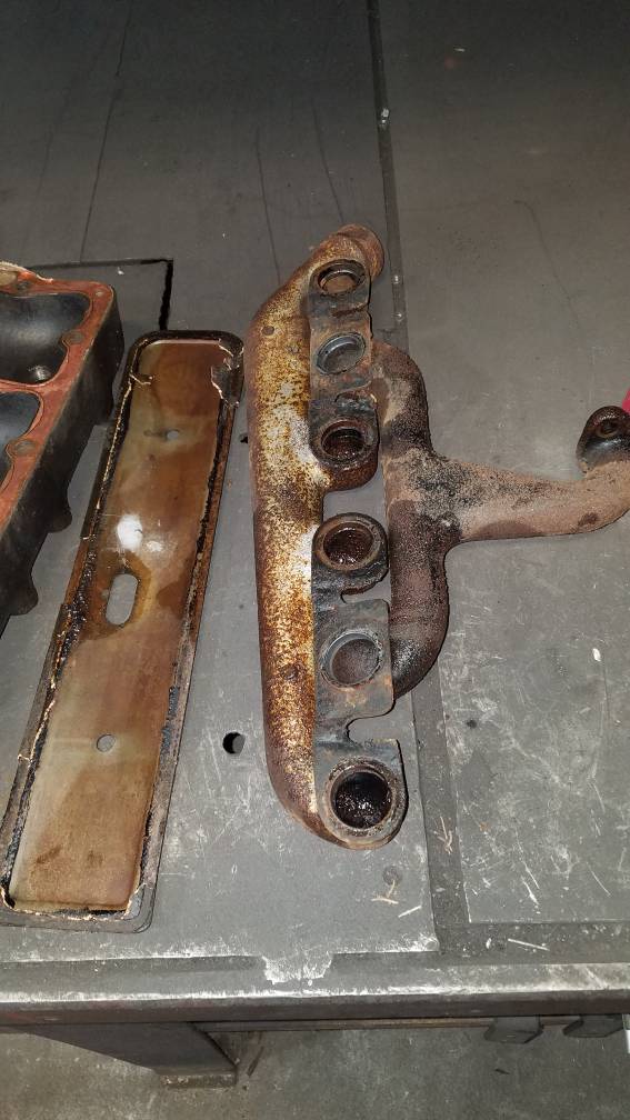

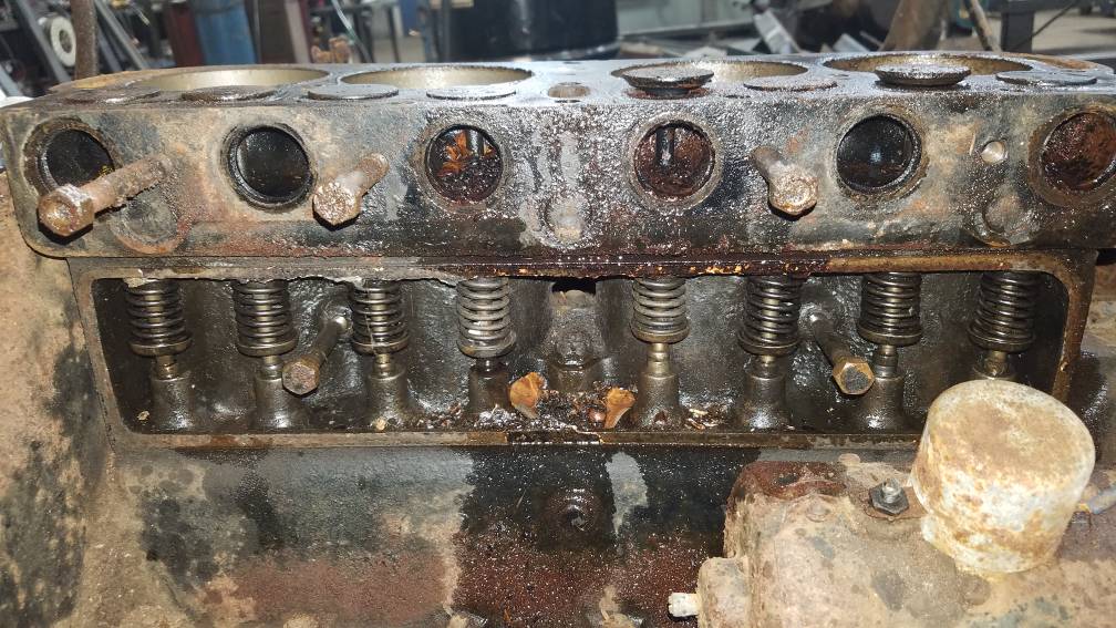

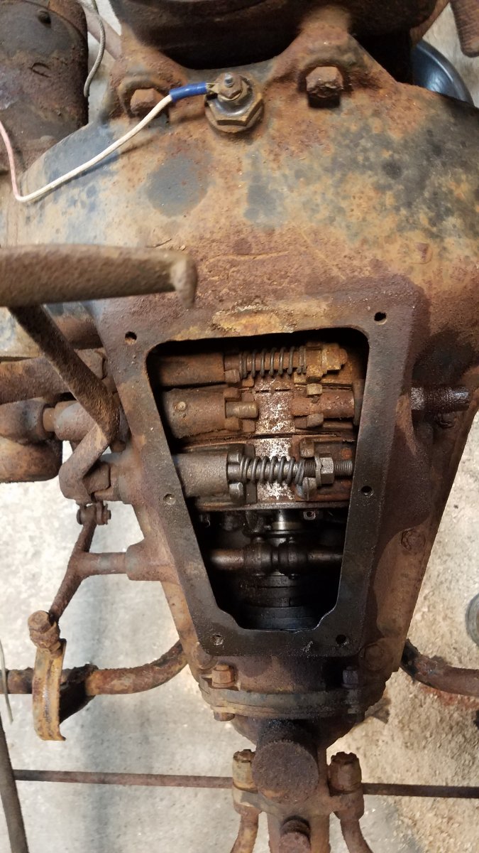

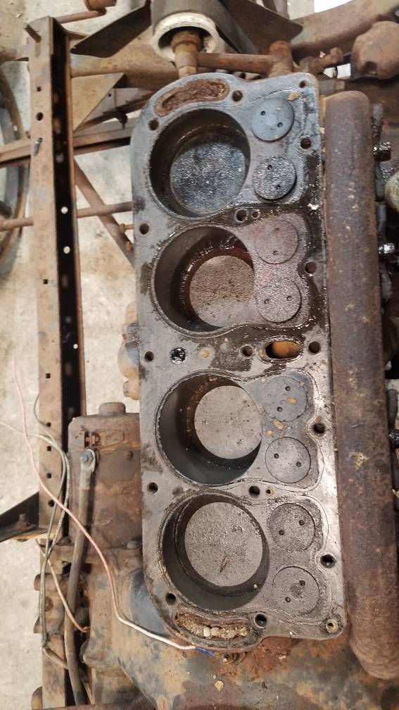

    Engines still stuck. I popped the trans cover off, shes a bit dry....
    kidcampbell71 and Okie Pete like this.
  2. guitarguy
    Joined: May 26, 2008
    Posts: 650
    guitarguy
    Not great for sure, but by far not even close to the worst I've seen. I wonder what the cylinders look like though...pop the head off.......
  3. hillbilly4008
    Joined: Feb 13, 2009
    Posts: 3,237
    hillbilly4008
    The head is coming off Saturday. I want my kids to be there

    The37Kid

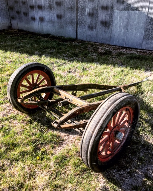

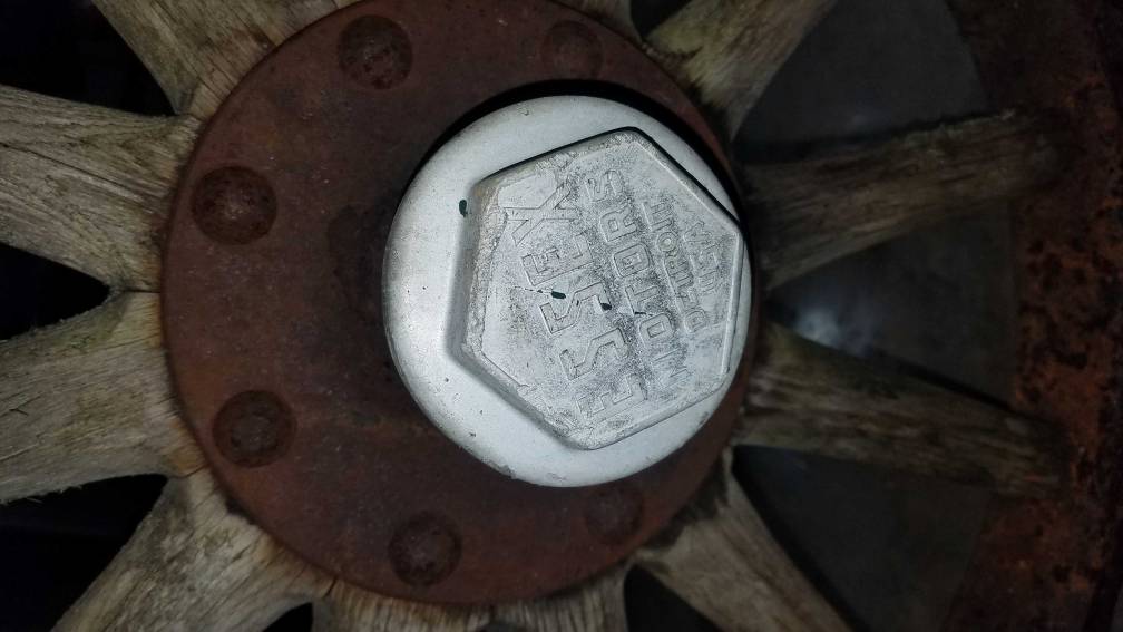

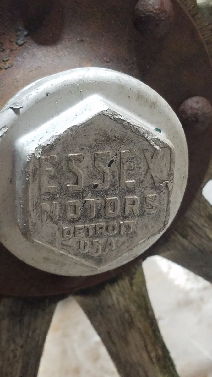

    This came up locally, to cheap to walk away from.
    Sent from my SAMSUNG-SM-G891A using The H.A.M.B. mobile app
  10. guitarguy
    Posts: 650
    guitarguy
    I like the direction your taking!
    kidcampbell71 and chryslerfan55 like this.
  11. HECK ya!... do you have the frame horns from the Es***, or are you going to have to make them?

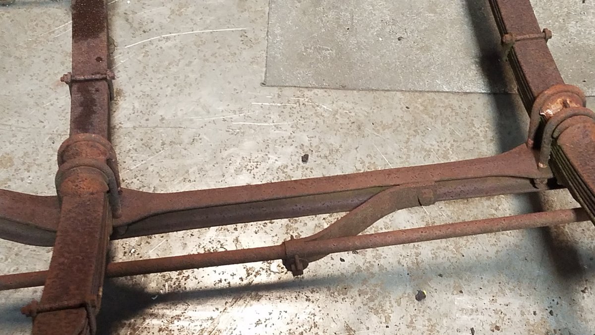

    I gotta make them. I've already got that figured out.

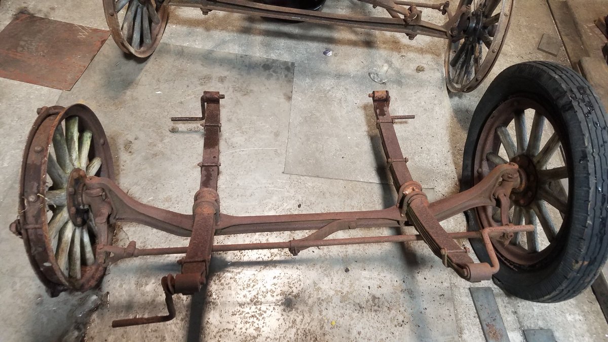

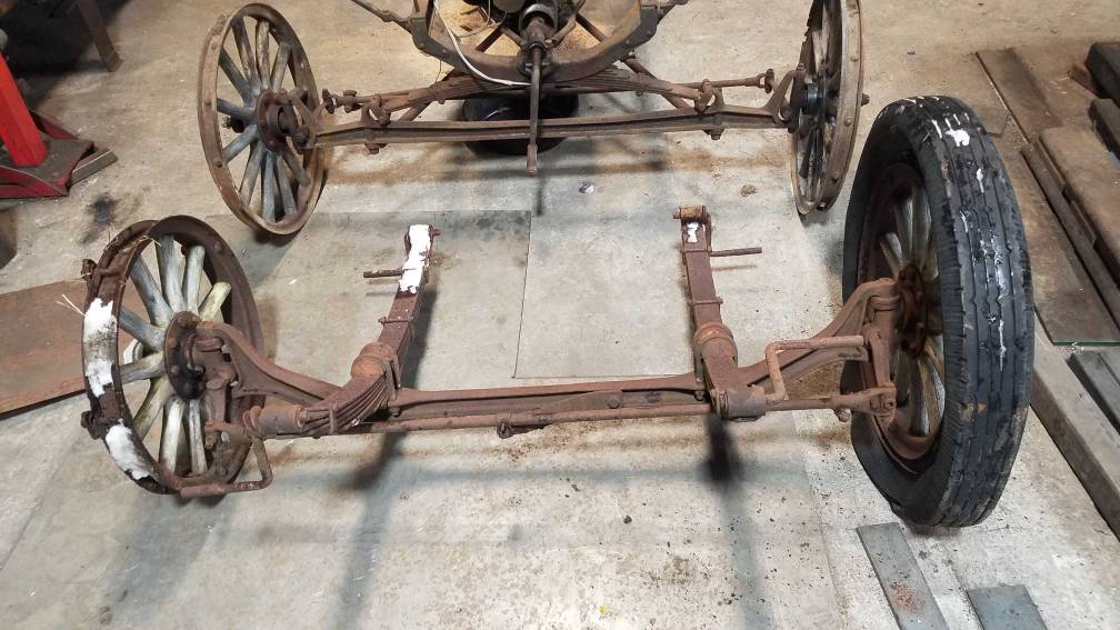

    This axle looks like it was converted to trailer use. Seems like an easy return to service.
  13. The37Kid
    Joined: Apr 30, 2004
    Posts: 32,925
    The37Kid

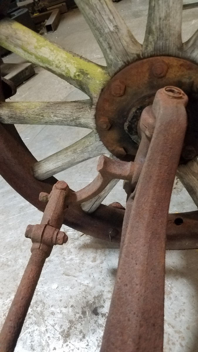

    Is the Es*** axle sitting backwards? Is the tie rod in front or back? Bob
    kidcampbell71 likes this.
  14. hillbilly4008
    Posts: 3,237
    hillbilly4008
    15762523872303391248412345184747.jpg Your asking the wrong person Bob. But just by looking at it (not knowing the factory steering setup) id guess it is oriented the right way.
    The arm was cut off the spindle on the right side. So ***uming it's traditional cross steering its facing the right way.
    This thing has me puzzled. It's either a factory "guide" with a nail through it. Or some sort of kit. The flat bar mounts to the axle with a bolt that is tapped into the I-beam
  15. hillbilly4008
    Posts: 3,237
    hillbilly4008

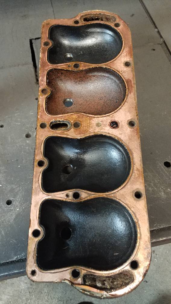

    Finally! It actually all looks pretty good. The pictures dont do it justice. Obviously it needs a good cleaning, but from what I'm seeing the parts all look proper. Accept for maybe a valve or 2 20191214_161230.jpeg 20191214_161241.jpeg 20191214_162941.jpeg 20191214_163311.jpeg

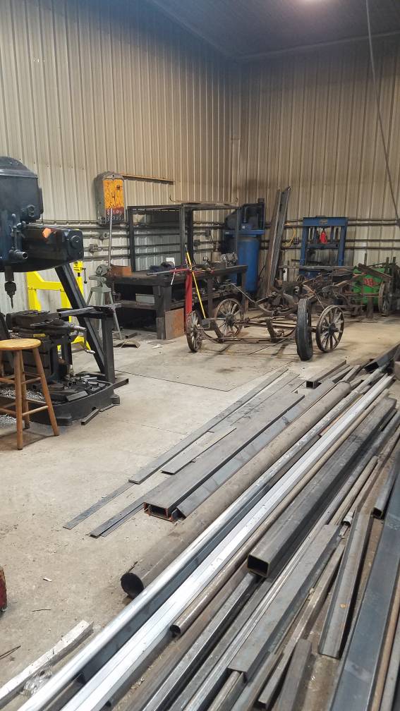

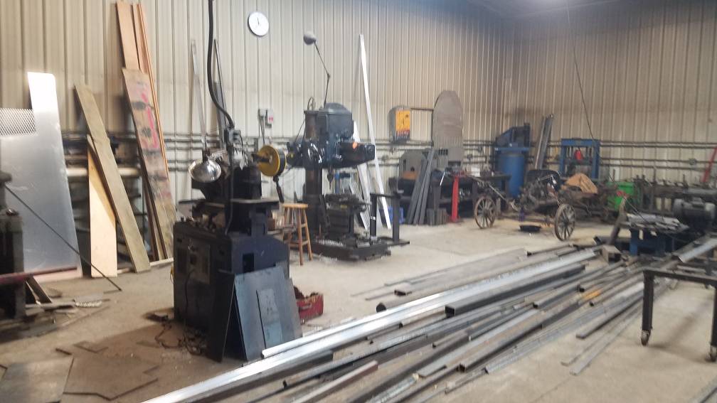

    While the boy was unbolting the head i did some rearranging and cleanup. Trying to regain my shop hobby space. 20191211_113644.jpeg 20191214_163854.jpeg
  20. The37Kid
    Posts: 32,925
    The37Kid
    ^^^^^^ Looks like that three spring conversion won't be a problem. Bob
  21. Lil'Alb
    Joined: Sep 22, 2013
    Posts: 263
    Lil'Alb
    from brier, wa
    Nice, that axle has a healthy drop, it can be mounted on top of the springs, and the springs shackles can be mounted outboard of the frame rails and you'll really be down in the weeds.

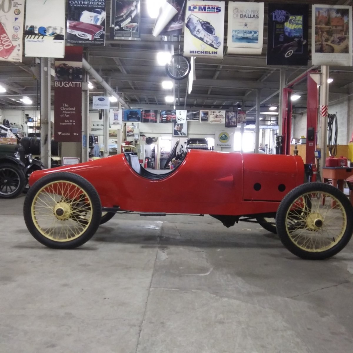

    Congratulations on what will be an exciting project. I have been in the old car world since I was 18 and I can tell you there is ABSOLUTELY NOTHING more fun than a Model T speedster!! Welcome to our club!

    Wow. Engine does look good. I bet you the rings just got a hold of the cylinder walls making it stick. Probably a couple of taps with a wood block and a big hammer might be all it needs to break it loose.
    Also of note, those are original two piece valves. Your a long bit off I ***ume and you mentioned replacement anyhow. They would be best replaced by newer one piece ones, as they do have a small history of the heads separating from the stems.
    There are many ways to go about that. There are stock replacements available, as well as being able to use SB Chevy exhaust valves with adjustable lifters...or you can use 351W exhaust valves, Ford 9N retainers and stock springs...and those have to have the ends ground for your valve lash, same as stock would.

    Update: i can get the engine to rotate backwards a bit by hammering down on the center 2 cylinders. Then when i try the hand crank again it just gets stuck in the same spot
  26. Blues4U
    Joined: Oct 1, 2015
    Posts: 8,221
    Blues4U
    from So Cal
    Looks like rust in #2 Cylinder.

  29. I have one of those axles still attached to a frame (sorta) if you need pics or measurements.
