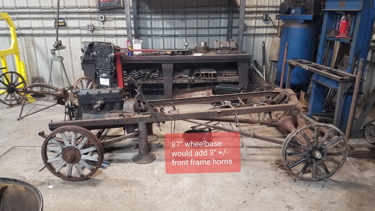

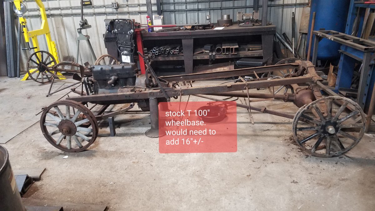

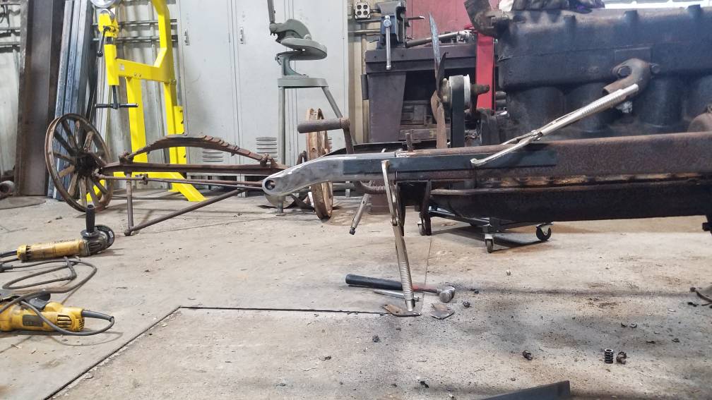

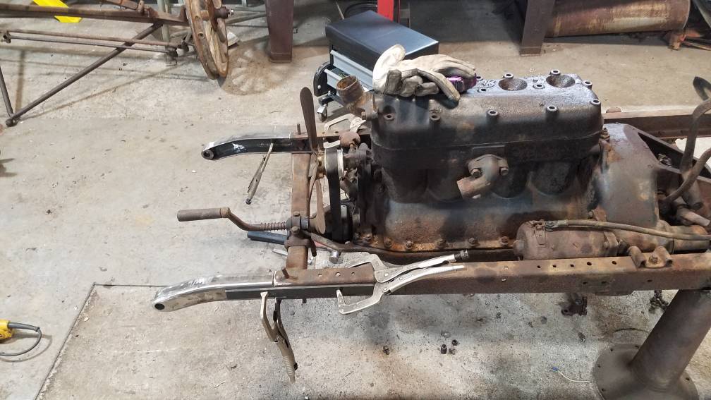

    Some quick measurements. If i wanted to keep the stock Model T wheel base and run the Es*** axle i would need to extend the front frame horns 16" +/-
    I don't know how i feel about that. Having the frame stick way out in front on the grill like that.
    I may shorten the wheel base a bit by moving the front axle back 6 inches or so. The bottom of the engine is nice and flat, clearance shouldn't be a problem.
    Thoughts?

    I removed the T ***embly and mocked up the Es*** ***embly. Wicked drop, i dont see myself flipping the springs under the axle in the future.
    Now i need to focus on wheelbase. In stock T form it was 100". However, to keep it there i would need to lengthen my frame 16 or so inches. Which in my opinion would look stupid as hell.
    To make it look right i want to tuck the axle back underneath the engine a bit. By doing so i would have to compete with the rear shackle mount location and the trans crossmember location. Not a big deal, but that affects the wheelbase by roughly 5 inches. And also affects how long i need to have my frame horns...

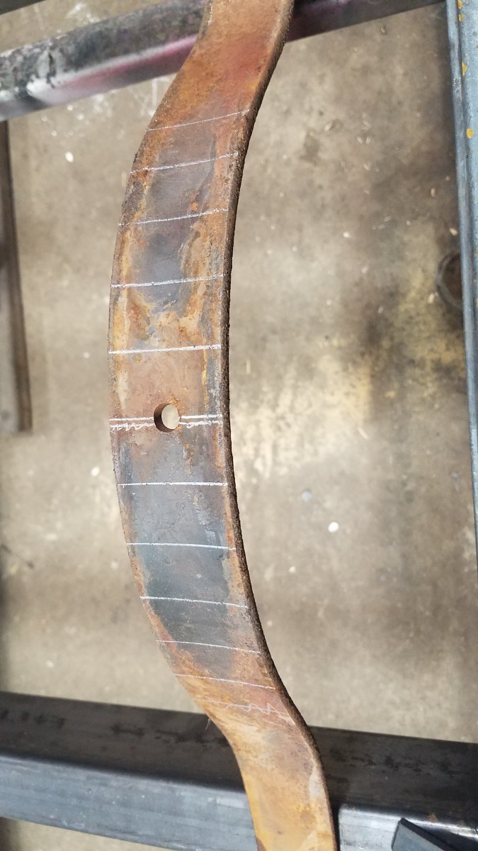

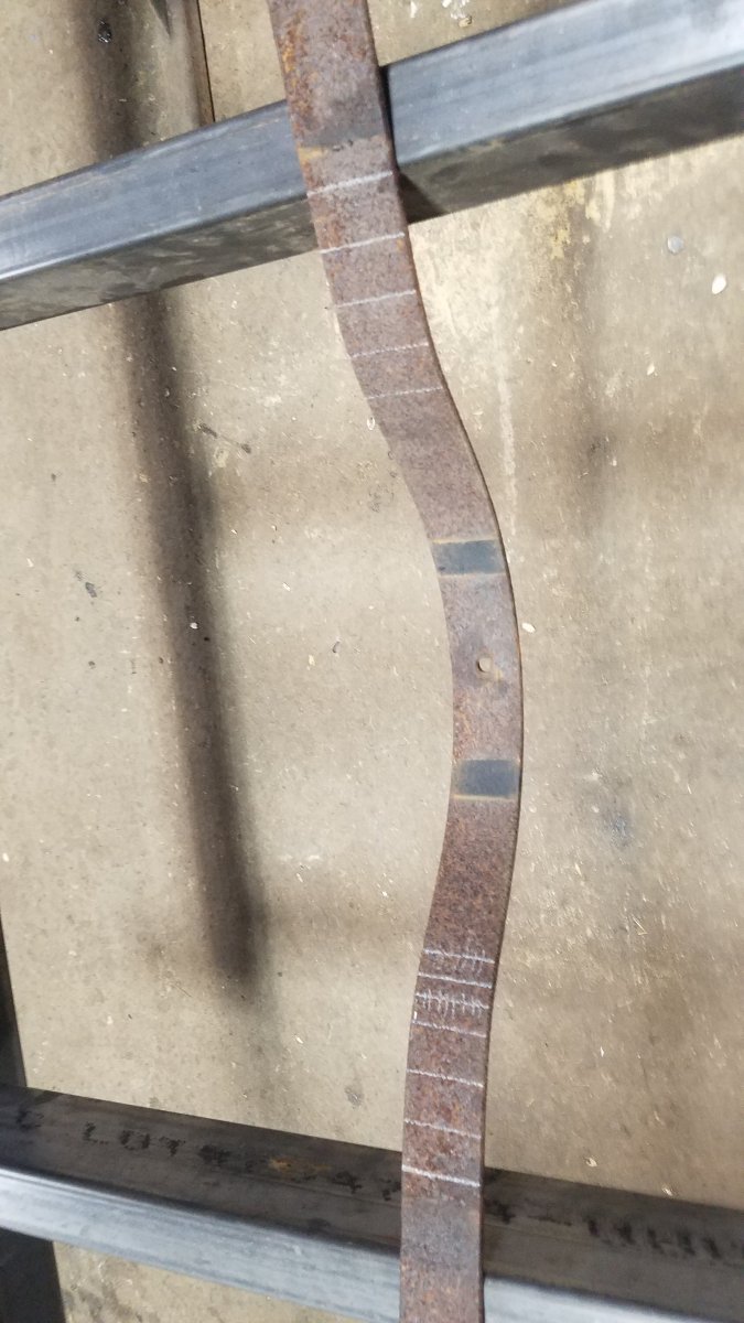

    For the rear i plan to reverse the spring eye, remove a leaf or two, and bend the main. That should net 4"-5" of drop, and i wont have to mess with the frame.

    I wouldn't move the front axle back. keep it in the stock location or mover it forward just slightly. Move the rear axle forward to shorten the wheel base, you'll have a better looking / balanced car . sprint car 2 - 16 - 14 005.jpg
  10. rwrj
    Joined: Jan 30, 2009
    Posts: 878
    rwrj
    from SW Ga
    I agree with Mr. Eastwood, for what my opinion is worth. Could you take advantage of shortening the rear to Z it, as well? That might be the easiest way to match the drop you have in the front.

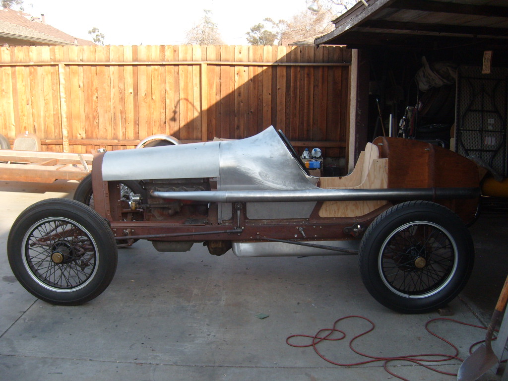

    Pete i posted this same query on FB and you responded. Your running an Es*** frame with T rear crossmember correct?
    Could you post a pic of the front of your car? Perhaps another pic from above?
    kidcampbell71 likes this.
  12. Pete Eastwood
    Joined: Jul 27, 2011
    Posts: 1,327
    Pete Eastwood
    from california
    I don't know how to do a thread search. . . . Check out my thread " Late 1920's Sprint Car " here on the hamb lots of build pics

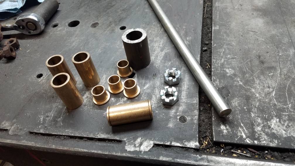

    This is where **** gets expensive. $70 at the local hardware store for just the bronze bushings and the castle nuts...
    Luckily I have a chunk of 5/8 stainless rod left over from another job. And material for the frame bushings.
    Im on the hunt for a pair of Model A frame horns to mount the springer on. 20200108_163842.jpeg

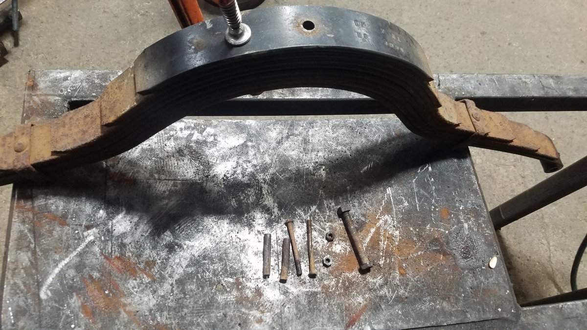

    So I did a thing today...
    Surprisingly for being 99 years old everything came apart with very little persuasion.
    20200110_132552.jpg 20200110_135406.jpg 20200110_133225.jpg 20200110_133730.jpg
    ...and right about here is when everything went FUBAR

  15. Nuts!... you could always go quarter elliptic :p
    hillbilly4008 likes this.

    Mock up that Es*** axle using T Front Springs, think an addition of 12 inches or so to the front may be needed. Bob

    Bob, your right on that 12" +/-. I can't really do an effective mockup till i have those frame bits. I really dont want to make them, i could but don't want to. I would rather use the Ford parts, i think it will just look more genuine in the end. If that makes sense to anyone...

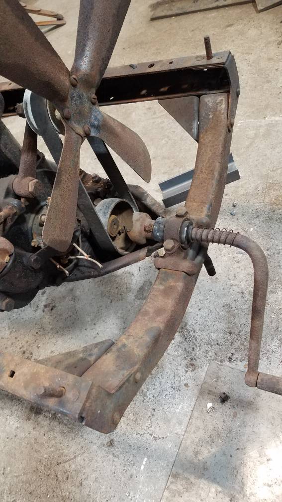

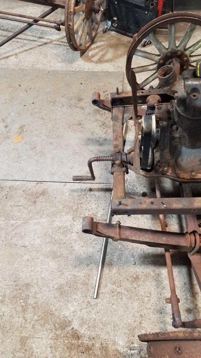

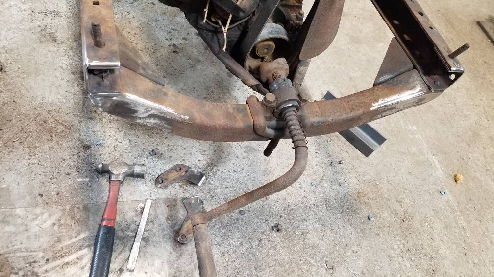

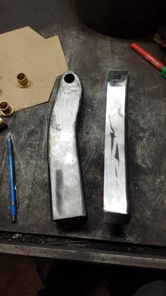

    I've decided I'm sick of waiting to find the model A frame horns. I'd have to modify them a bunch anyways. I started carving these out today. If all goes well i will have then tacked on tomorrow.
    This pushes the axle back to about a 96" wheel base. Just far back enough so the hand crank clears the axle, but also far enough ahead so the hand crank will clear the rod that will mount the springs to the frame.

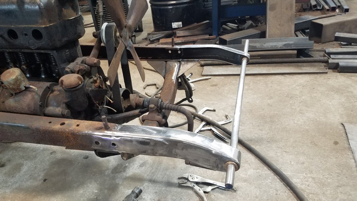

    Progress.
    Hoping to have the front all mocked together later on today. Then onto shackle mounts... 20200123_130430.jpeg 20200123_130938.jpeg 20200123_131718.jpeg 20200123_132306.jpeg 20200123_132316.jpeg
