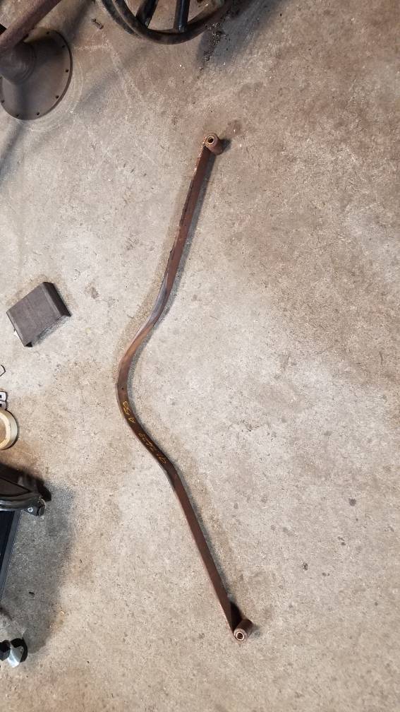

    20200123_164841.jpg They have to be truck springs. I didn't realize how heavy they were to till i took them off haha.

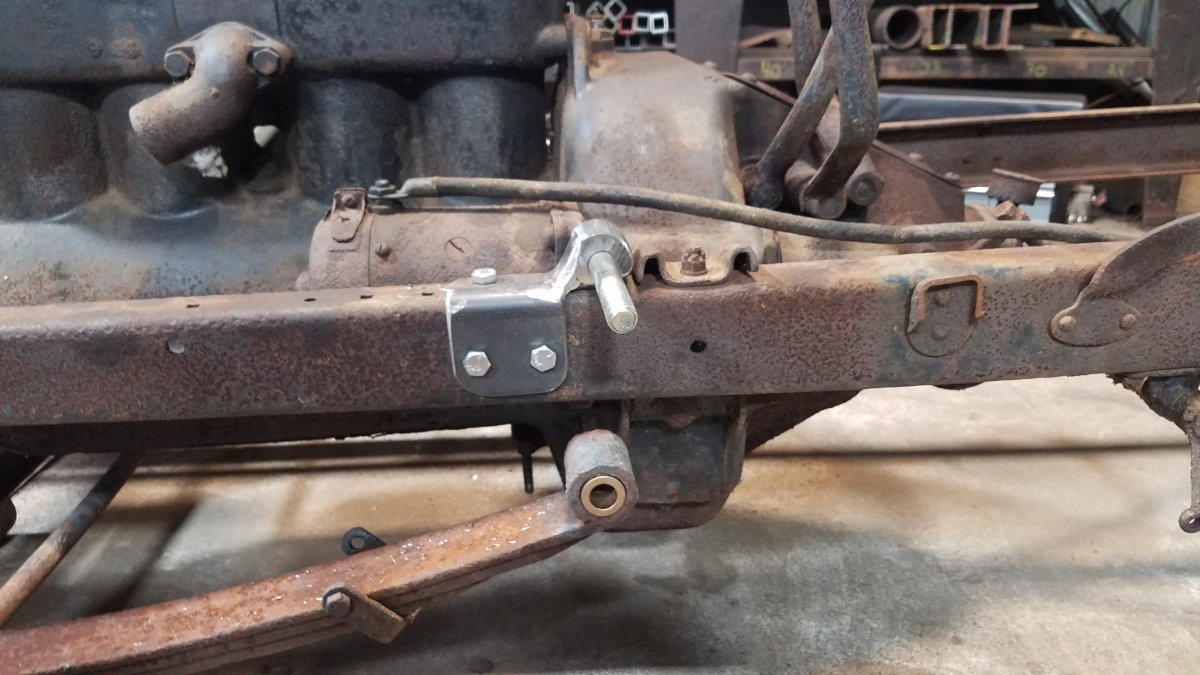

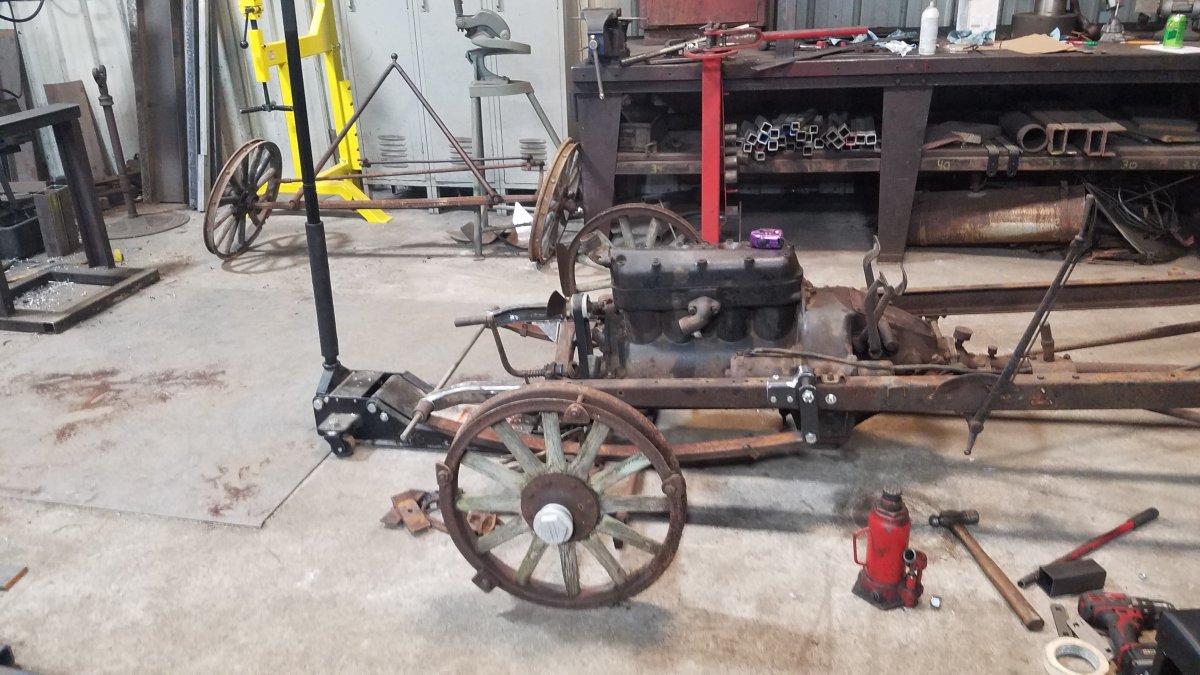

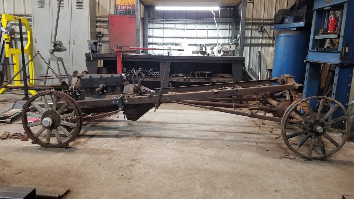

    Gotta mess with the spring packs a bit. But its back on the ground at least.

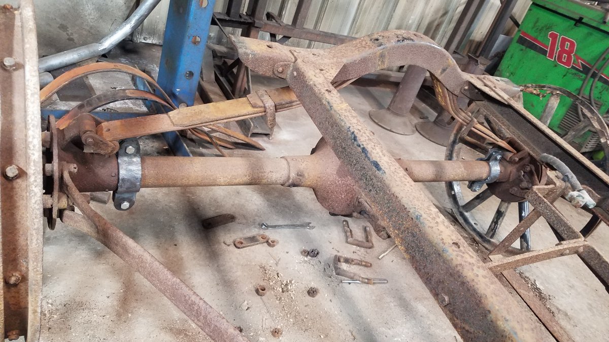

    Check out this hot rod stance!
    The rear has to drop 8" to be level. I refuse to make an 8" Z on the frame. Im thinking 3"-4" Z on the frame accompanied by moving the spring perches on the axle. I am undecided whether to mount the spring in front or behind the axle. I need to decide before i cut the frame...

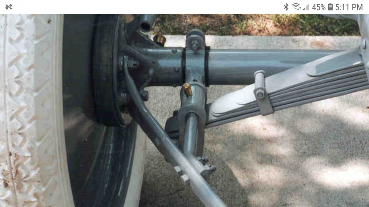

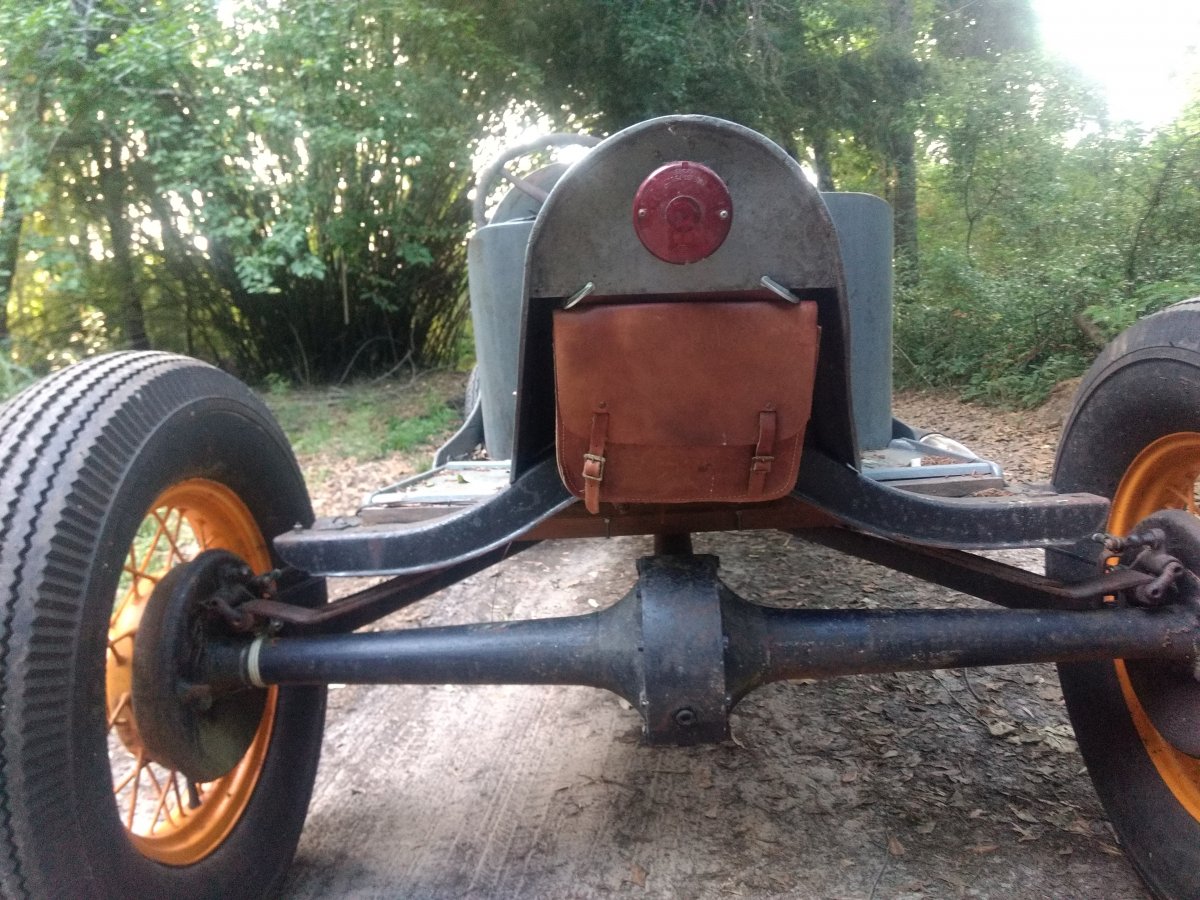

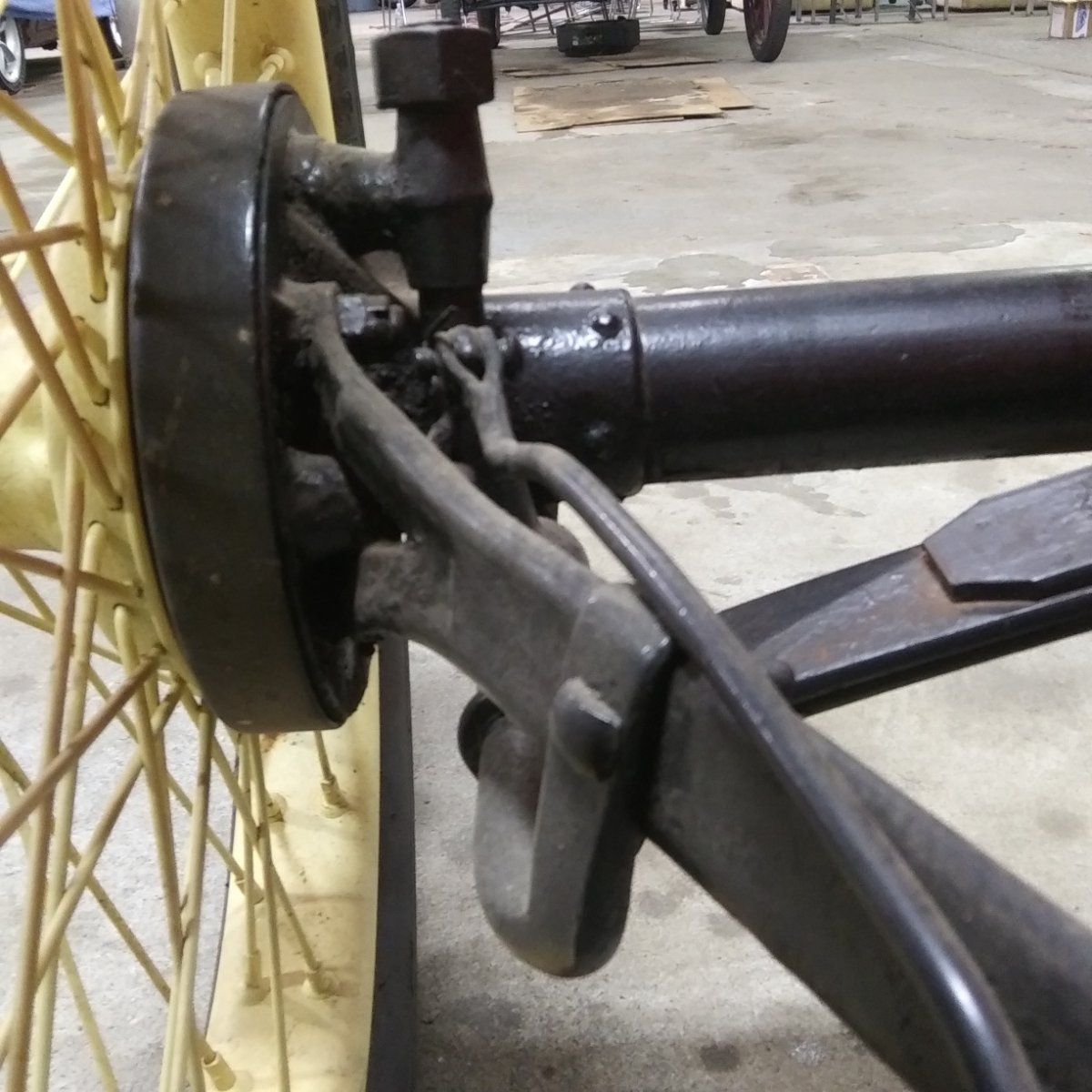

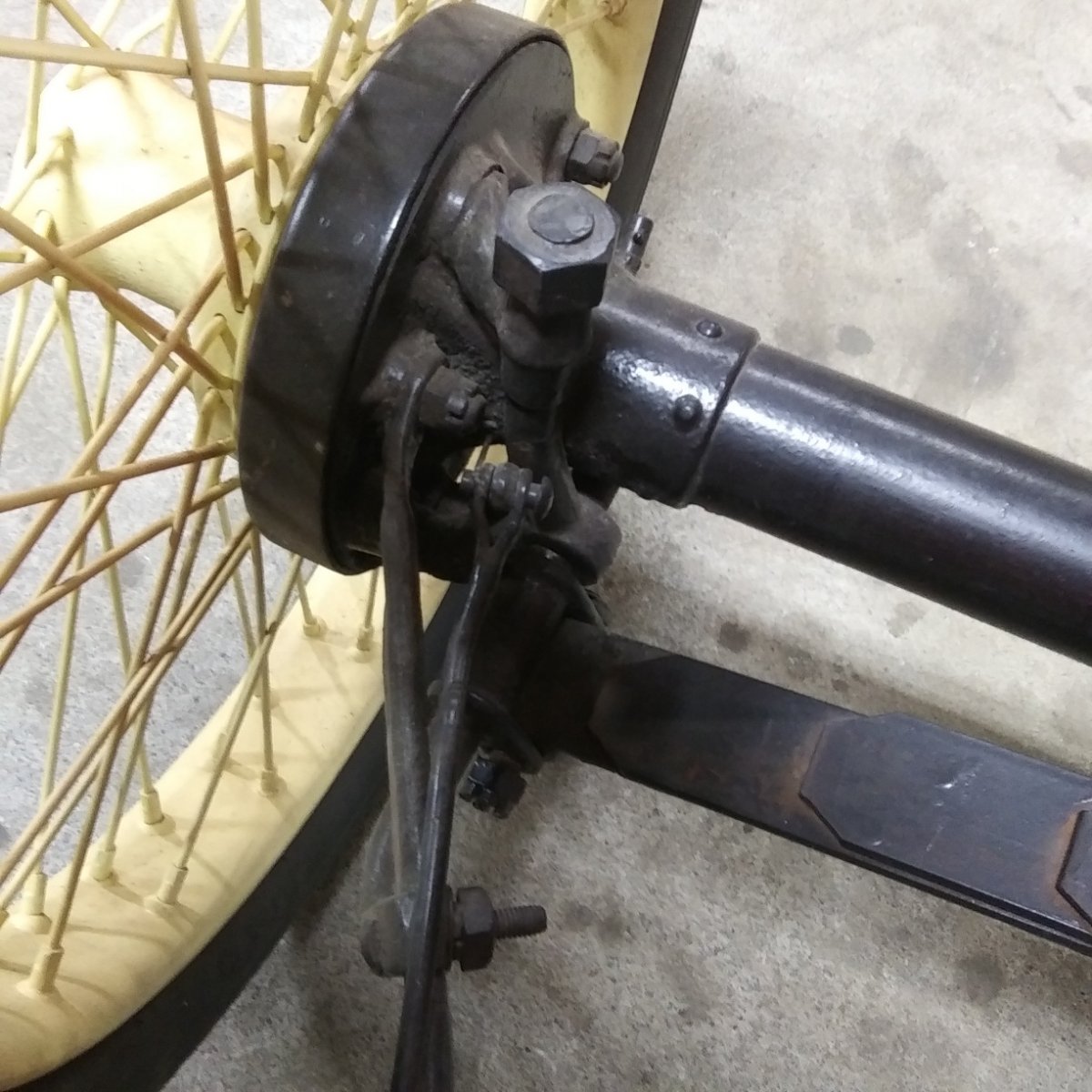

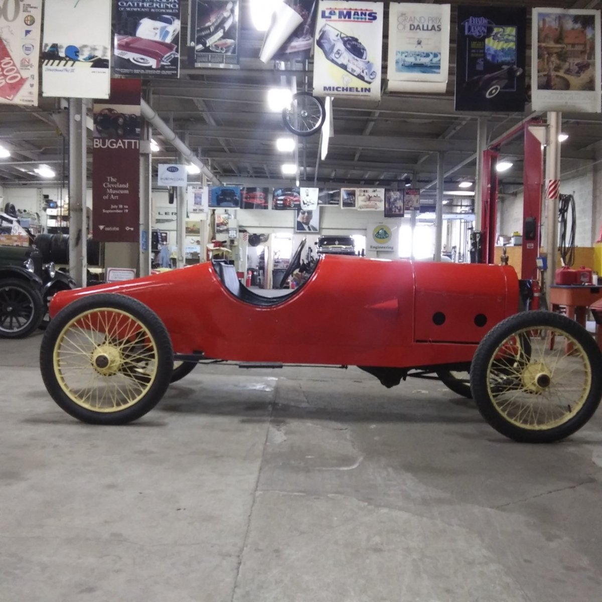

    sp5.jpg sp1.jpg 22.jpg 21.jpg sp5.jpg sp1.jpg FWIW: Here is the rear set up on my original speedster. The spring is in front of the rear axle. I believe this kit is a Morton and Brett as I saw it in an original Morton and Brett catalog. It uses the standard Ford spring perch turned on its side and a variety of cast brackets.
    Because the rear spring is in front of the rear end, the frame was shortened so the driveshaft did not have to be altered. Since the front axle was moved in front of the crossmember, the wheelbase has remained stock at 100". This car was put together in the 1920s using a Kuempel body kit.

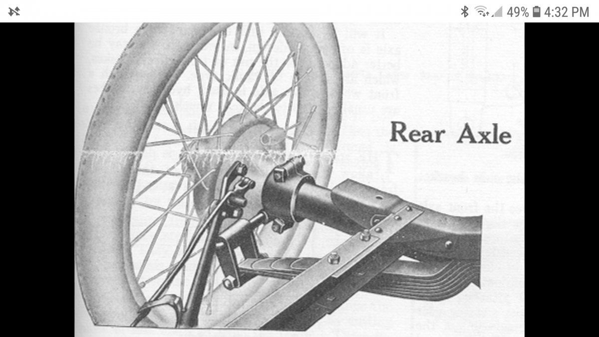

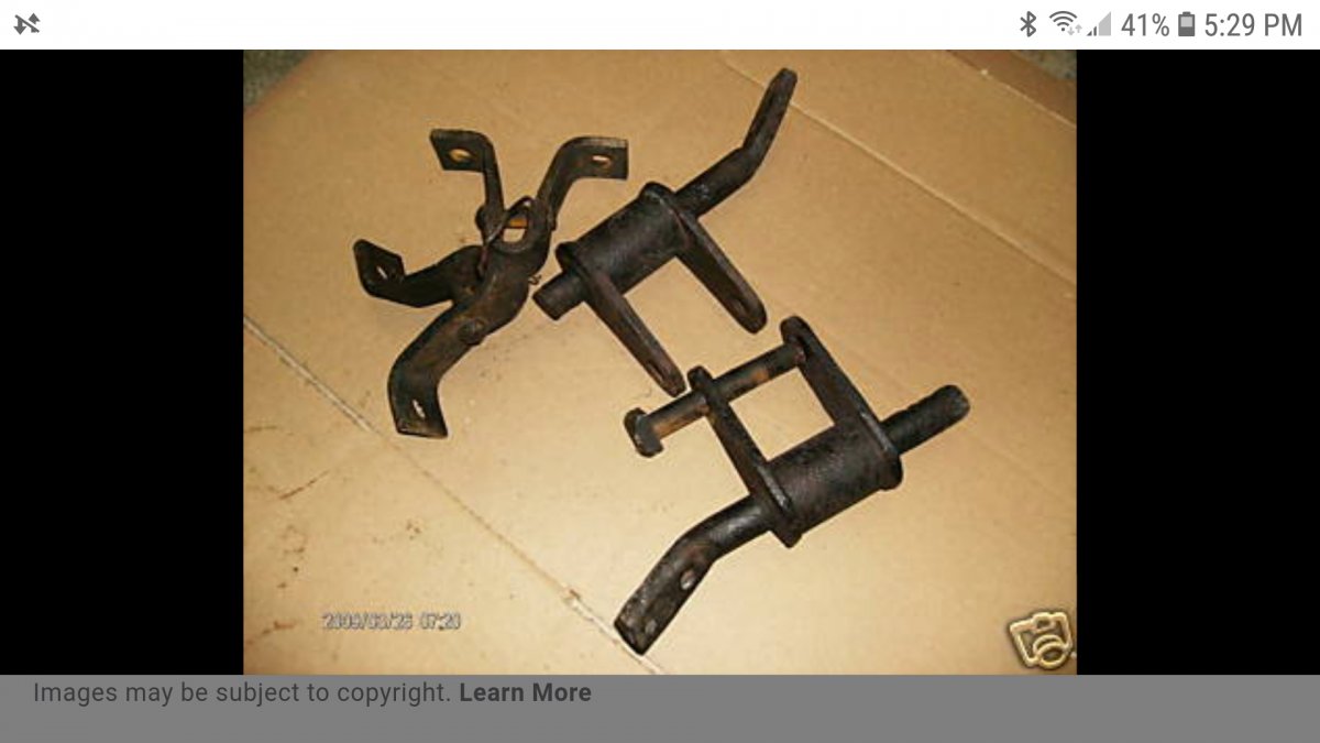

    Those rear underslung brackets, are those two piece? If I'm seeing it correctly the stock mount is turned 90degrees with a rod going down? Then it would have to bend another 90degrees forward, or is that bar bolted to another piece?
    I've been geeking out on Google. I'm going to do something using ideas from these pics.
    Screenshot_20200130-171106_Chrome.jpg Screenshot_20200130-171128_Chrome.jpg Screenshot_20200130-172947_Chrome.jpg Screenshot_20200130-173002_Chrome.jpg Screenshot_20200130-173424_Chrome.jpg Screenshot_20200130-174053_Chrome.jpg

    Obviously I'd have to shorten the frame, but I'm fine with that. It all can be sorted out when i kick up the rear.

    Let's see if I can put this into words...
    -The stock T spring perch is turned 90 degrees.
    -There is a long forging that fits into the stock perch and heads downward. There is another forging which, goes from front to rear and wraps around the radius rod at the front. The rear portion of this bracket goes through the vertical forged bracket and is attached with a castle nut. Just ahead of wear it goes through the vertical bracket, it is a "shaft" for the spring shackle to rotate on.
    -The spring shackles are unique to this set up. The top half of the shackle is hollow and rotates on the front to rear forged bracket. The bottom of the shackle is a removable "pin" which rotates in the Model T spring eye.
    It's a pretty ingenious set up and is period original.
    Does this make any sense???
    I am currently out of town but when I get back to the car, I can take some detailed photos if that helps.
    PS- You're making great progress and you are doing some great fabrication work.

    Perfect sense. Exactly what i imagined. Thank you.

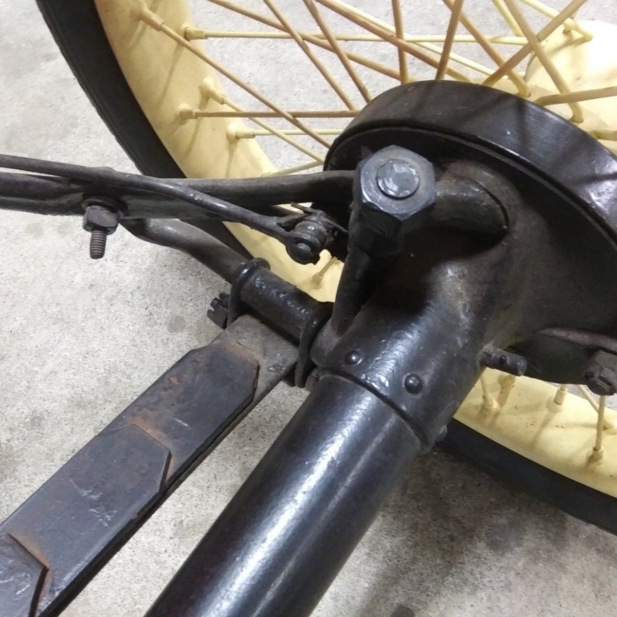

    Doing another thing...
    I will not making another attempt at reversing the spring eye for a measly 1" drop...

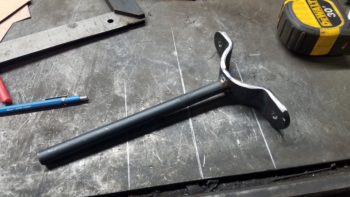

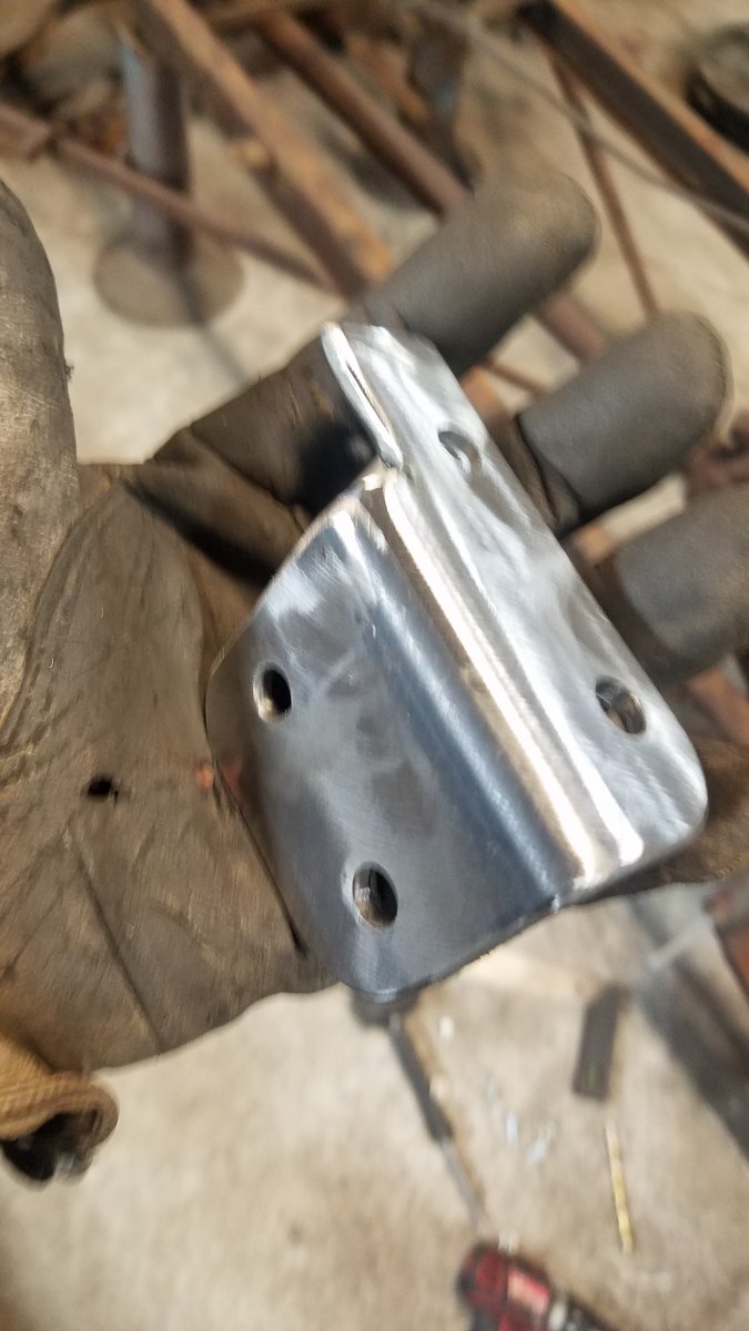

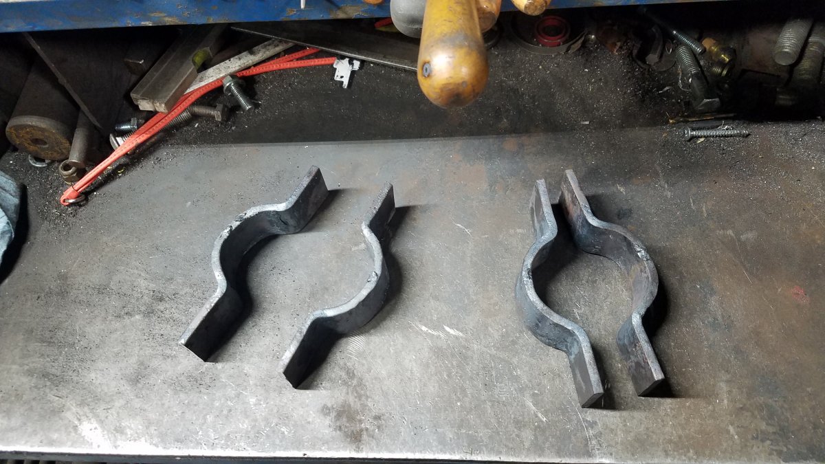

    Back to work on these things. I don't know why but they are taking forever...

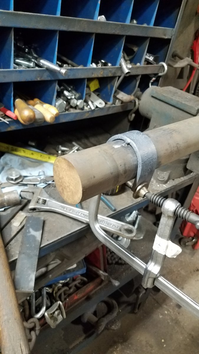

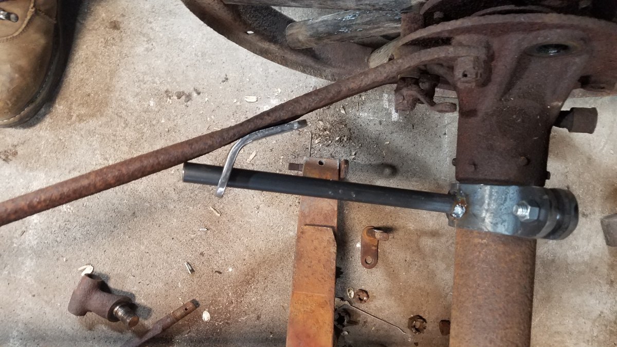

    I drilled out a 5/8" hole in the center of the 2 straps, stuffed the 5/8" rod through and welded both sides.

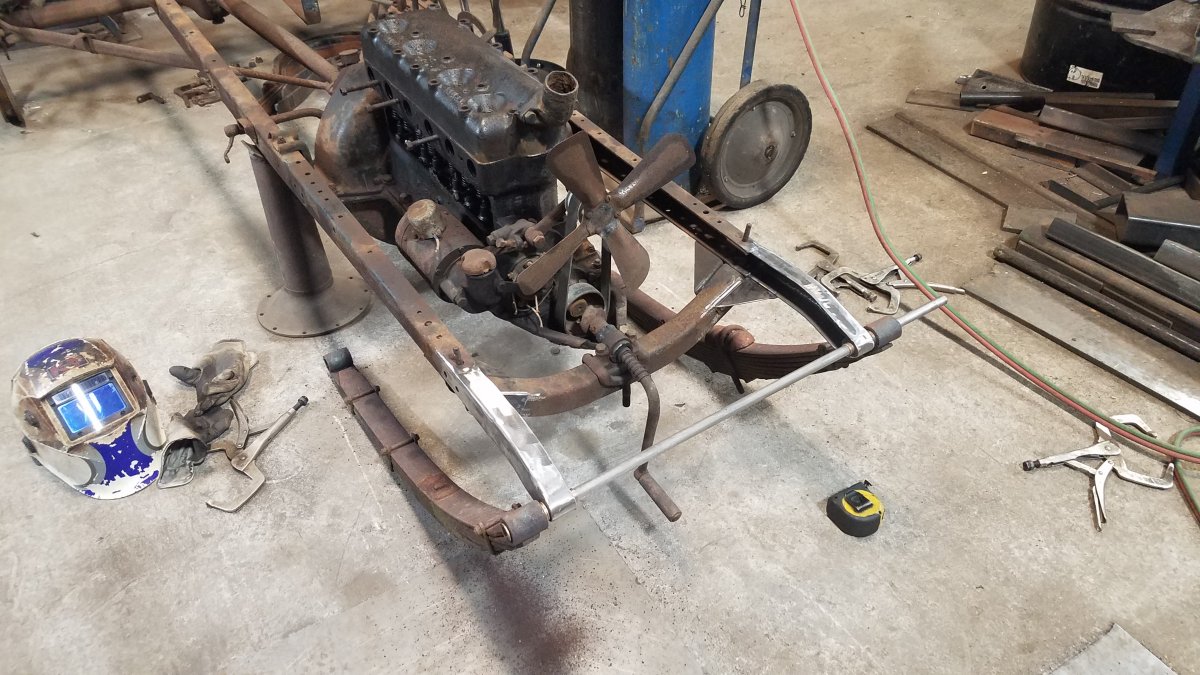

    Next time i get to work on it I'll have to make new shackles to ride on the bar, and make a mount to attach the bar to the bones.

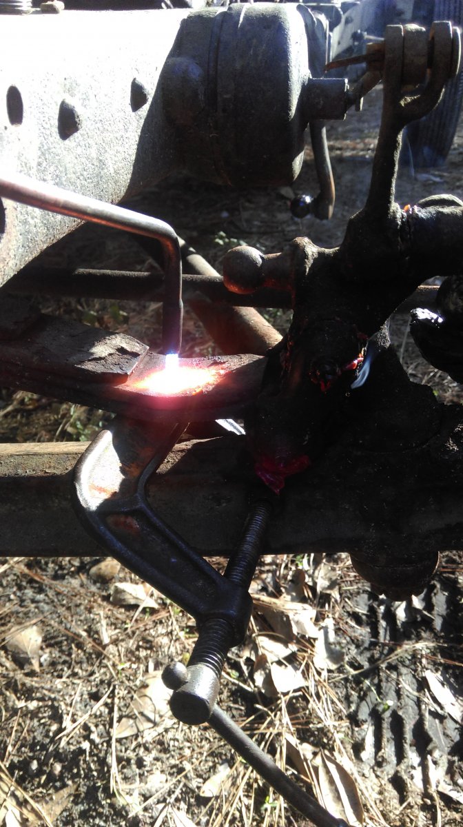

    Apparently just underslinging the rear spring isn't enough. This car also ran a heated spring. Something i kinda want to do, but all the nay sayers say "torch spring bad" It would make it so i won't have to Z my frame.

    I'm on the side that I see no issues with heating just the ends of the spring---which probably would be getting into the second leaf also. So many of the cars were built this way. If you were to go farther up in the spring pack, then I'd say no.

    I heated mine, front and rear, so far no problems. Speedsters are so light, and those springs are substantial pieces of steel. Like you say, it was done all the time, back in the day. I'd say do it. You'll be able to get more drop than I did, since your differential will be behind the spring.
