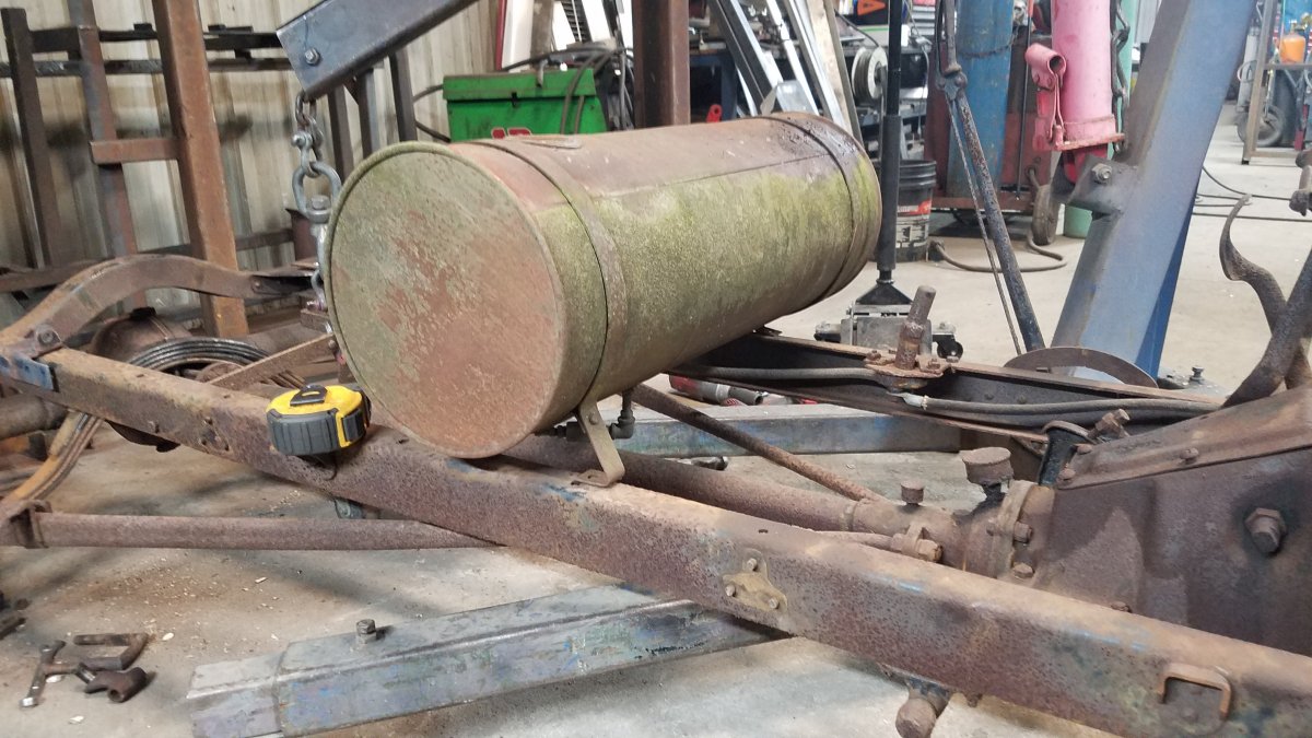

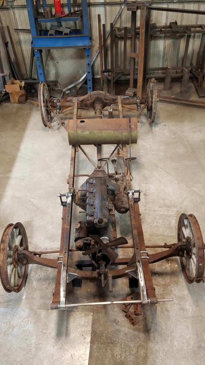

    Spending $$$. The T tank seemed like a good idea while i was standing out in the snow. Now that i see it on the ch***is in the stock location however...
    I got my column
    Then back on these spring mounts...

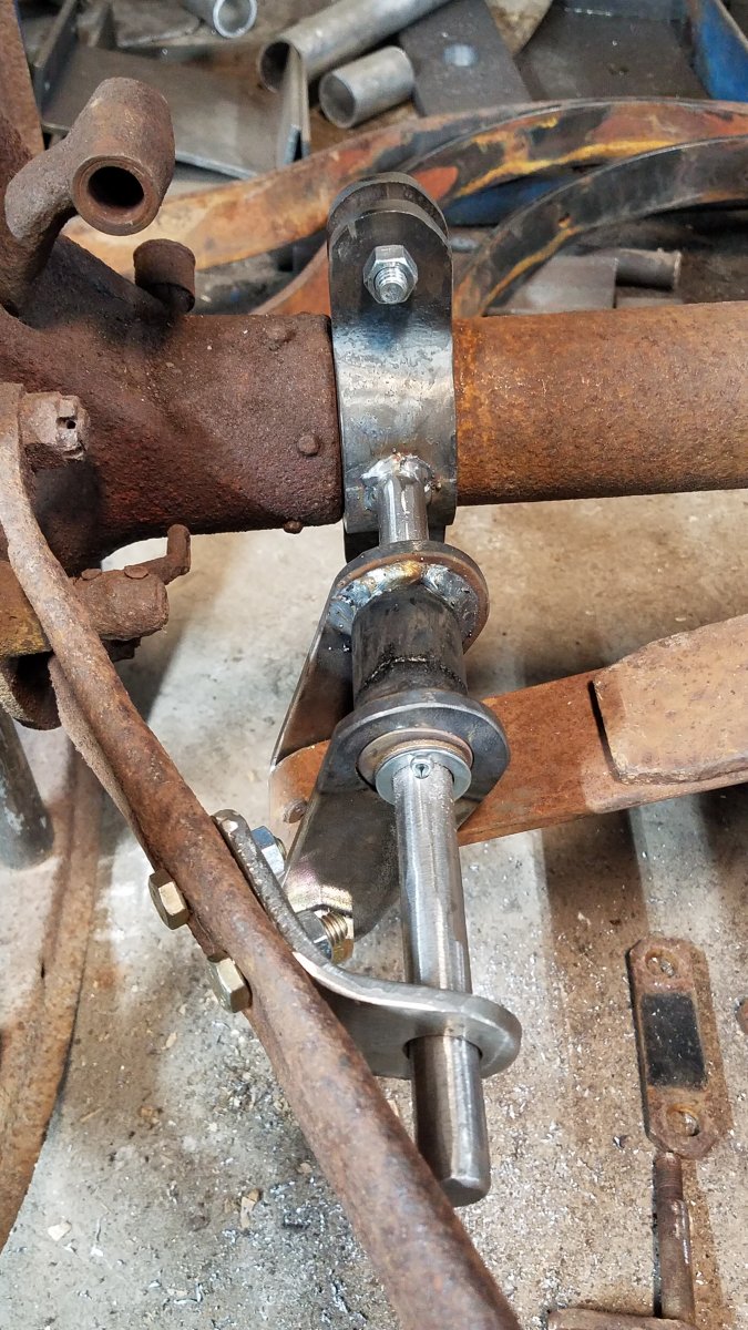

    Almost there. Just one more step and I'm done! I had to remake my shackle bosses today, some idiot didn't take into account the thickness of the shackle plates.
    Bosses are made from 1 1/4" hot roll round drilled out to 3/4" to accept the 5/8" bronze bushings. The shackle plates are whiddled out of 1/4" x 2" hot roll flat drilled at 1 17/32" so the boss fits in, and drilled for a 9/16" bolt at the lower end.
    Tomorrow i will weld the plates on and have this all finished up. Then onto planning the body...

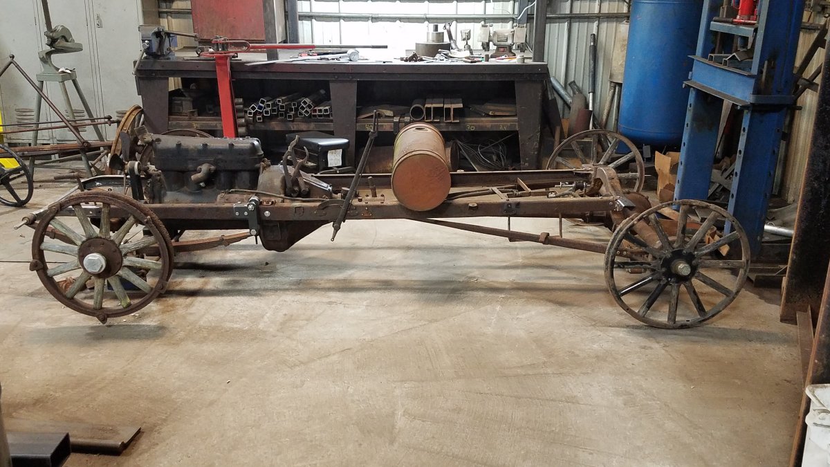

    SNOW DAY!!!
    We're back on the ground now. Some shocks and the suspension is done!

    Wheelbase? Check. Height? Check. You're doing great. Those are perfect proportions.

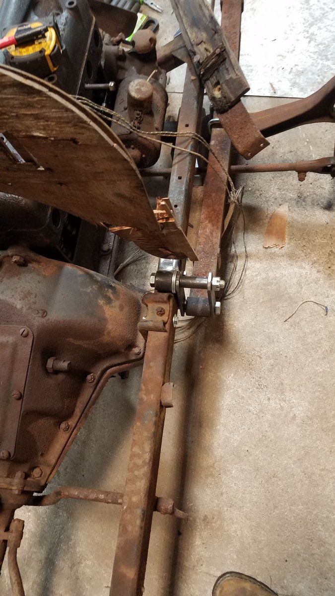

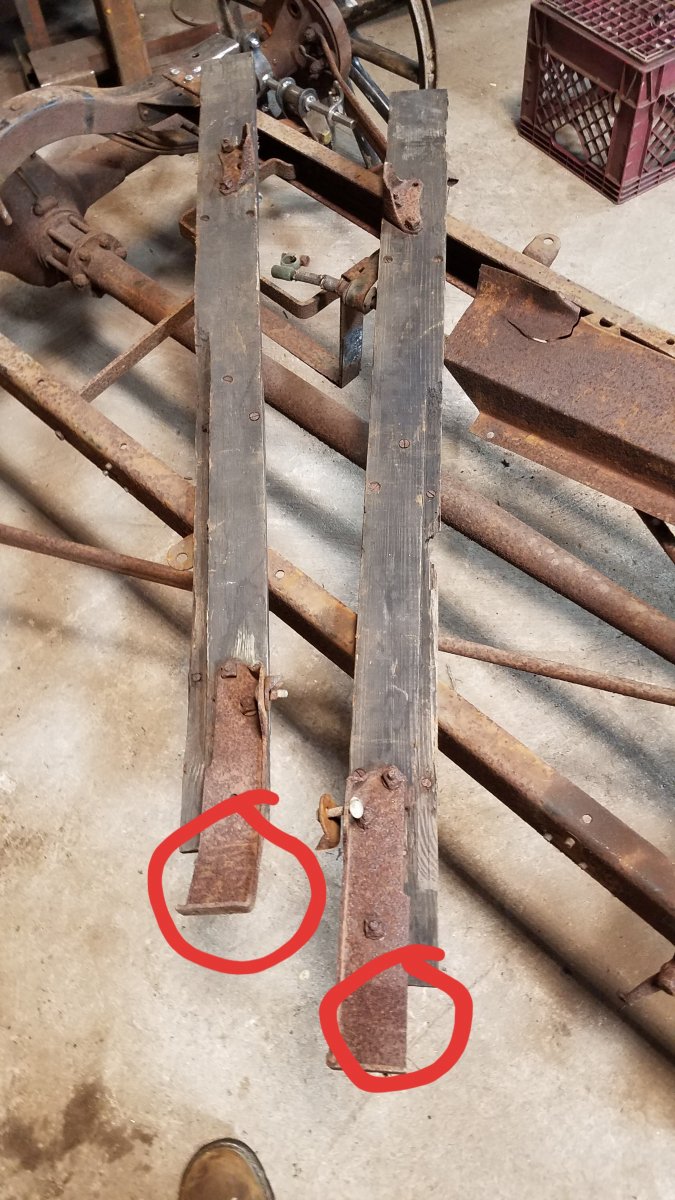

    Ok model T peeps, i got a question. These pieces i circled, do they connect to the side behind the firewall? If so im ***uming there is wood there?
    I'm hoping to have plywood down on the frame today. Before i do that i need to fix the front body mounts someone cut off. Luckily, i have them...
    Then onto my least favoritest thing in the planet... wood working...

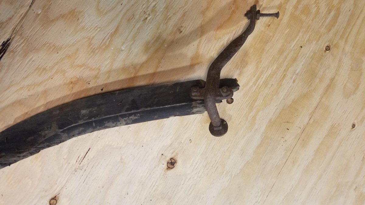

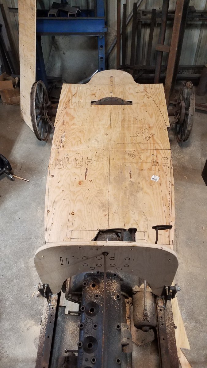

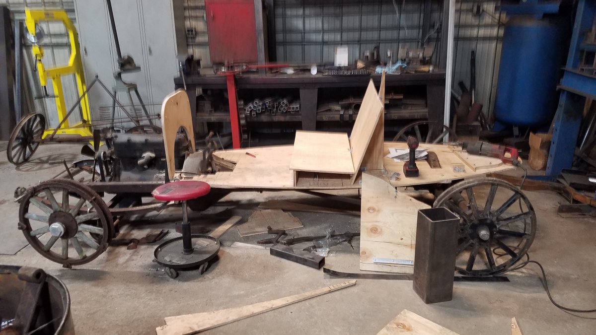

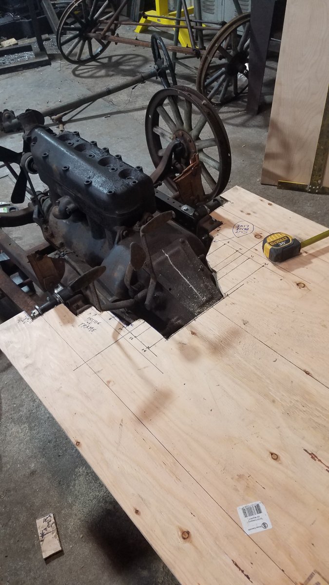

    I made a bit of progress on the temporary floor.

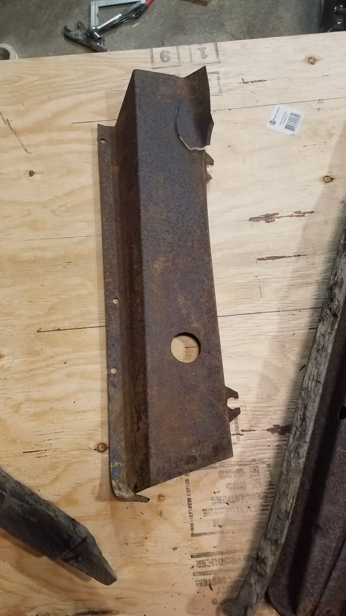

    These are the parts im unsure as to what they are...
    This one im hoping is the wood for the seat back? If so i could use it for a pattern...

    With the stock body removed, those are the only brackets that hold the firewall. There are some bolts which hold it to the top cowl sheet metal on a stock body. On pre-1914 stock Model Ts those the ONLY brackets that hold the firewall. There is a long rod which goes from the top of the firewall into the back of the top radiator tank as well. That just sturdies everything up. Most speedsters that have just a flat firewall just use these bottom frame brackets and the long rod to the radiator. Plenty sturdy enough.
    Those longer thin tin pieces are the engine pans. They go on the left and right of the engine. They cover the gap between the engine and the frame. They attach to the bolts that hold the pan to the block and go to the frame, where they are attached with the long skinny bolts that hood the hood shelves on. The one with the hole punched out is the p***enger side. That hole is for the carburetor drain. The one with the big cutout is the driver's side. That weird big cutout allows the steering column to p*** through the engine bay.
    That wood piece with that weirdly shaped bracket runs along the top of a touring or roadster body. That weird looking, cast bracket supports the convertible top. The main top bow attaches and pivots to this.
    From the photo, I can not tell what that gray-ish looking part is. Doesn't look familiar from that angle.
    Looking forward to seeing the body design!!!! Keep up the great work!!!

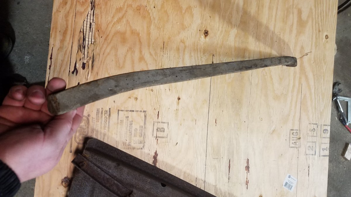

    Thanks GZ! I do have the rod for the radiator, needs some straightening but over all its still a good piece.

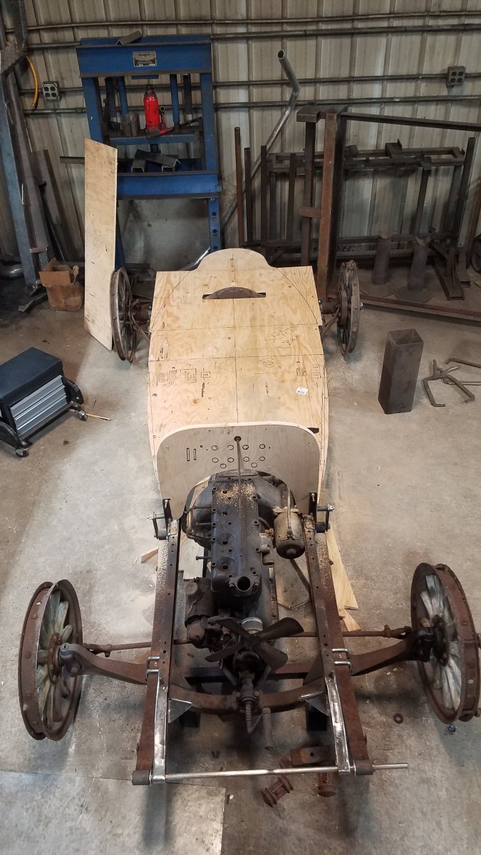

    Here's how far i got today. I gotta say I'm pretty pleased with the outcome for not knowing what the heck I'm doing.

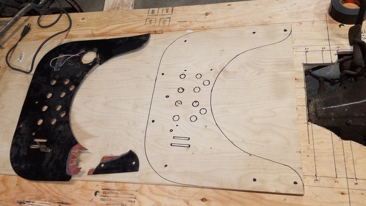

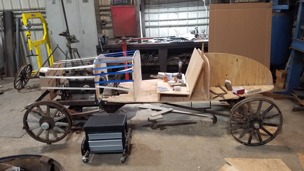

    So it took me longer to mock this seat up than it did to shape out the floor... funny how that works 20200214_180409.jpg

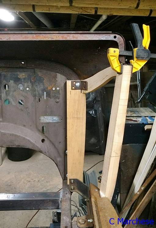

    The brackets you showed a few days ago go like in the pic below....this is my body I am rewooding---I too **** at woodworking.
    However, building the body that you are, I wouldn't even worry about it, as you see, you can just do the flat wood floor, which lowers the body 3-4 inches from stock.
    By the way, if your not using any of those brackets, I'd be interested.

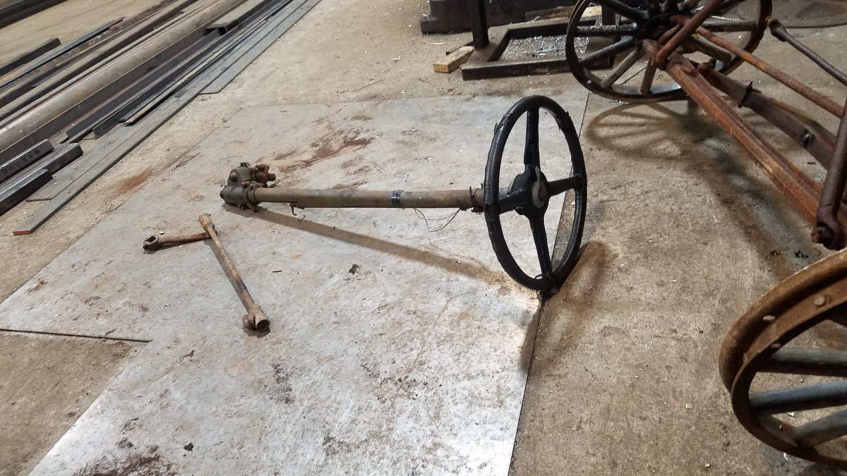

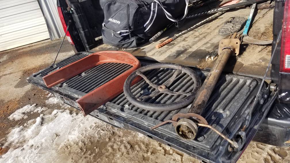

    Im in need of whatever goes between the column and steering wheel. 20200223_140023.jpeg
