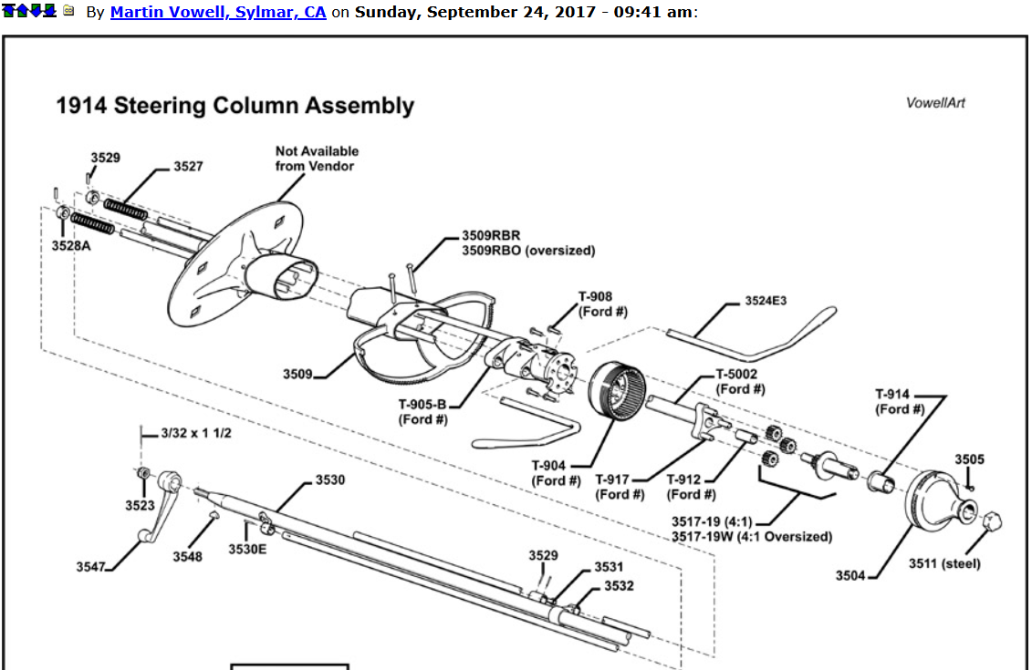

    This is a pic of a 1914 column by Martin Vowell that is used in the parts catalog. It's a little different, but you get the idea of what you need. I believe all the gear parts are the same until the 5:1 ratio in 1926.

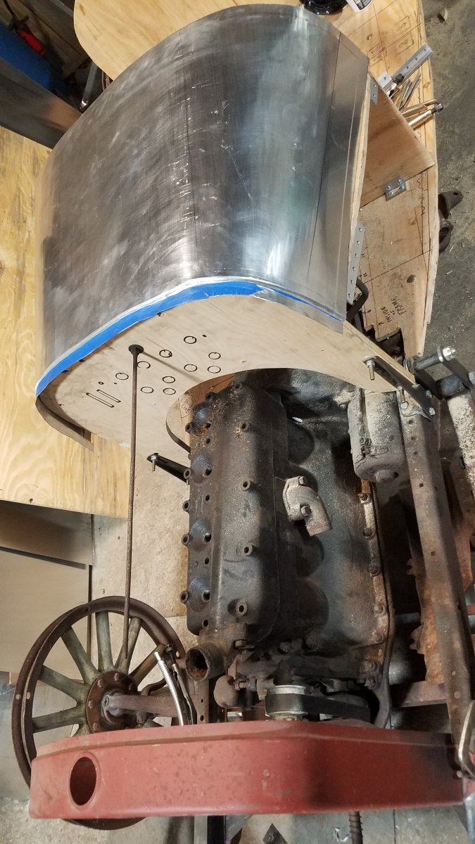

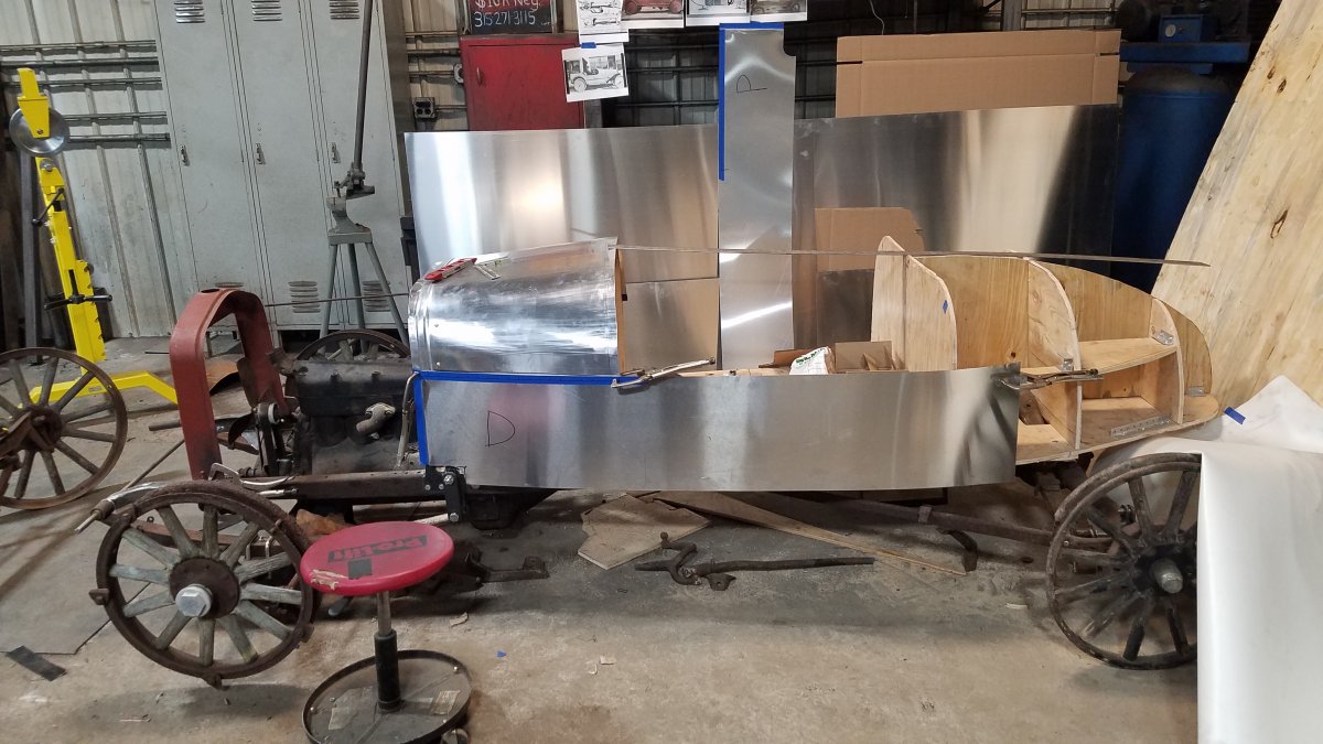

    First time using an english wheel. Things went pretty smoothly. I did learn that you can't bead roll over hardened aluminum. It rips. So i also learned how to anneal aluminum..

  10. hillbilly4008
    Joined: Feb 13, 2009
    Posts: 3,084
    hillbilly4008
    from Rome NY
    Bob, i was going to make a crack about you not buying that $25 special while you were there, but I'll be nice.
    I'm taking baby steps on the car. Time is at a minimum, and when i do work on the car it seems like very little gets accomplished. But am very happy with how it's turning out.

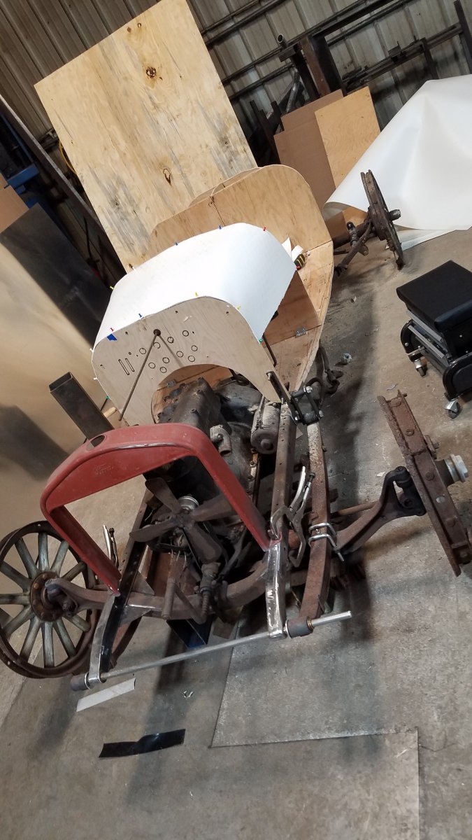

    Today i finished my mounting tabs to mount the cowl to the fire wall, bolted it all down with br*** hardware, took it all apart and added another bead along the front of the cowl.
    20200301_170830.jpg 20200301_170845.jpg obviously I'll have to go back and planish a bit later on.
    The side panels will rivet on. I will be continuing the bead down the front to meet with the hood, and will also continue the raised bead down the length of the car...

    The pop rivets are temporary. I have solid rivets waiting. I'll have to go back and clean up the lines with a dolly, i wish i didnt try and make that 90 so tight...

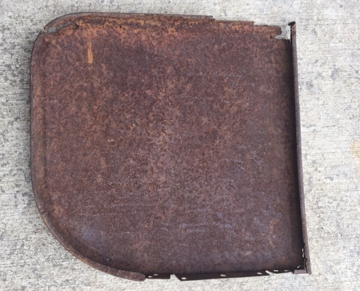

    Question: how is the wood framing attached to the sheet metal in a Model T? Screws through the outside?
  13. GZ
    Joined: Jan 2, 2007
    Posts: 1,457
    GZ
    from Detroit
    The metal is crimped/bent over the wood. Small tacks attach the metal from the backside. The area that the tacks go through is quite narrow, just enough bend over to allow surface area for the tacks to go through. Nothing is visible from the outside. I don't believe screws were ever used.
  14. GZ
    Joined: Jan 2, 2007
    Posts: 1,457
    GZ
    from Detroit
    Here are some photos of a typical, 1915-1925 Model T door. Not sure how well you can see in these photos, but this is the back of the door. Hopefully the closeup shows you the bent over ridge where the tacks go through and attach to the wood inner structure. All of the body sheet metal that attaches to wood is bent over like this-side panels, etc.
    Hope this helps.
    Your sheet metal fabrication looks great. I like where you are going with the body design.

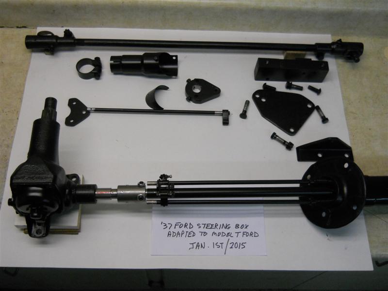

    How did you do away with the planetary gears up top, and that short center gear? Years ago someone did a setup like that and had something like 12 turns lock to lock with the stock T upper gears. :confused::confused: Bob

    Bob, it's just a longer center shaft of 4130 steel that replaced the original shaft and gear setup.
