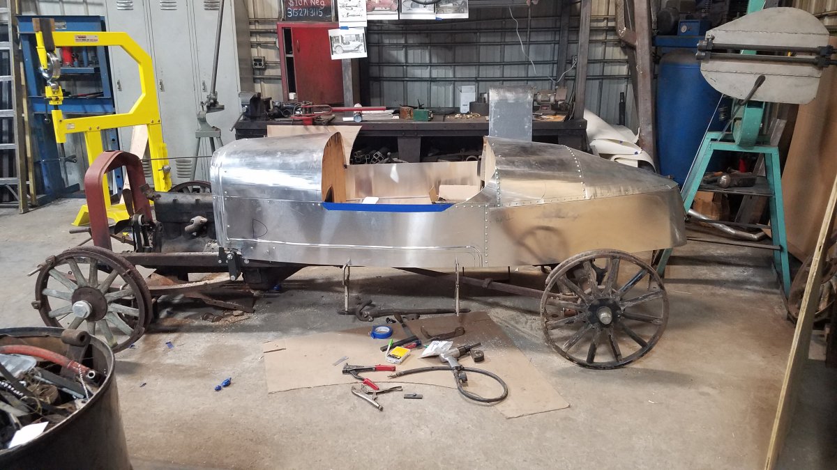

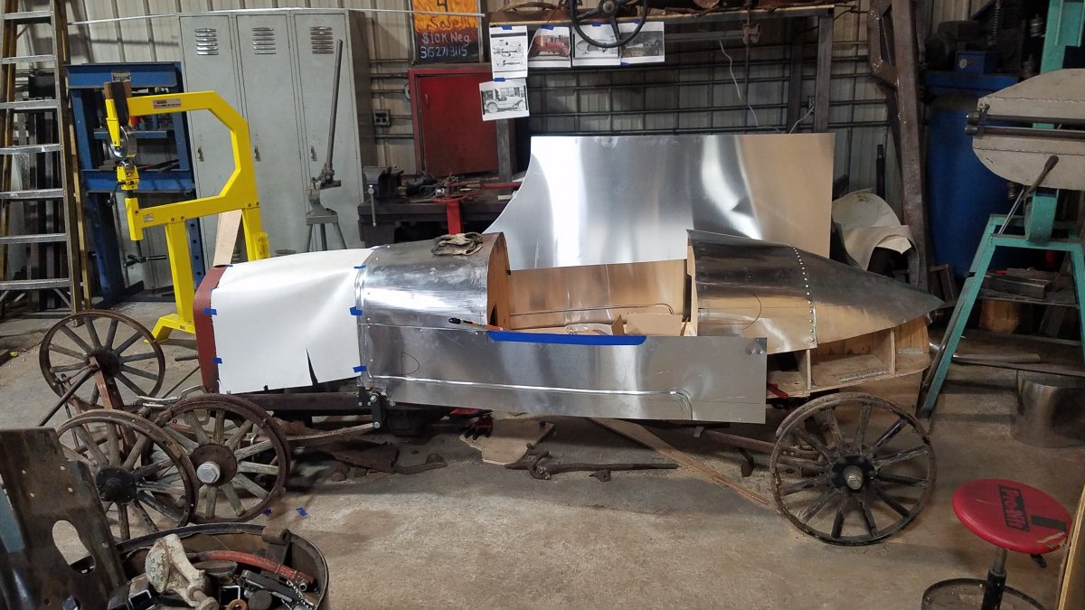

    Making slow progress on the tail.

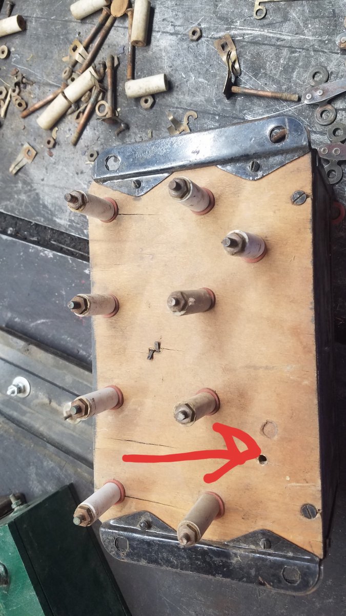

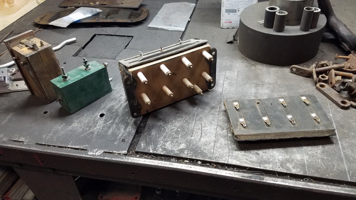

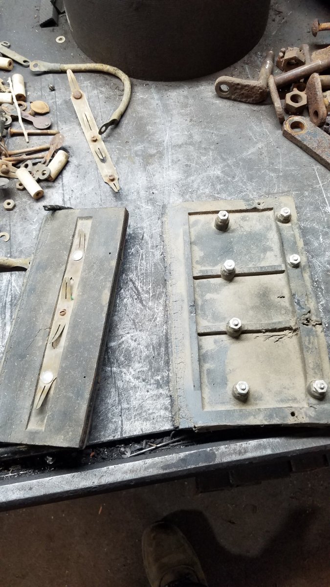

    ....This just in....peach pits and all...
    20200312_112345.jpg 20200312_112449.jpg 20200312_112455.jpg 20200312_112505.jpg

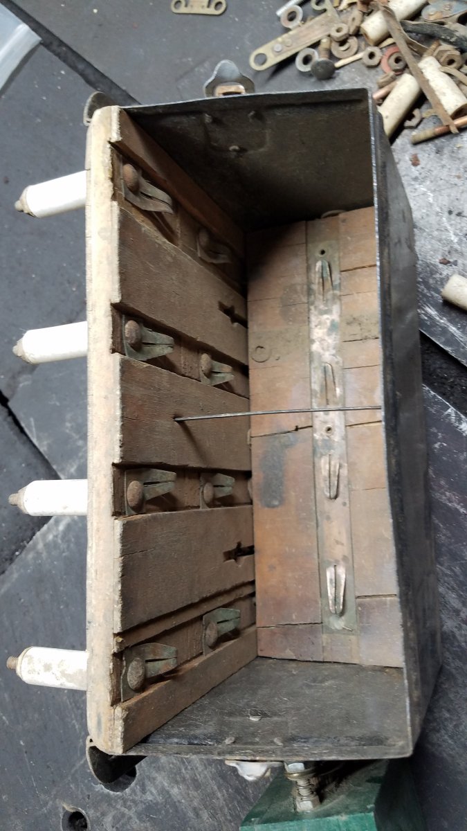

    This was on ePay as a Fordson tractor unit. The pics looked like they would work in my car. I grabbed it mainly for the box.
    Now not knowing jack about these T buzz boxes, can someone tell me what (if anything) i can use?

  5. The37Kid
    Joined: Apr 30, 2004
    Posts: 32,515
    The37Kid
    That is Model T, later style that had the switch on the dash. Bob
  6. hillbilly4008
    Joined: Feb 13, 2009
    Posts: 3,084
    hillbilly4008
    from Rome NY
    All holes line up perfectly with what's left of my original fire wall. Except, either one post is missing. Or optional?
  7. GZ
    Joined: Jan 2, 2007
    Posts: 1,457
    GZ
    from Detroit
    Looks like one post is missing. That missing post is for the "Battery" connection. You'll need that! It uses the same tubes/studs as the other 9. Looks like you have plenty of spares.
    From memory, on the inside, this "Battery" posts has a wire soldered to the back of it which runs underneath the lower wood piece and gets soldered to the copper contact strip that runs across the bottom wood piece in the coil box. It will be the same as the "Magneto" post which is horizontally across from it.
    When the box is installed in your car, the wire from the "Battery" will connect to this missing post and a larger wire (like the spark plug to coil box wires) will connect the opposite post to the magneto post which is on top of the transmission cover.
    Hopefully this all makes sense!

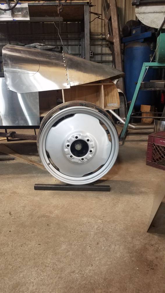

    [emoji848]19x3...should take a 400-19 tire....now how do i make this work...[emoji848] 20200313_104838.jpeg 20200313_104844.jpeg

  9. The37Kid
    Posts: 32,515
    The37Kid
    Are you annealing the aluminum to form the tail section? Bob
  10. hillbilly4008
    Posts: 3,084
    hillbilly4008
    from Rome NY
    Only when i feel it needs it. Im using 3003 alloy, doesnt need to be annealed unless it work hardens.
    I need to get different lower anvils for the harbor freight english wheel. It isnt letting me get the roundness i want at the very back.
    I do have a planishing hammer, may be able to use that to get there. I was going to test a piece today. I've made a bunch of s****s to test on.
    chryslerfan55 and The37Kid like this.

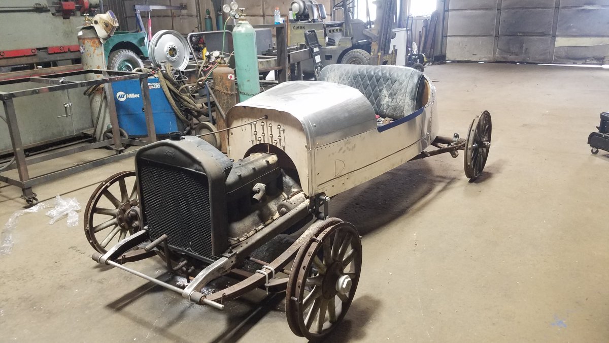

  12. hillbilly4008
    Posts: 3,084
    hillbilly4008
    from Rome NY

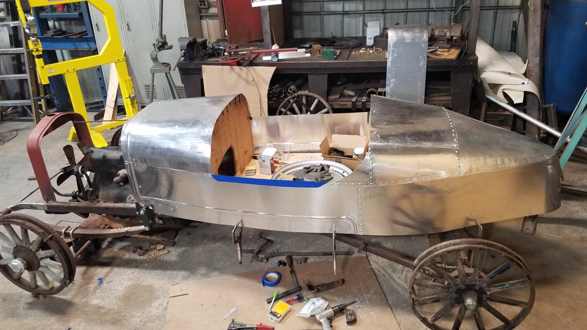

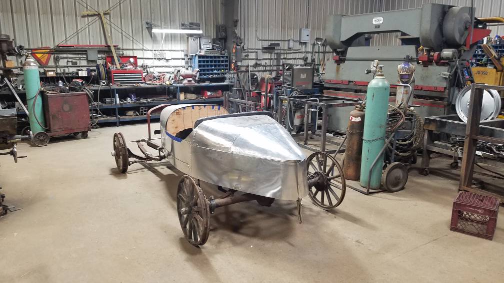

    Getting some where. Gas welding is not yet my bag. I'm capable of hammering rivets though
    Still need to make the underside of the boat tail, then i figure I'll make a nose piece and pop her on.

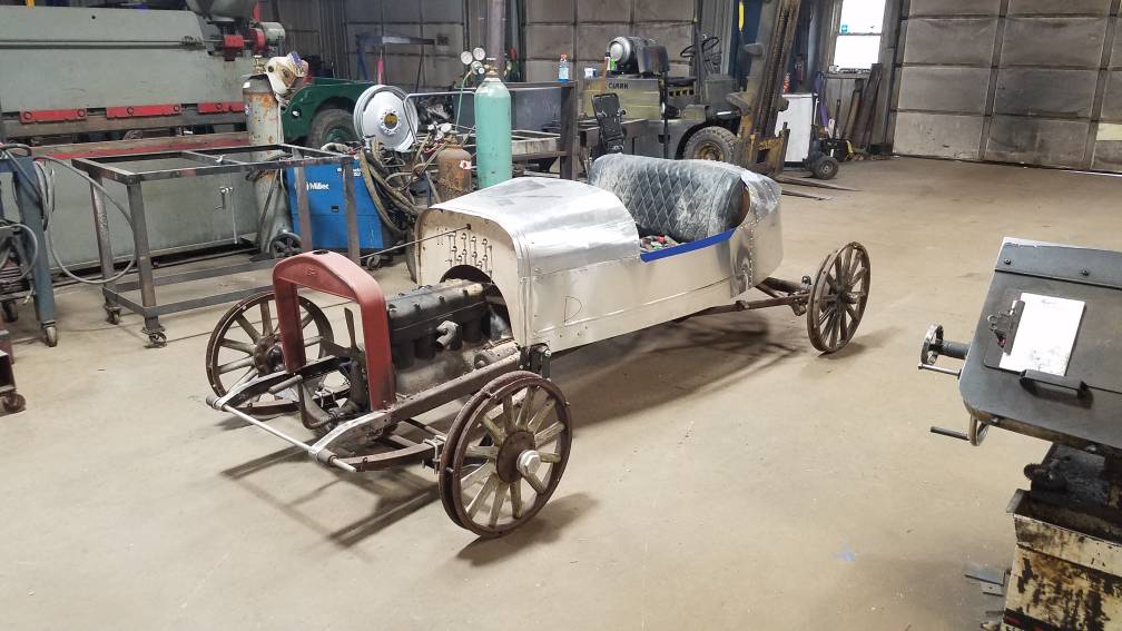

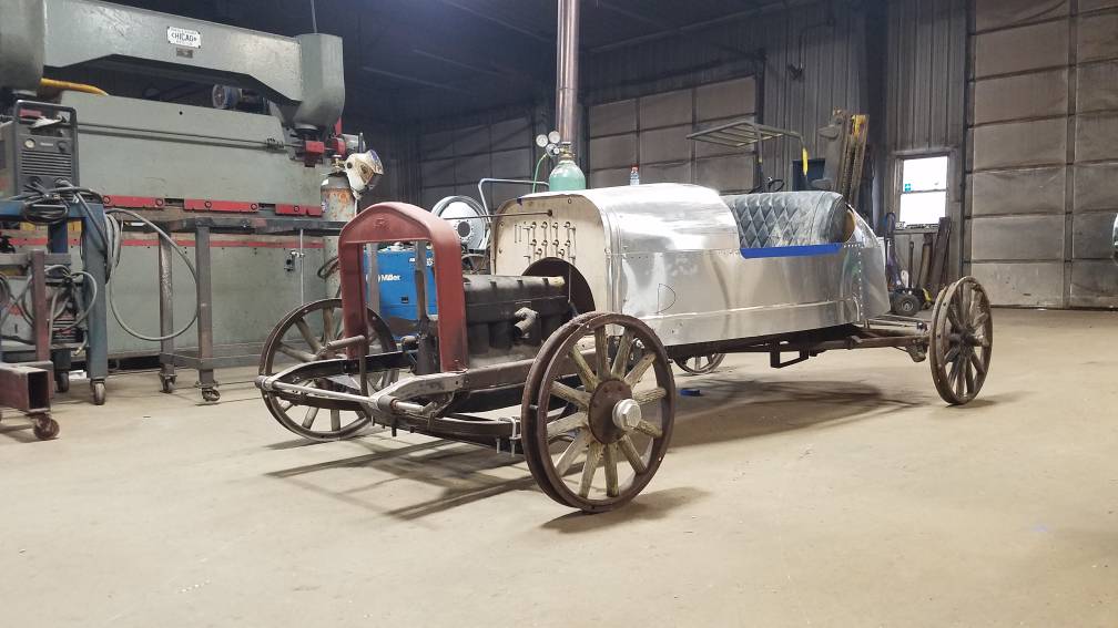

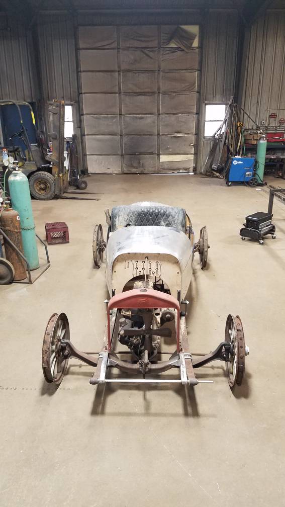

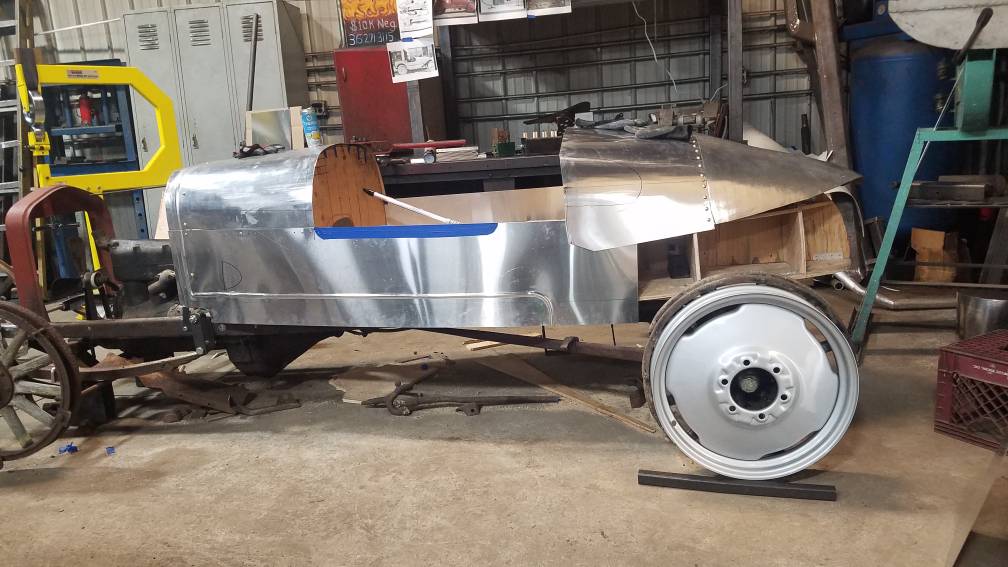

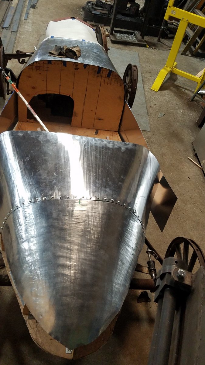

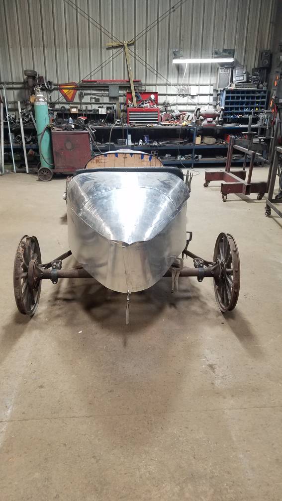

    Life slowed down a bit because of all this nonsense going on. So im finally able to spend some time in this now. I rolled it into the center of the shop. Parts on the way. Hoping to get **** done... 20200430_171659.jpeg 20200430_171707.jpeg 20200430_171724.jpeg 20200430_171733.jpeg 20200430_171800.jpeg

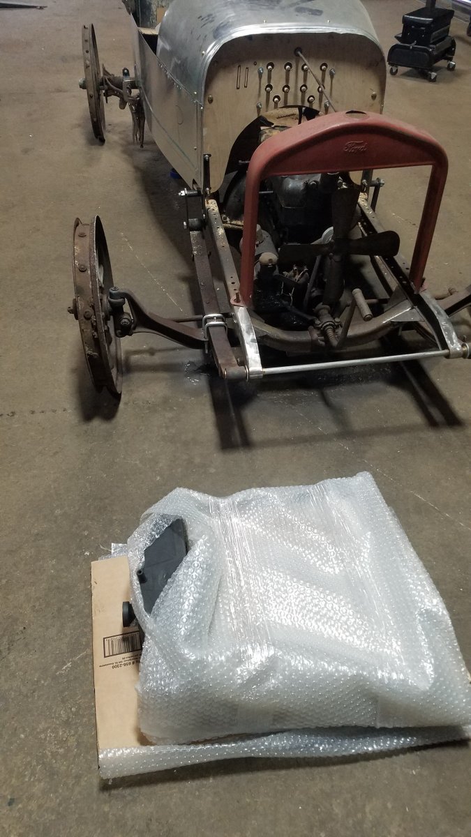

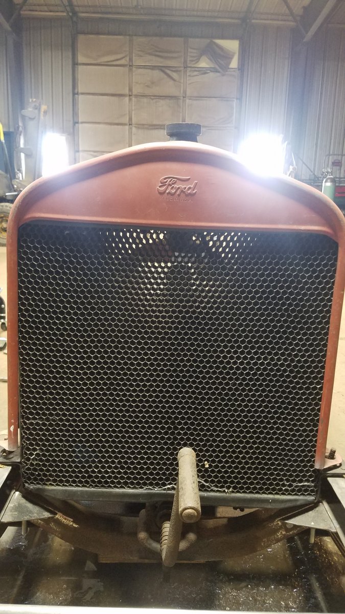

  17. hillbilly4008
    Posts: 3,084
    hillbilly4008
    from Rome NY
    20200501_105001.jpg 20200501_110137.jpg 20200501_110356.jpg 20200501_112552.jpg I love it when there is a present waiting for me at the for in the morning!
  18. 64 DODGE 440
    Joined: Sep 2, 2006
    Posts: 4,433
    64 DODGE 440
    from so cal
    Love the honeycomb radiator.

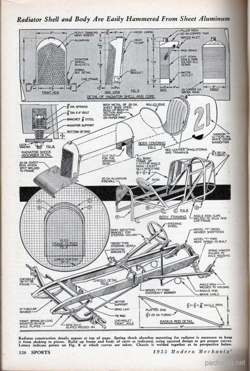

  19. scoobywrx
    Joined: May 15, 2025
    Posts: 2
    scoobywrx
    Please can somebody help me identify which 1935 issue of the Modern Mechanix magazine this article appeared in? Even better, does somebody have a scan of the other pages? Thanks.
  20. SR100
    Joined: Nov 26, 2013
    Posts: 1,328
    SR100
    The whole article can be downloaded from the Flickr album
    build your own model a racer
    Only the first seven pages are from the same article. Interestingly, none of the pages list the issue they came from. It might have been published in a book of plans instead of a regular issue.
    Several of ‘Little Green Austin’s’ other albums were of interest and are worth a browse.
    GuyW likes this.
  21. scoobywrx
    Posts: 2
    scoobywrx
    Thanks for the link, perfect! I also followed your advice and looked at the other albums - the Arlen was particularly interesting as my current project is front wheel drive, primarily inspired by Harry Miller, but I now have some more inspiration, thanks!
