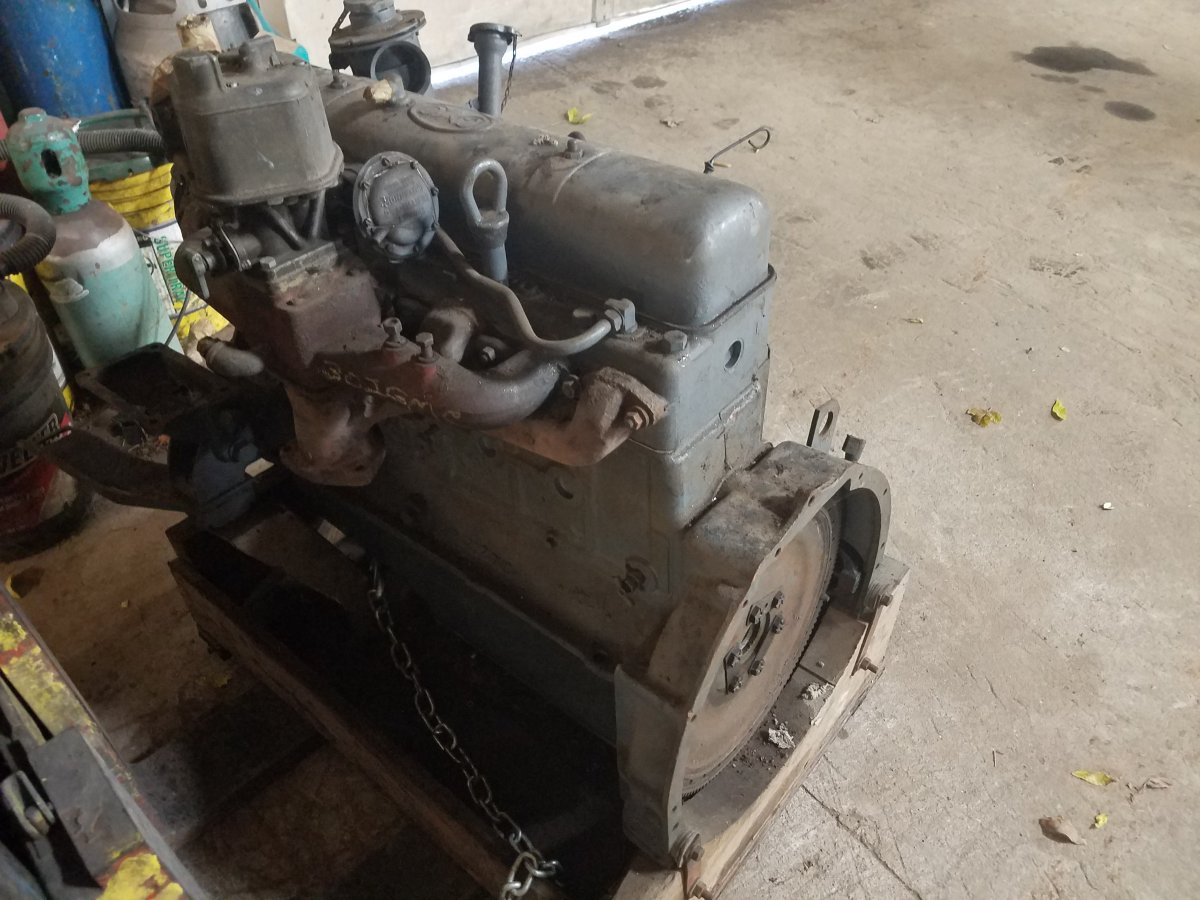

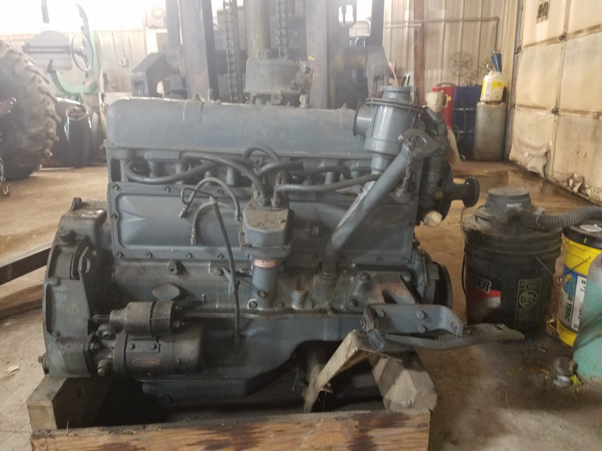

    So after ****ing with this flathead for a few weeks I've decided to throw in the towel. Between new rings and head gasket in in it for over $100 and i still do not have compression on cylinder #1.
    Engine has to come out, and i really wanted a bigger motor from the start. Why spend more $$$ on the flathead.
    Today i brought home the Jimmy 302. Its a military motor, but fully rebuilt. The money i saved on building it i can spend on whatever it takes to convert over... 20181031_165205.jpg 20181031_165152.jpg
  3. 1-SHOT
    Joined: Sep 23, 2014
    Posts: 2,903
    1-SHOT
    from Denton
    Looks like it had a Hydro-Matic behind it in its former life.
  4. hillbilly4008
    Joined: Feb 13, 2009
    Posts: 3,095
    hillbilly4008
    from Rome NY
    Maybe its just me, but that bellhousing seems m***ive
  5. Rocky
    Posts: 17,630
    Rocky
    Classified Editor
    I don't understand wanting a Jimmy 6 over a V/8 pontiac motor but it's your thing. I always wanted to use a 55-60 Pontiac engine in one of those cars and get it to bolt in. Both 6 and straight 8 used similar mounts to the early V/8s with mounts on bell housing and under the front pulley. I suppose the steering gear might be a point of interference but may be overcome with cunning and ingenuity.
    The 6 banger should clear any steering components ok. A later GMC 6 banger bellhousing, flywheel and clutch should accommodate a modern GM manual trans...even a T-5 which would work with the old axle gears.
    A later Pontiac V/8 would also work with the same transmissions as the GMC.
    My old 5 ton army truck and all the vehicles in the motor pool had 24 volt systems. Might have to find a 12 volt GMC starter if your is a 24 volt unit.

  14. 1-SHOT
    Posts: 2,903
    1-SHOT
    from Denton
    Yes it has sealed ignition, it's part of a fording kit. All the electrical system was water tight ever the generator was sealed.
  15. hillbilly4008
    Posts: 3,095
    hillbilly4008
    from Rome NY
    Which is turning into a royal pain in the ***. Ive depleted my stash of parts, and all the good local old school junk yards are crushed out, or buried in snow right now...

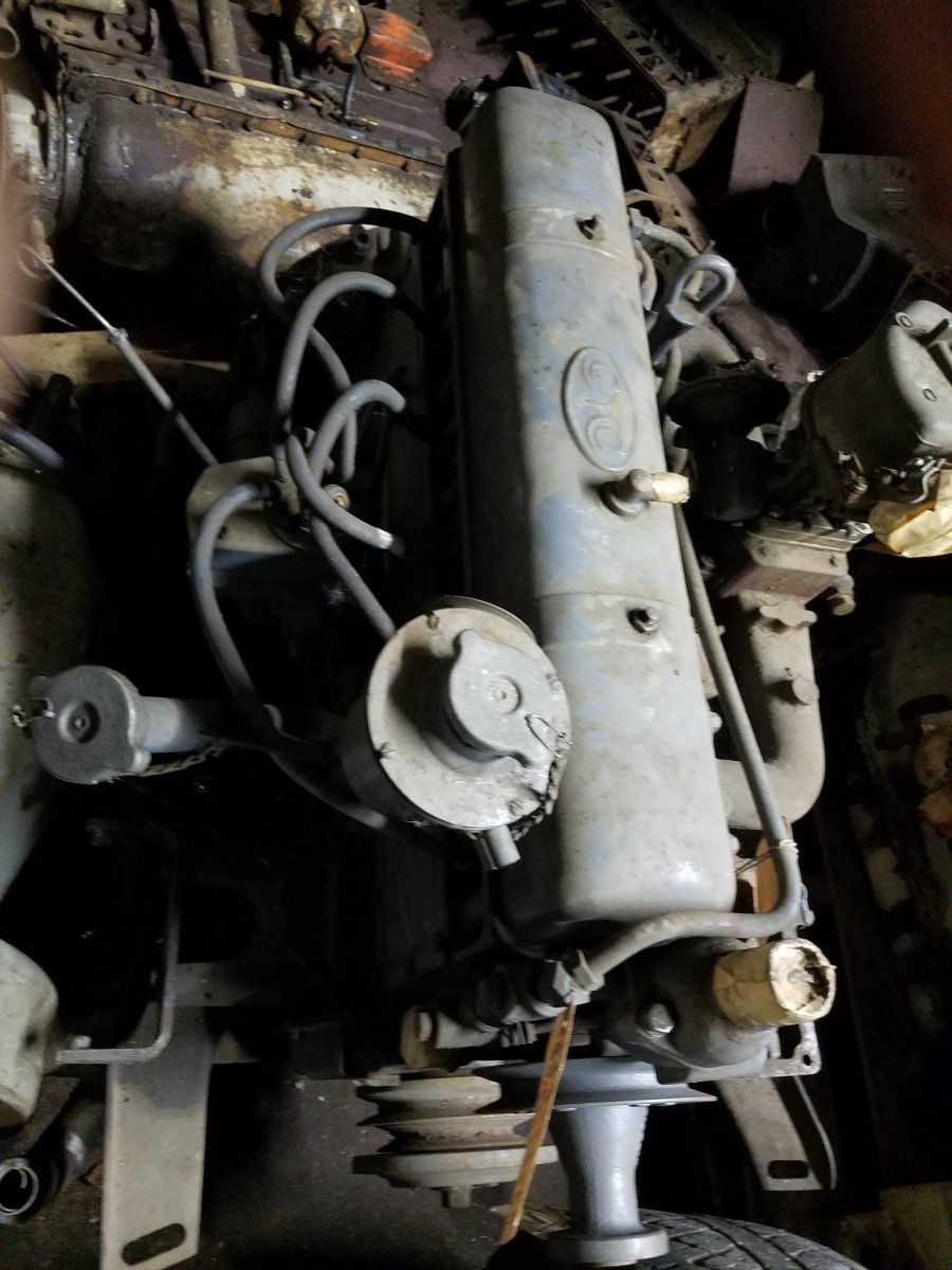

    from Denton
    The motor already has a flex plate on it the trans should not be hard to find. Fords, Lincolns, Hudsons, Packards, Olds, Caddy., Pontiac, GMC and Chevy pickups all used them under different names, even Tank's used them. I have 2 of them 1 out of a Hudson and 1 out of a Nash both are duel range. Check some of the older transmission shops.

    iwanaflattie
    Theres a guy selling an 8qt 248 pan for ur 302..if u dont want it ,ill buy it for mine.
    Also theres a tech where u can get a gm v6 distributor and mod it for a gmc 302..

    from Rome NY
    Thanks for the tip. Ill try and find it.
    Ive read that any inline six distributor should work. Im currently looking for a 235 dizzy. Whatever it is i want a points type
