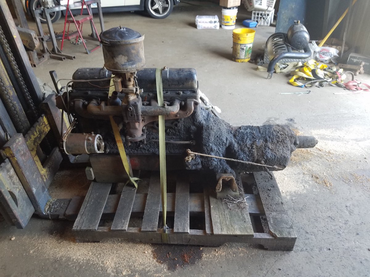

    Slowly making progress getting the 239 out. Just need to pick it now.
    Valve job? We dont need no stinking valve job!

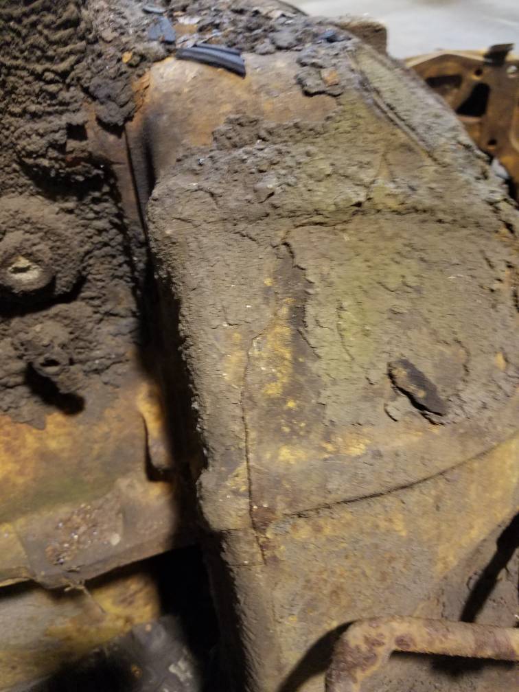

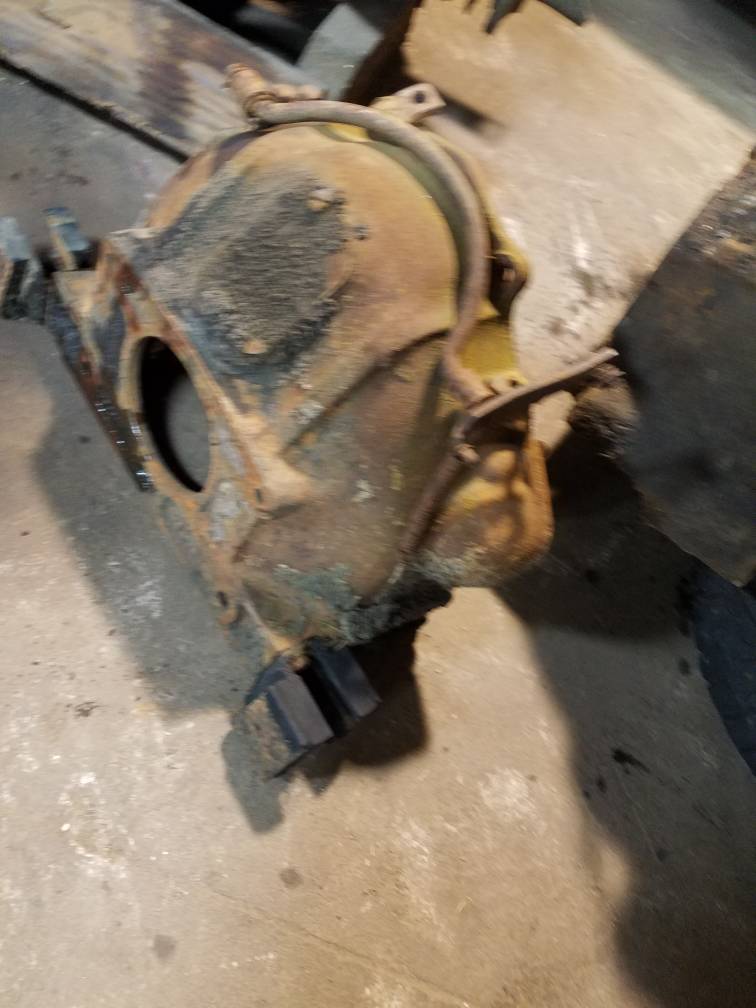

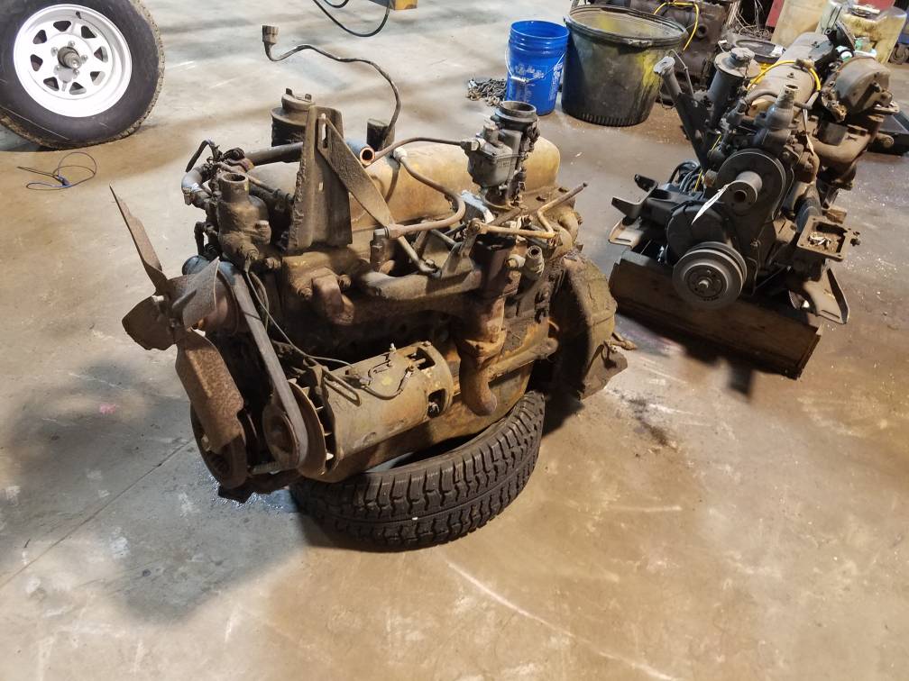

    from Rome NY

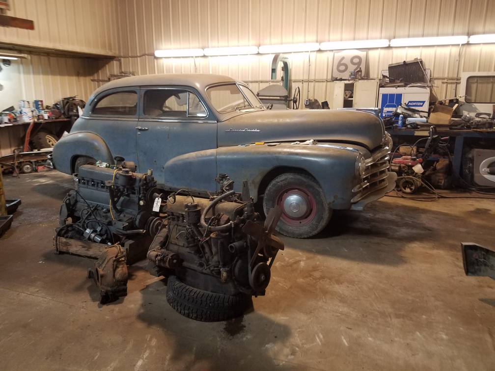

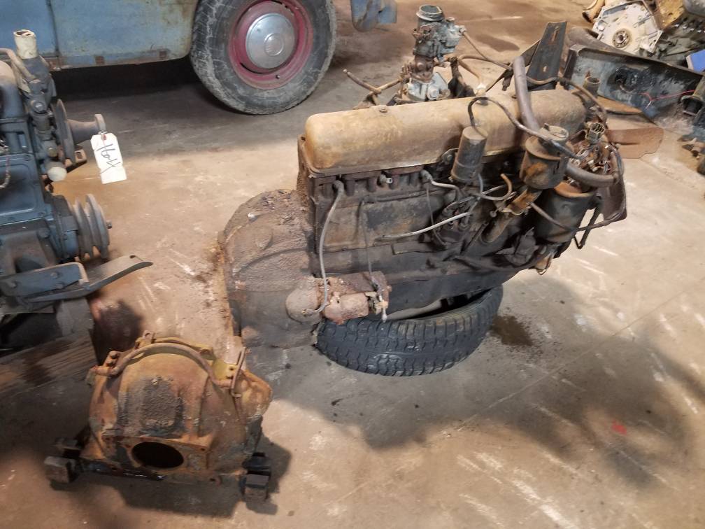

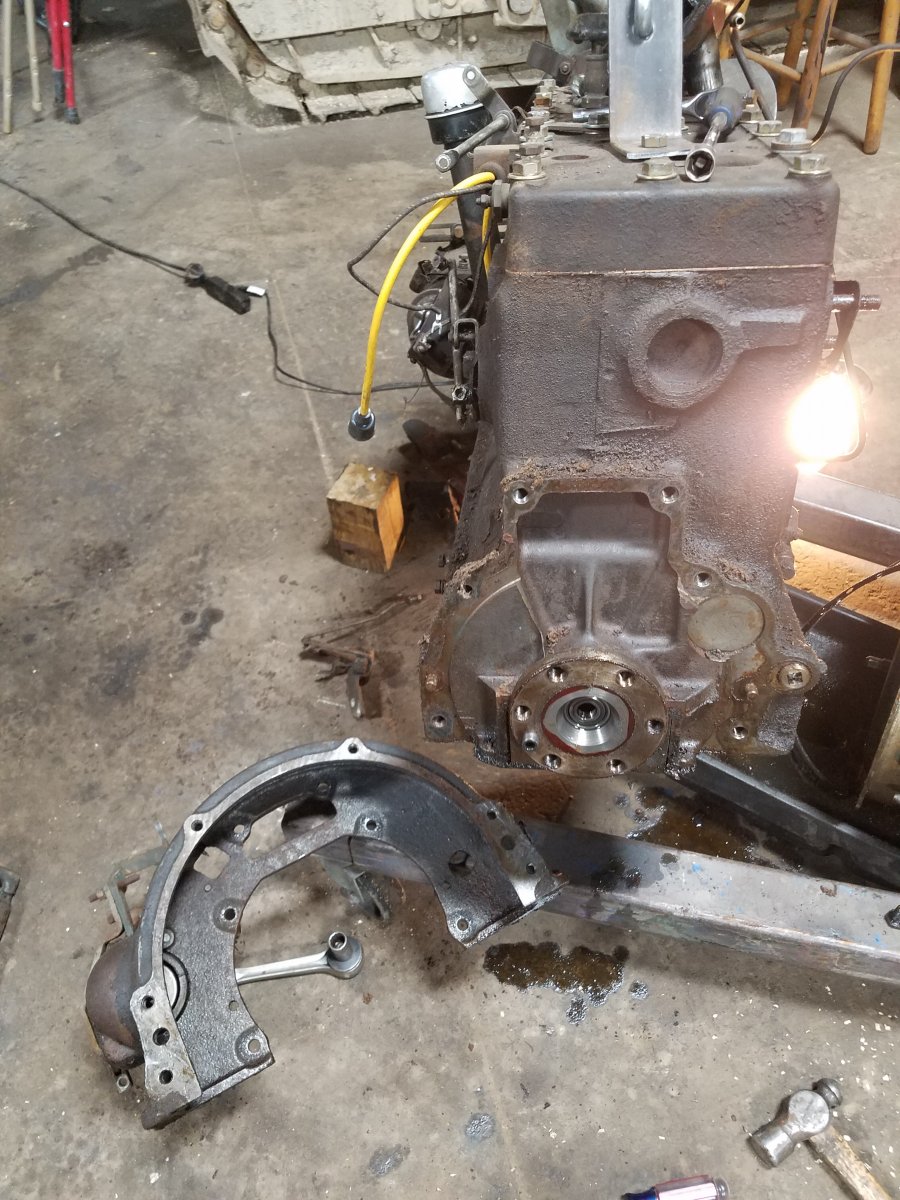

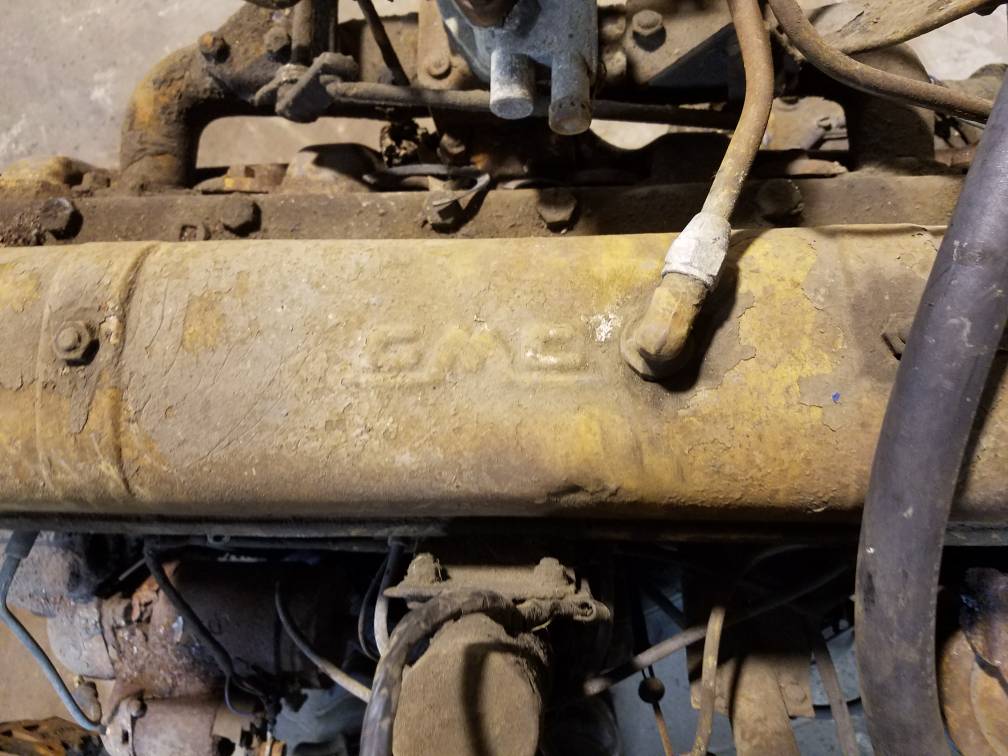

    Finally was able to get the parts engine. The bell on it is broke pretty good from all that monster GMC torque haha. So not only did the man cut his truck in half, and pull the motor BY HIMSELF, he gave it to me, then felt bad about the bell being broke so he took me to his house to GIVE me a good 235 bell!

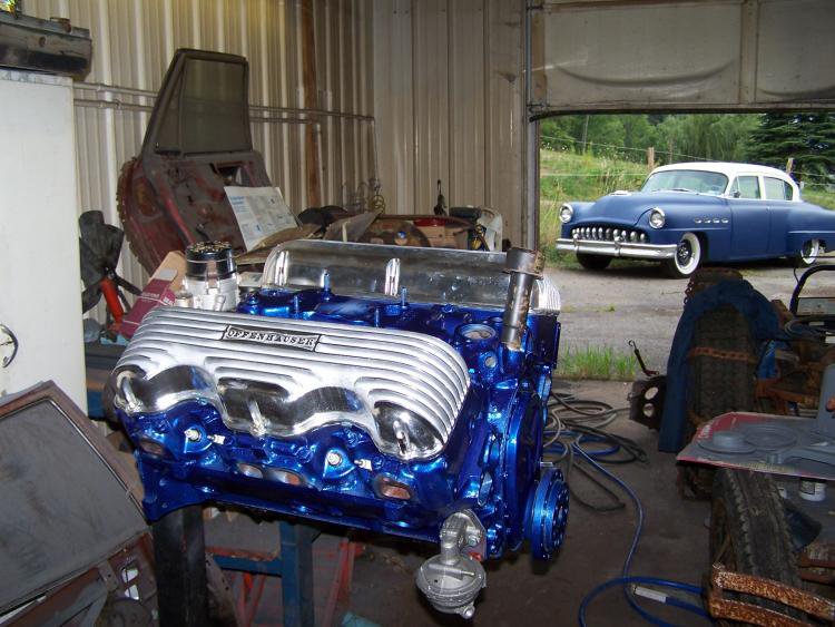

    That is actually just off the shelf Rustoleum. Metallic blue of some sort. I used the same color throughout the dash.
    To be honest i wasn't super impressed with that 409. I ended up taking it out to do some work on it. Put a 283 in there in the mean time and loved it.
