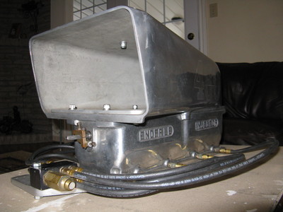

    We did the same as Magooz using a Kinsler surge tank and ran without the dial a jet because we raced it. We've changed to alcohol and removed all of that good street stuff. I've got the tank, dial a jet, Kinsler gas nozzles and a few other parts if anyone is looking

  6. Augie Delgado lives not too far from you. Brea I think. He has a very streetable Nova with Kinsler stacks. I know he says the mpg ****s around town, but had some neat ways to increase it on open roads. It responds quick, and doesn't load up. He runs an electric pump to load a surge tank under the hood (float bowl style). The injector pump takes a feed from there, and then the barrel valve dumps the return there as well. I thought that was neat, you wouldn't have to run a return line nearly as far. Look up that article, I think it had his number as well. My friend Rudy knows him, and he said he builds injector setups and sells parts. He seemed to be a good source. I was looking to do an injector setup on a flathead, so I have been looking around recently.
  7. Running on top of the blower you are not as effected by engine heat and you have no pulses from the intake ports/valves.
    Another setup that is real streetable is a set of Enderly barn doors on top of a large plenum, like say a tunnel ram. Granted they are not stacks but the plenum helps dampen the entire setup.
    I helped a guy setup a hat injection on a tunnel ram in the '90s that he ran on the street as well.
    None of the mechanical injection that we would run on a traditional car is going to be the same as a car or an EFI, it is just the nature of the beast. Even on the track there is a learning curve. Today there are books written by the wizzards, not like it was when people like Lippy and I were trying to figure it out. You either had to make mistakes and learn from them or know someone else who already figured it out.
    Something to bear in mind is that mercedes had injection way back in the 30 or 40s. Not just on their track cars. hell even the highly priced [these days] GM FI that was available back in the '50s is mechanical. But they had to be tinkered with and tunned which is why many of them got s****ped for a carb setup. It seems like most shade tree mechanics are just not up to the task.
    I would like to see more guys learn to run them myself. track or street doesn't matter to me, that way when the older fellas take a dirt nap someone will still know how its done.

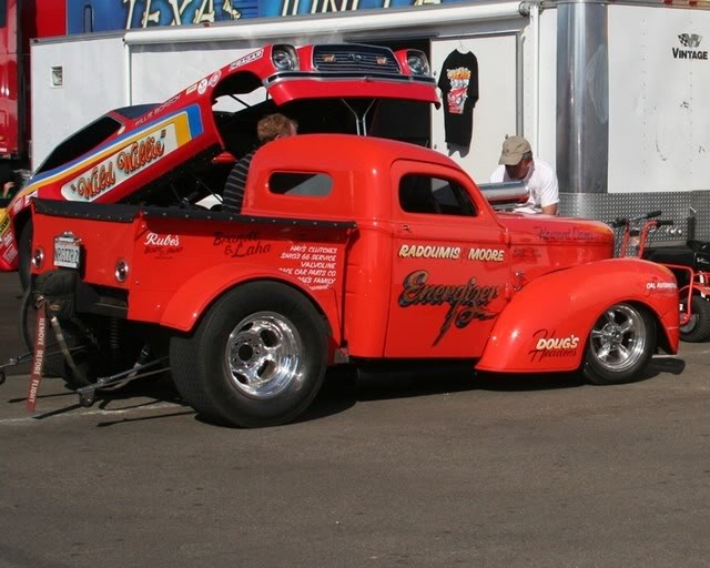

    There are two guys in SoCal (near you) who know how to set these up. Junior Thompson and Ted Radoumis. Junior is more retired. Ted is in Santa Fe Springs and has run, set up, and tuned them all. He raced injected gas, then blown gas for years, and has run mechanical injection on his blown small block (Energizer 41 Willys P/U) for 20 years. He just shakes his head when people say that you can't run them on the street. He is a tech guy at Irwindale Drag Strip and has a long list of cars he has set up, that run on the street. Check with him. Great guy!
    One thing he will stress is that there MUST be a fuel tank above and relatively close to the fuel pump. The pumps are gravity feed and cannot be allowed to run dry.
    Geri Tarvin told me years ago, that the system is EASY, if you read the Hilborn book. That told me there was one.

    what about using a electric fuel injection pump to provide a constant fuel pressure and a barrel valve that was set up for that one constant fuel pressure it works for a electric injector why not a mechanical set up
  21. c322348
    Joined: Nov 28, 2007
    Posts: 343
    c322348
    Mechanical fuel injection uses the change in fuel pressure with RPM to meter the fuel, along with the barrel valve to account for throttle position. With a constant fuel pressure it wouldn't meter properly. It would always sense that the engine was turning a constant RPM.

    but couldn't you build a valve that could meter the whole system at one pressure
  23. Keep in mind that there is nothing shutting off the flow of fuel to the nozzles...ever; so the line pressure is what changes the volume of fuel delivered to the cylinders. Metering fuel at one steady pressure is an entirely different type of injection.
    This has been batted around many times before, but I'm convinced that a vacuum controlled byp*** valve is the key to making a Hiborn work well on the street.
