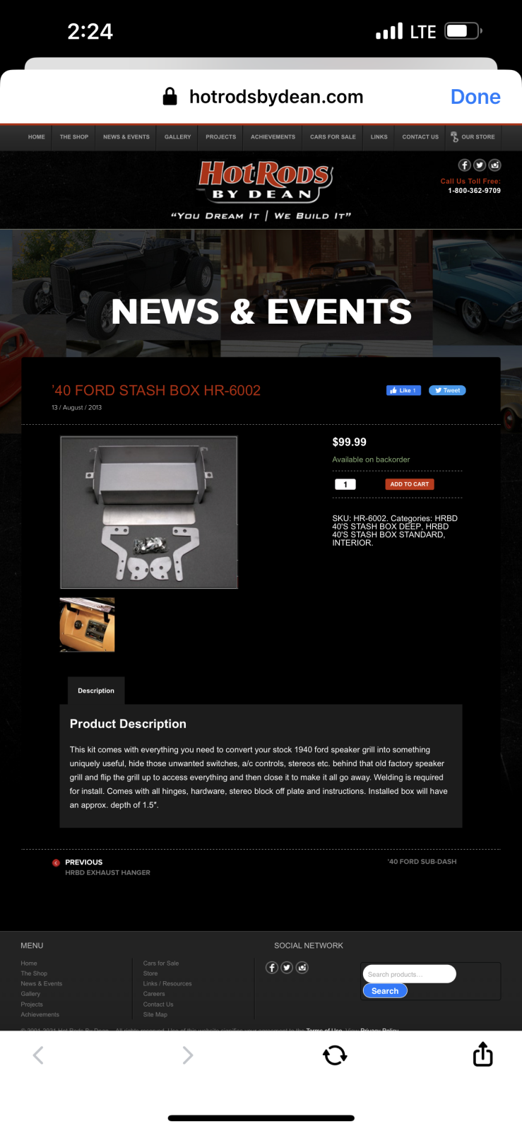

    Believe Hot Rods by Dean makes a kit for this

    Dean calls it a “stash box”

    Dang for 65 bucks for the above mentioned I don't see any reason to try anything else.

    I bought one of these for my 40 coupe project but decided not to use it. For the kit to look finished as shown in the picture you will have to do some welding and body work . The kit was fine I just decided I didn't like that the speaker grill had to be lifted up. I would have preferred to have it drop down. If it did drop down the speaker grill could have been used for a cup holder ( when sitting still!). It also would have been easier to see the radio and work the tuner. But since most radios should work by a remote that really should not have been much of a problem. No I didn't keep it. I sold it to someone else. In retrospect I should have used it. I mounted my stereo behind the seat under the package tray and it is a pain in the **** to get to.

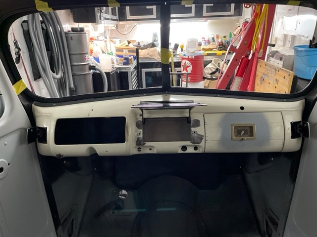

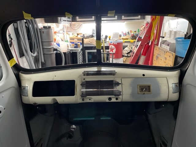

    Just got one in the car dash fitted in my pickup
