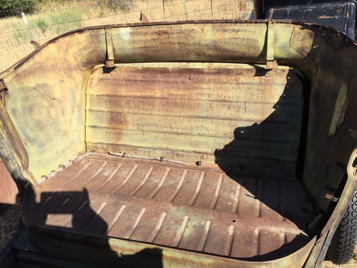

    Bump.... wife told me we had to have this, so now we do...sort of. Have to go pick it up. They said it was 1919-1921 or so. We'll see. pic 1.JPG pic 2.JPG pic 4.JPG pic 7.JPG

    Jack Pine, how about a few more pictures. Might be able to give you a year. Should be a body number on the firewall, gives sequential number of roadsters. Engine number is over carb, would be about 50,000 higher then serial number.
