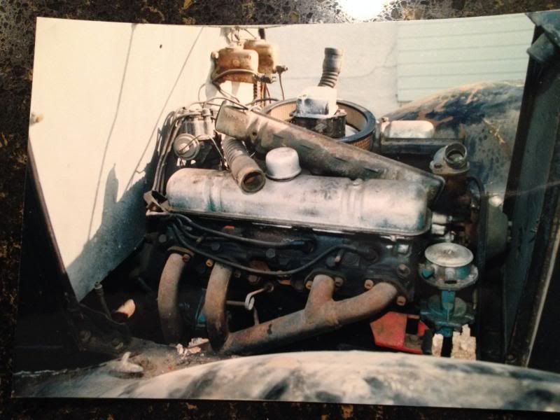

    Guys, thanks for all the nice comments and feedback. Today I finished up some shelving to get more parts off the ground and then decided to go through a few boxes of Rodders Digest archive information and other photos that Steve had. I did find some more information on the '32
    First is a picture of the motor when the car was pulled out. My Dad thought the hanging pedal****emblies were 57 Ford that were chrome plated and the master cylinder and clutch cylinder were chrome plated too. You can barely make out the hole in the side of the head from freezing, you can see the Hurst Mounts, and the Header ( more on that below)
    Here is the Header, Steve could not find the driver side, If anybody know the manufacturer, or has one. Let me know, if not I can duplicate it,

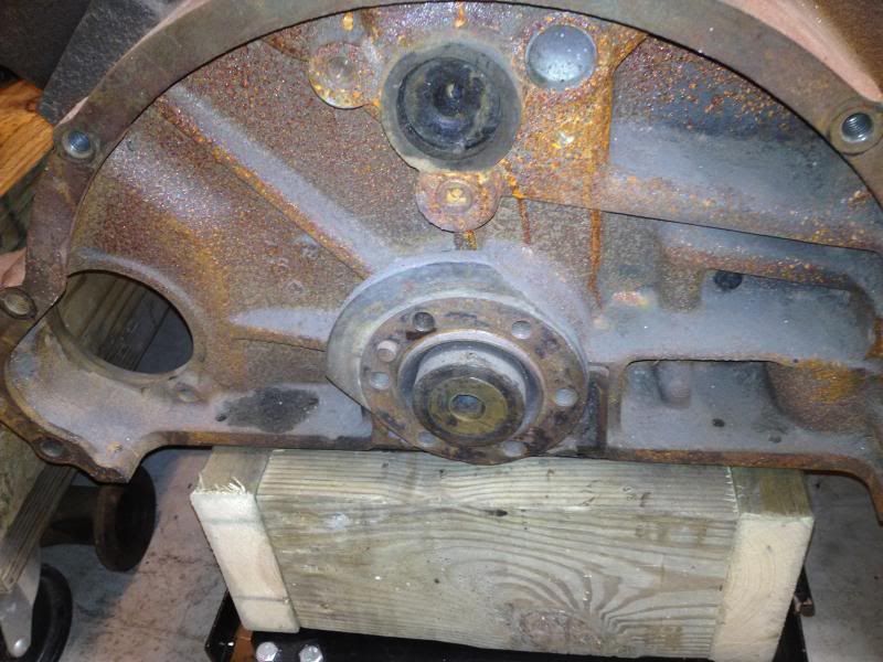

    The Red******* is the transmission. Steve must have picked this up converted, as it is not the******* that was in the car originally.
    Based on the input shaft overall length (6.75") and based on some quick measurements the shaft may be 5/16" too long, based on where the bushing sits in one of the engines today. It appears this could be pressed in farther or machined some to reduce the thickness.
    Based on the where this bushing resides it appears I would have slight interference. I'll verify the measurements and fit the parts up as well.
    I 'll do some digging on the candlestick to see if I can find one in the parts.
    Crank from the other motor without a bushing, looks like I could go deeper into the crank if needed.
