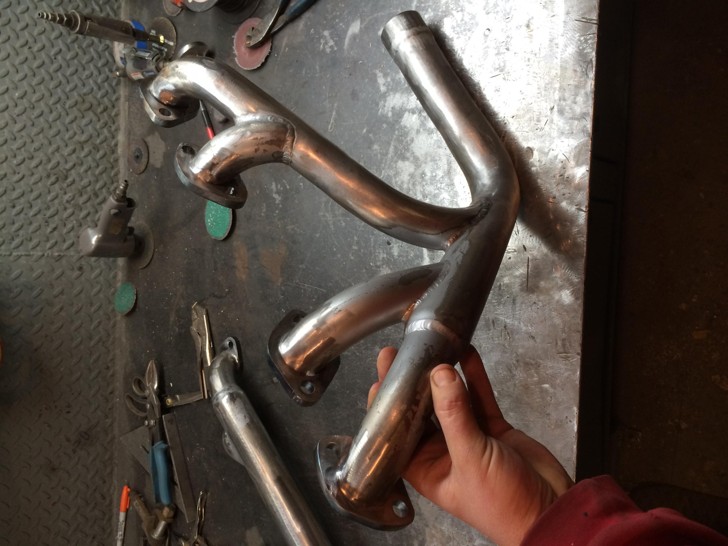

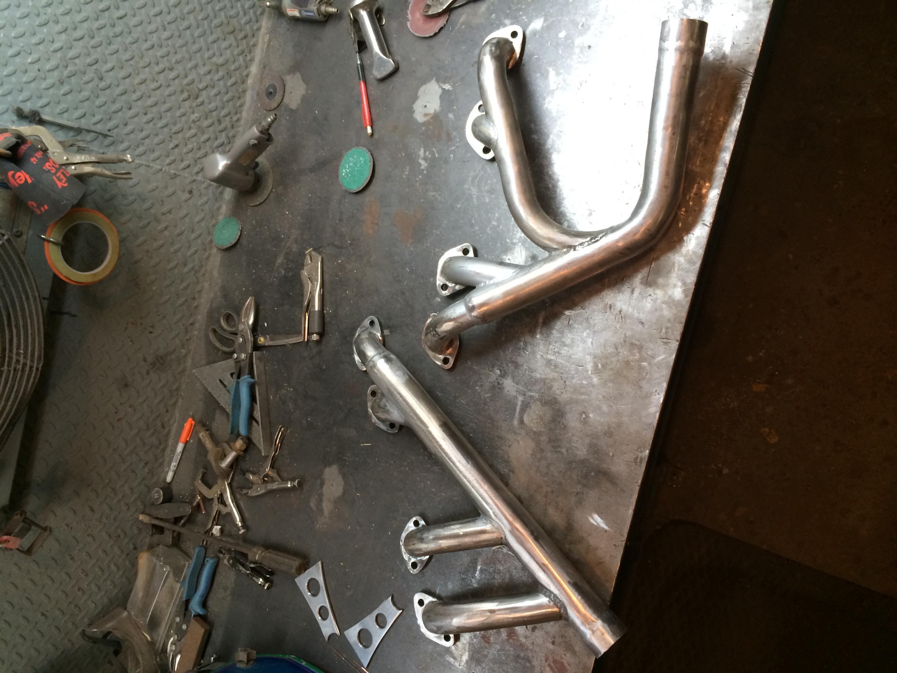

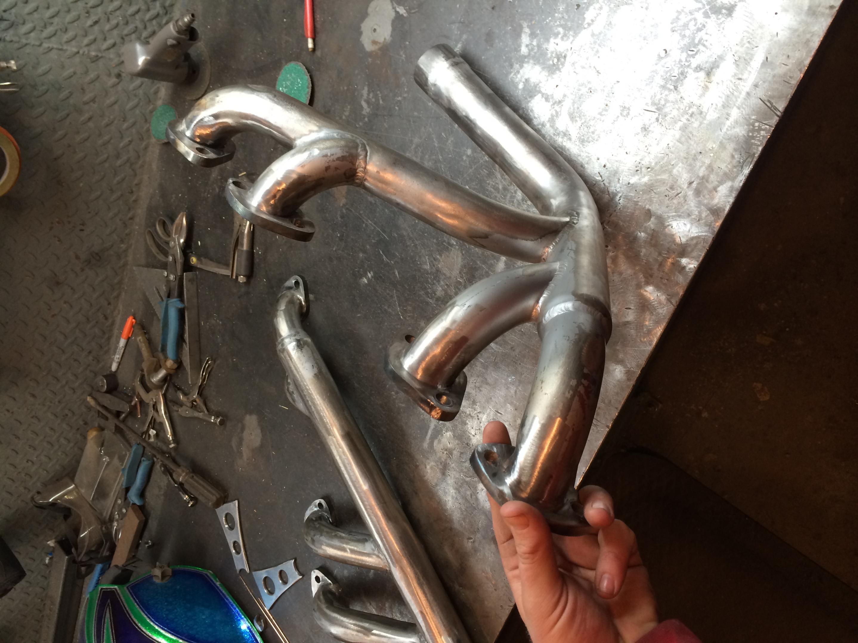

    For the front upper shock mounts I'll cut down some F-1's and weld them to a square plate that will bolt to the frame. I have So Cal Bell style tube shocks coming, and will use them on the rear, though I am not quite sure where and how I'll mount rears yet...Space is pretty tight.
    I have some ideas for a set-of headers that will be unique, and traditional looking. These will be inside the frame Lakesters with a tapered cone from 1.5" to 2.25" that will snake down between the frame and split bones....Space is really damn tight.

    I finished up some front shock mounts. These were Dodge mounts similar to F-1 that I heated and reformed the rear legs, bent them out at a 45 degree angle and then added a front leg (from an F-1) to pick up another mounting point. The rear two mounts will be bolted through bungs welded in. Something a little different and should be plenty strong.

    Here's another picture of the driver side mount. I have all the pieces to start the firewall and headers now..
