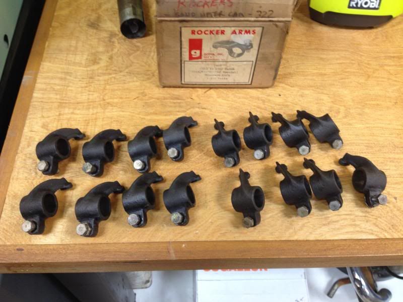

    I've been researching parts and suppliers, and talking to the local machine shop about building the nailhead.
    If I decide to use the Gotha rockers I have one that is roached, and a few where the adjusting screws seem loose.
    Maybe they would take them back, there barely used, I don't have the receipt, but I have the box they came in.:rolleyes:
    This is the rough one. Looks like it back off and got mushroomed a little. Could still be useable.

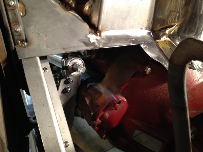

    A few updates. I decided to make a column support that mounts to the ch***is instead of the lower firewall. Mostly due to clearance of the rear most header tube. This provides a nice support for the u-joint.
    The brackets have a slight lip rolled to give them a little stiffness and better form.
    Here's a shot with the firewall back in. The rear header tube will pretty much conceal the u-joint. Header clearance will be tight.
    Heres a shot from the inside. I made some 2 3/4" risers to mount to original toe board mounts. This allows the pedals to come up a little higher which is necessary, as at the original floor height the brake pedal doesn't quite clear the bellhousing.
    I need to make a lower column mount, but the u-joint will be just under the floor level and it is operating within it's angle limits.
    Now I can get started on the headers, and I think a mini-starter may help with the real-estate too.
