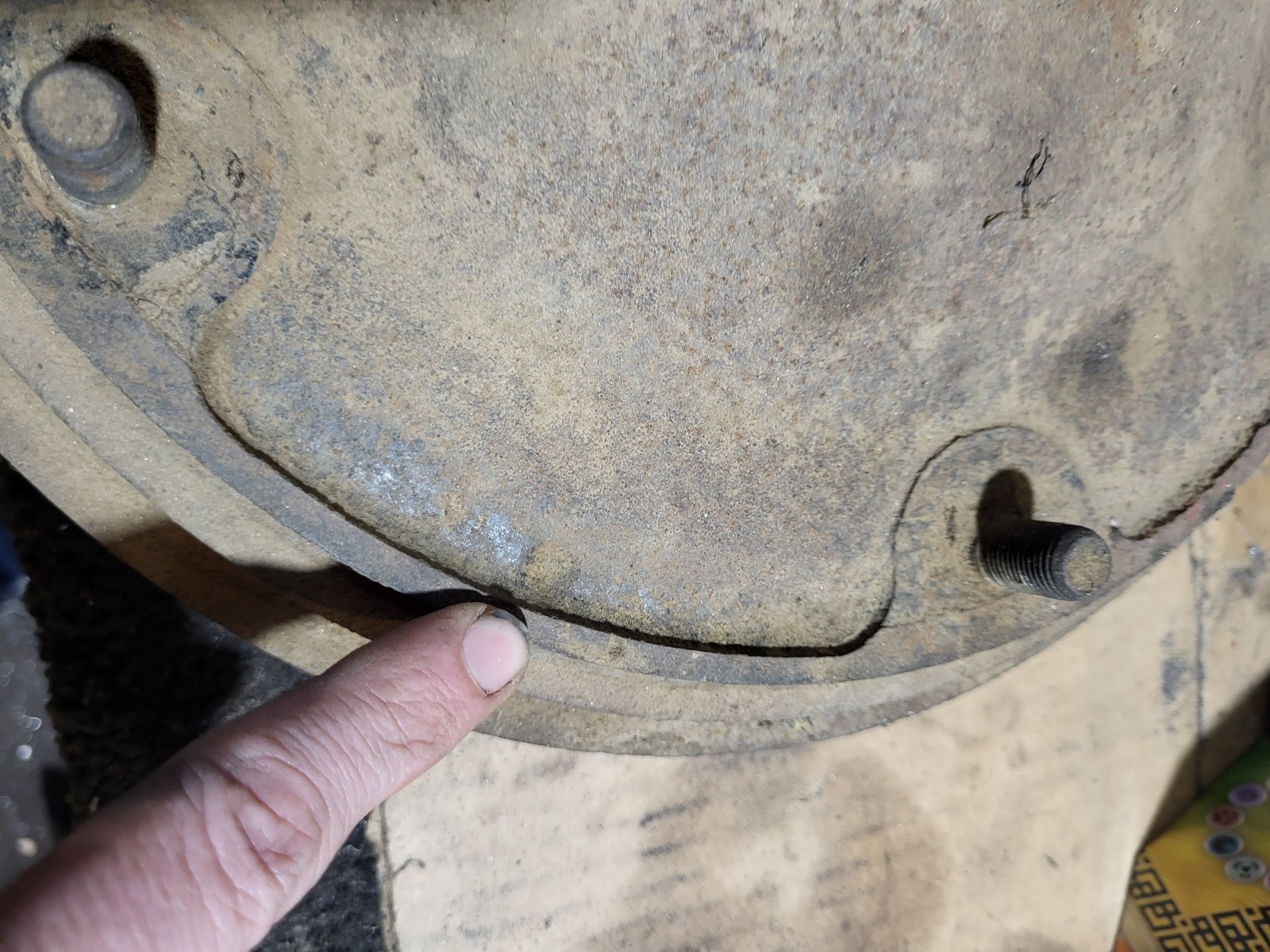

  16. wheelkid
    Joined: May 25, 2006
    Posts: 1,263
    wheelkid
    Alliance Vendor
    from Fresno, CA
    Is this the dimple you're talking about? If so, It's there the clear the hubcap clip rivet on the early wheels. Later wheels used a countersunk flush head rivet but the early ones use a round head that protruded from the back of the wheel and would interfere.
