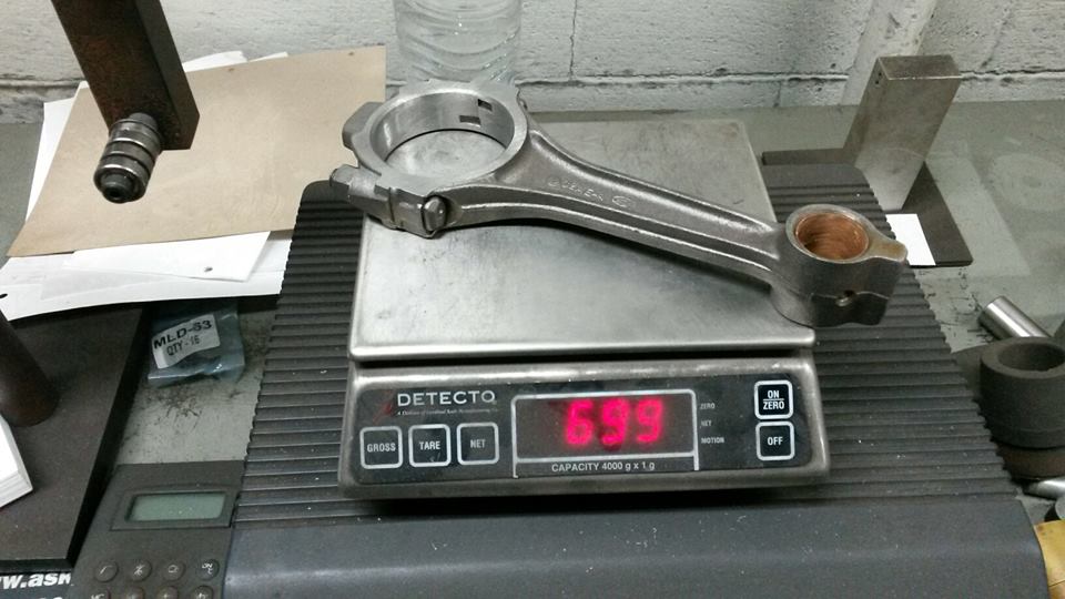

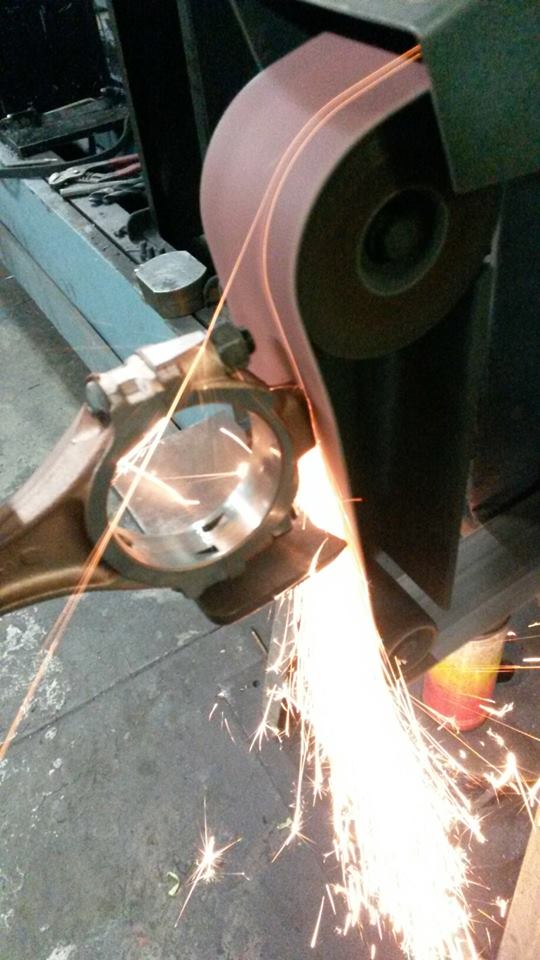

    Balancing con rods, always do the big end first. Weigh all, find the lightest and make them weigh the same by grinding or cutting.
    Once the big ends all weight the same, check all the rods for total weight and adjust to the lightest by taking the weight off the small end only. By doing this you make the "rotating weight" and "reciprocating weight" the same on each rod.

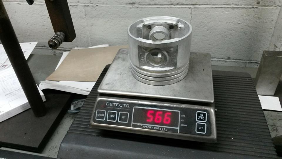

    Once all the rods are done weigh the pistons and adjust the weight on each to equal the lightest.

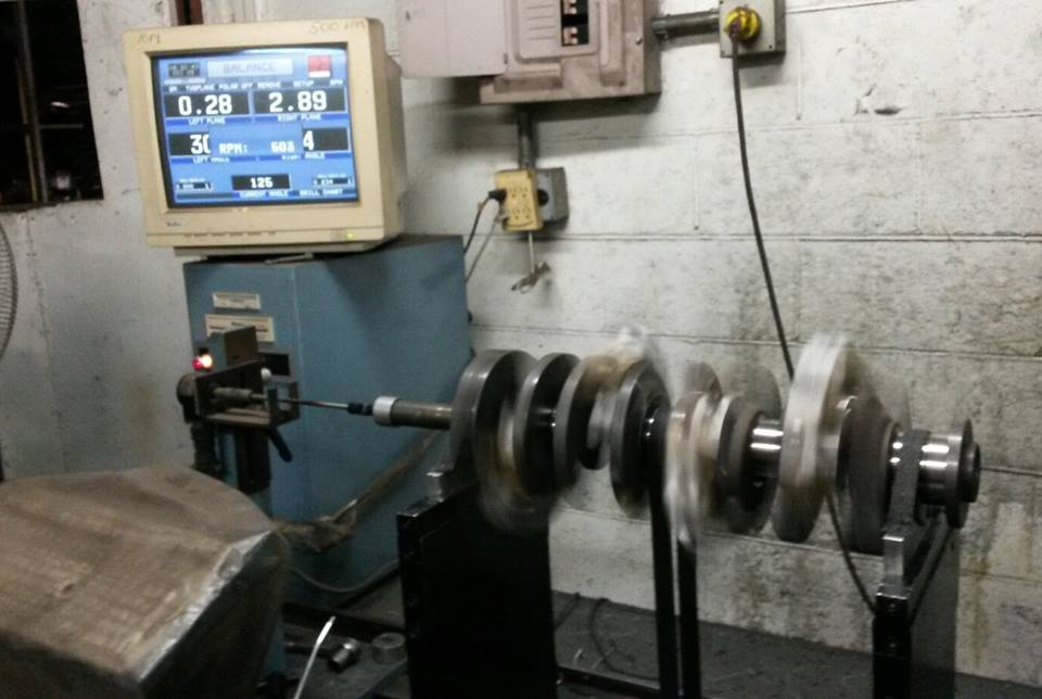

    After we get the rods and pistons to equal weight we add the rotating pieces (big end and rod bearing) together, add the reciprocating pieces together (small end, piston, pin, locks and rings) Then add 50% of the reciprocating to 100% of the rotating and use this number (in this case 2024 grams for two rod/pistons for each throw) to make our "Bob weights". Then we attach them to the crankshaft as shown.
    Finally we spin the crank, remove weight (in some cases add) where indicated till the machine indicates as close to zero front and rear as possible.
