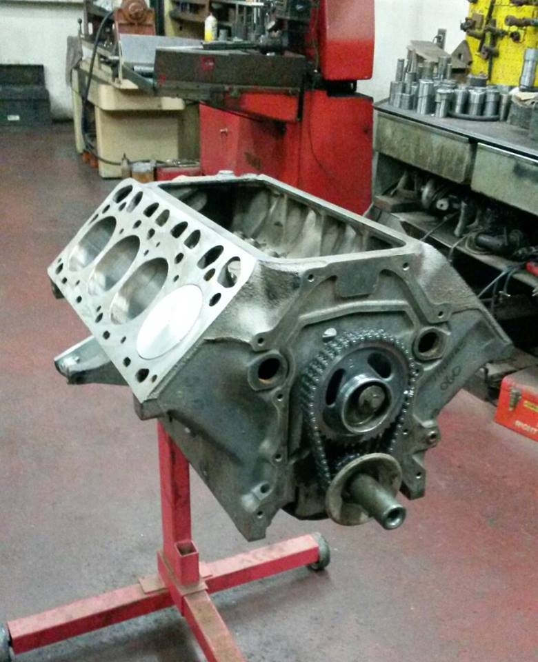

  5. Today we work on Thomas' heads. First off cut the guides down for positive seals and clearance for extra lift on the cam.
    Next we cut out the old exhaust seats so we can install hard steel seats to last longer with the dry unleaded fuel of today. Just the exhaust, the intakes work fine as cast iron.
    Last we cut the seats. All three angles at once on this Serdi "live pilot" seat and guide machine.
    Cut a fresh surface to seal the head gasket better.
    Heads are ready to go together now but will have to wait as I didn't receive all the parts needed to ***emble. Monday hopefully.
    In the mean time I ****oned up the bottom end with a fresh rebuilt "gearotor" type pump (moves more oil than the "spur gear" type and no cavitation at high rpm) Finish up with a Ford Red paint job.
    Done for the day, time to head home and get ready for the "Eagle field Christmas Party".
    See ya later. :)
