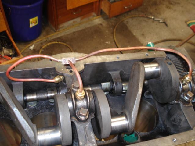

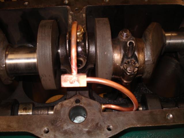

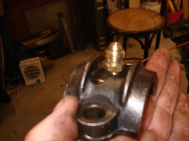

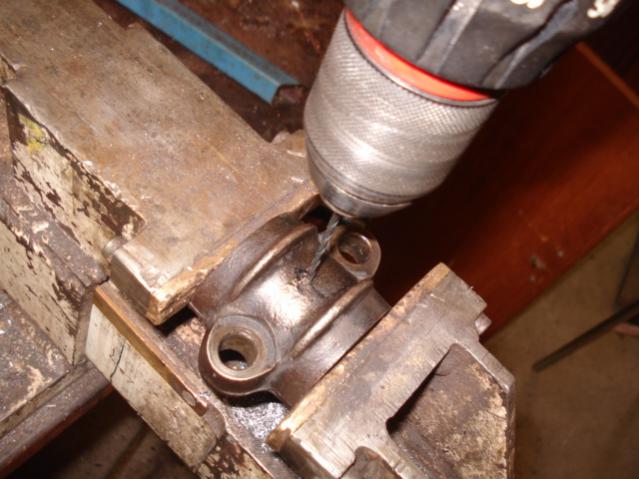

    I don't know if I have done this right but it seems to work, Pressurised bearings in a banger No1
    If you need details,Post

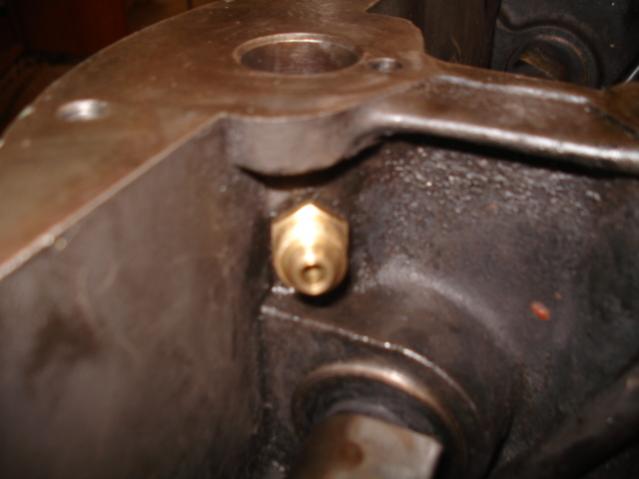

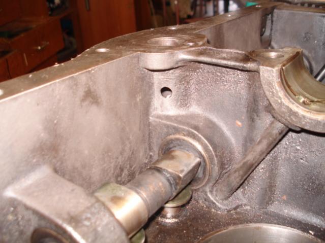

    Bearing pressure No 2

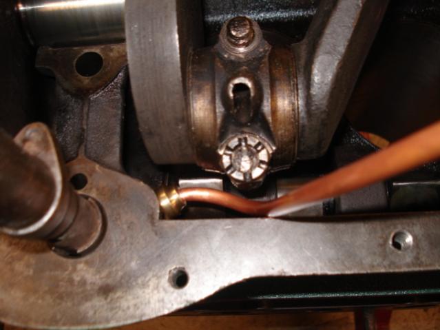

  9. having done the same thing on my T motor, I understand what you are trying to attain. But, I used compression fittings through out the system as copper has a tendancy to become brittle and break under normal circumstances, but this can be exacerbated when heated for brazing. But I could be wrong.
    The difference is that I came in through the top of the main bearing webs. having that bend in the line combined with the line just "hanging" out there is going to cause failure down the road.
    Maybe using HDPE or LDPE hose, brass fittings, and clamps might work better. certainly less prone to failure.

    Are there intructions availble that shows how to do this properly? including the block / oil pump mods. I am very near doing this myself and don't want to destroy a rebuilt engine.

  13. The first issues of the S O S S magazine go into plumbing and oil pump conversion. The Restorer #5 has detailed instructions in an article by Urb Stair on his method of plumbing. As to copper tubing it is prone to work hardening and cracking at the fittings on long unsupported runs or lengths. I had a friend that used to work at an airfield in the "30"'s and he received flying lessons by working Saturdays annealing the copper oil lines on the old radial engines in use at that time. We used to replace the fuel lines with copper on our "A"'s and they would eventually leak at the compression fitting at the filter. The fittings would crack at the ferrule and we would wrap string around the ferrule to get home.

    I would like to know what mods need to be done to the oil pump to pressurise the bearings, I put a guage on the side of the block and it seemed to have oil pressure when I ran it.
    If some one could post the article from soss it would help.
    Thanks Brendan

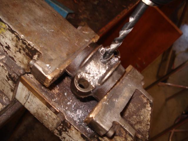

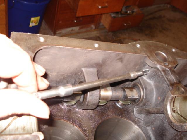

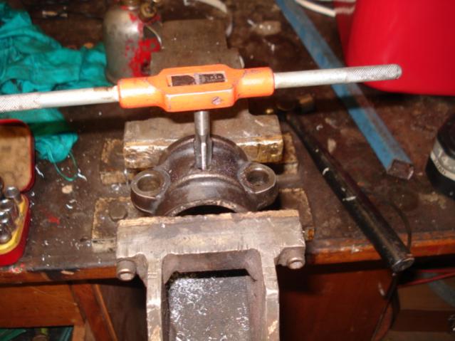

    Brendan1959-
    There is one other consideration that many people don't realize when pressurizing blocks, and that is that it is much better practice, from the bearing lubrication standpoint if the oil is fed into the least loaded side of the bearing, in the case of mains, the top. You are better off replacing the stock Ford tubes to the mains with heaver wall steel tube. I have fed insert bearings through the bottom, but cut a oil channel in the block, so that the oil went around the outside of the bearing shell to the exit hole in the top of the upper insert.

    thats a great idea herb.its amazing what you learn on this site.is it also an advantage to widen or taper the oil galleys on the stock babbit (for a high rpm banger)thanks dave

  27. The pump modifications are to increase the volume of the pump. The stock "A" pump can pump 100 Lbs. pressure as is. PM me your email and I will scan and email an article to you. There are a series of articles in the volume # 1 # 1 and 2 of the S O S S . In fact there are several articles on this subject out there. In the Restorer #5 Urb Stair describes how he used a SBC pressure relief valve in his conversion.
