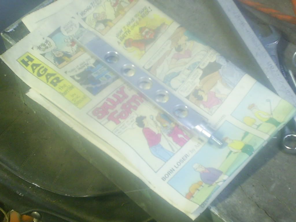

    here's one i'm working on,will be a tall shifter instead of a short shifter. about six inches higher then stock. still need to make the steel brackets that get welded to part of the original shifter. have a regulation goofy cue ball coming from egay, then i have to drill it and epoxy in a threaded steel insert. some people think it's not strong enough,but i drilled a test one,put it in a vise,and i couldn't bend the thing. that aircraft billet is strong stuff. this was made from a round bar. [​IMG]

    well the shift arm is done, won't mention car since it's a non hamb car, but ended up cutting off the factory top of the shifter, slotting it and grinding with a sanding belt, then fitting steel in the split halves and welding it in. then it's bolted to the holey part with AN bolts. was fun to weld the steel without melting the counterweight, lots of wet towels on it. still waiting for my goofy cue ball for my shift knob. [​IMG]
