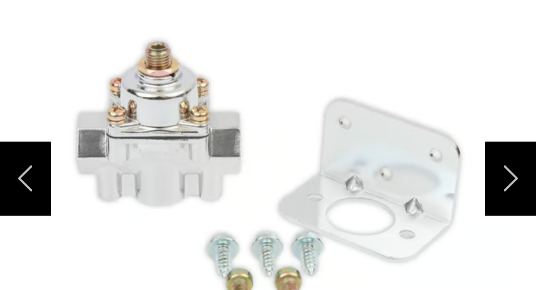

  1. Wtf!!!...so, after striking out with one of the useless Mr. Gasket "dial a flow" type regulators...I went with one of the Holley 12-804 regulators. Supposed to be good for 1-4 psi. It's trying to regulate the fuel pressure from a stock style sbc mechanical fuel pump feeding 3-2G carbs (trying to hold to 2.5psi)...the mechanical pump is delivering around 7 psi.
    With the Holley regulator installed, the fuel pressure was still drifting anywhere from 0-5.5 psi, so, I bought and installed the rebuild kit. Same result! I've set the pressure to 2.5 psi...next time I look, the gauge could read near zero, re-set to 2.5. Then I'll be driving along, come down to idle in gear and notice that I have the running rich "big cam sound and rough idle"...check the gauge and it 'll be at 4.5 -5 psi. Is there fuel pressure regulator (or brand) that actually does what is intended?

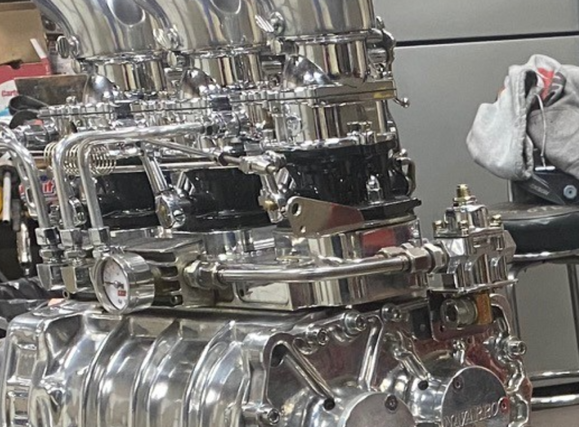

    You would think there would be one regulator in the Holley line up that can take high pressure, reduce it to 2-3 PSI, and have a return line, all in one piece. If it exists, I haven't found it, so I do the "step down" thing with 2 regs.
    12-841 on the frame rail with return line, reduces line pressure from Walbro in tank pump to 4.5 - 9. (why the hell is that fitting blue?)
    And the 12-804 I mounted on the back of the blower for the 97s 2.5 PSI.
    That's a couple hundred dollars in regs but it works. Not saying it is your problem but since you have gone through 2 regulators with the same issue, it very well could be.
