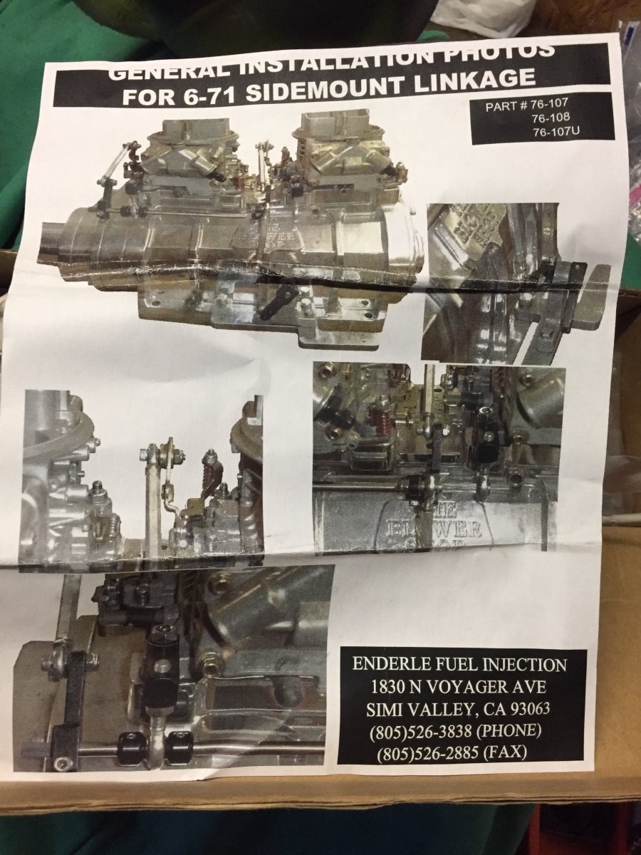

    F3680A10-6856-405A-BAE0-86A32B9CDD62.jpeg So now I have a whole nother dilemma
    I open my box with the linkage to start setting it up and this is what I have.
    It was supposed to be inline style.
    This guy I bought everything from really isn’t doing me any favors here.
    Deuces likes this.

    FTR: You can boost reference Carters and Edelbrocks.
  8. 427 sleeper
    Joined: Mar 8, 2017
    Posts: 3,367
    427 sleeper
    The good news is... inline linkage is CHEAP! [emoji6]
    Sell the side by side linkage and you could probably buy 10 inline kits!
    kadillackid, Deuces and swade41 like this.
  9. swade41
    Joined: Apr 6, 2004
    Posts: 14,474
    swade41
    from Buffalo,NY
    Or get a hex shaft that's long enough to go between the carbs, use the heims out of the kit to go onto each carb and buy a throttle cable which you needed to buy anyhow.

    Ok looks like I just need to make or buy a couple hex shafts
    Seems like the rest of the kit is the same.
    That sure makes me feel better.
    Seems like this has been spiraling out of control $$$ wise
    I was told when I bought it it was a complete setup ready to bolt on.
    Not so much! But I’ll get it on there come hell or high water
