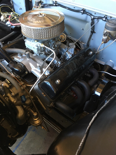

    What intake manifold?
    or...how about a picture of the mill?

    your pic shows no water in the engine, are you running coolant thru it now? Also your heater hose is installed incorrectly. Again doesn't solve your issue but doesn't help.

    Here is a pic of the p***enger side, also if your wondering why I got a orange hose on the filler tube it's cause the blow by shoots oil onto my firewall. Yeah yeah, the engine is tired. But it's all I got till my 50 sedan is finished.
