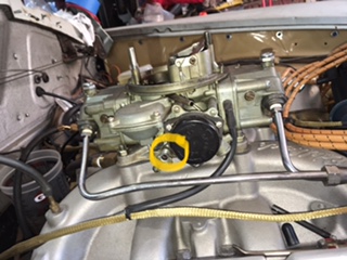

    I recently installed a 500 Cadillac into a 49 Hudson. I used a Holley 780 ontop of an Edelbrock aluminum manifold.
    They carb was in great shape and mounted on another car of mine with a SBC.
    Problem is the carb had a choke tube that ran from the side of the carb (circled in pic) to the exhaust manifold.
    What can I do to get the choke to work since the caddy does not have a place to put the tube?
    Edited photo because I had attached wrong one.
    BTW….would like to have automatic choke work.
    Thanks

  2. You can purchase a choke stove kit. Comes with a heat sink that mounts to the manifold with a hose clamp and has enough steel tubing to do the job.

    Put a choke cable on it.

    is that the correct picture?

    LOL. Jim. No wonder it won't work

    Electric kit … a few bucks and work great.
