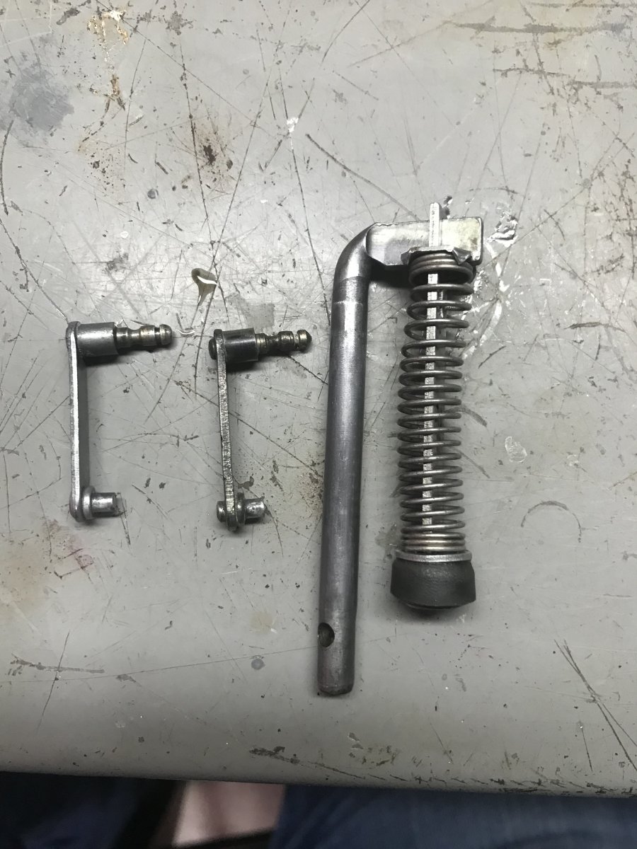

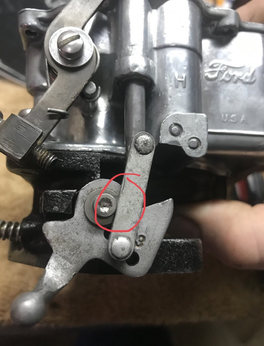

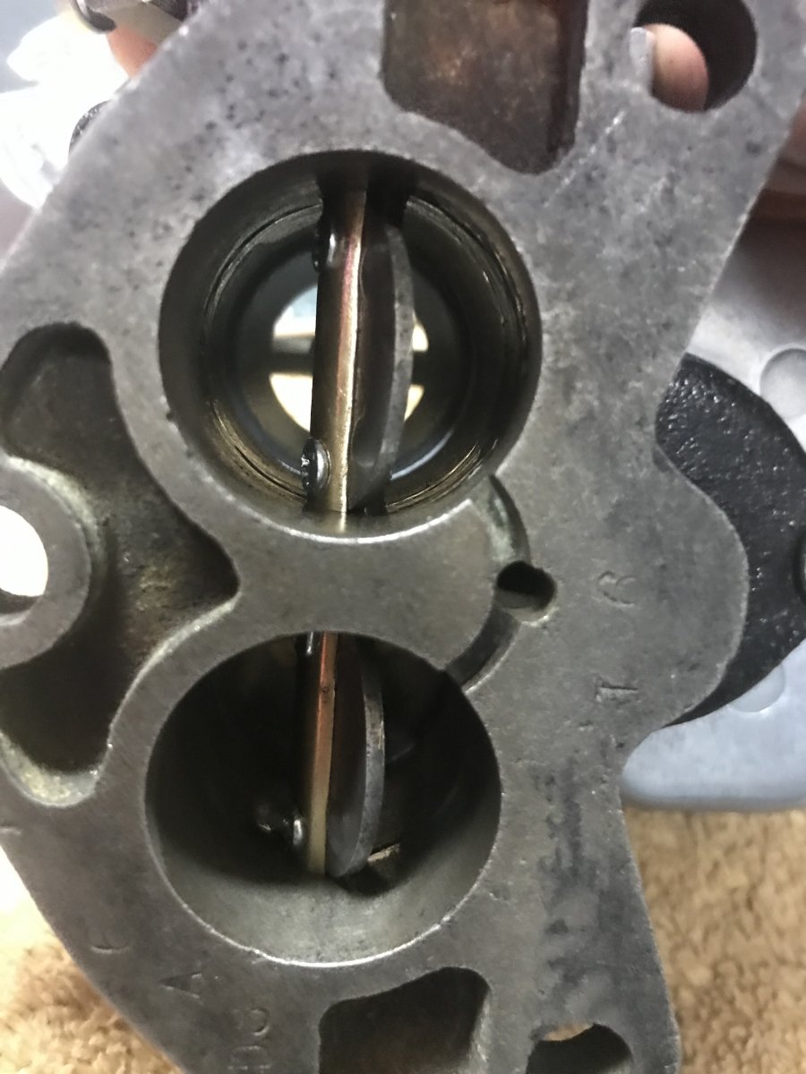

    1B6146C7-2F08-42C1-959A-33C0727C4EF5.jpeg 445F32DC-AB0E-4182-9281-66AAF6BD5DE3.jpeg EAB90B20-1C73-4CB4-8BB8-3465377A798C.jpeg Here are a couple pictures the one has the point of contact circled. And the ****erflies pic shows the aren’t all the way open yet. The last is a picture of the accelerator pump and 2 of the links which look to be the same and interfere the same.

    Nope, Just 'Speedway' parts that are not engineered correctly.
    Truck64 likes this.

    Well I guess the only way to fix the pump rod interface is to do some slight “modifications” which is silly I think. On the other issue has anyone used those accelerator pump return springs that go under the pump to help return it or used any other other methods? Or is this just how they are and a throttle linkage return spring is needed?

    Put a countersunk screw in place of the allen screw. If you don't have the proper counter sink then grind a drill that is just a hair over the diameter of the head of the screw with the correct angle. Be careful when counter sinking the plate that drill doesn't grab. Screw would then be flush. You need to be able to utilize all three holes for tuning. Don't put a spring under the accelerator pump. Just use a return spring on your throttle linkage. Pump moves a different distance when changing holes.

    Or just relieve the link to clear the allen head.

    Old post.... but yes, mine did the same. Used ****on head Allen screws. Cleared fine.
