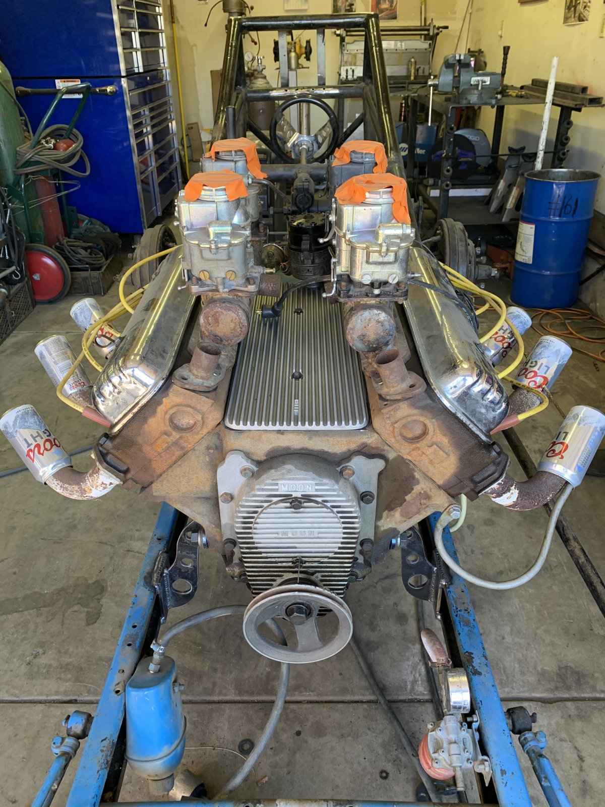

  13. CGuidotti
    Joined: Feb 23, 2015
    Posts: 81
    CGuidotti
    1318AFD1-5CAB-45F3-8F17-E1E3B2B5A01A.jpeg Following...Starting on the same project. Working on this early 50’s rail. 303 Olds with 4x2s
