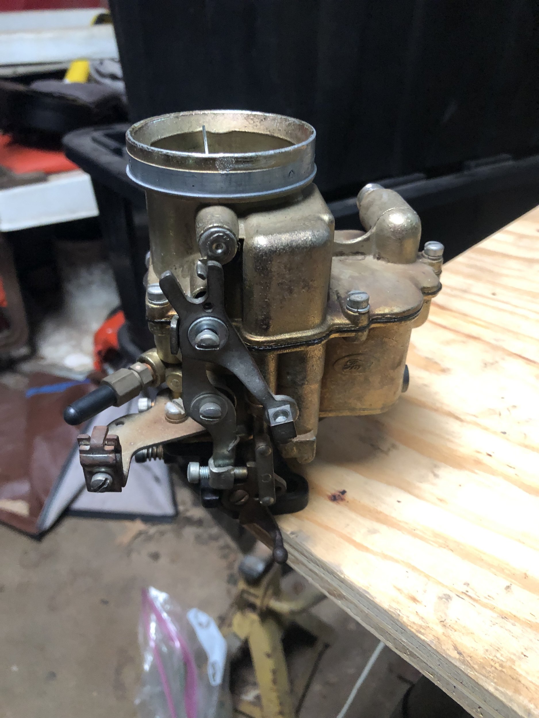

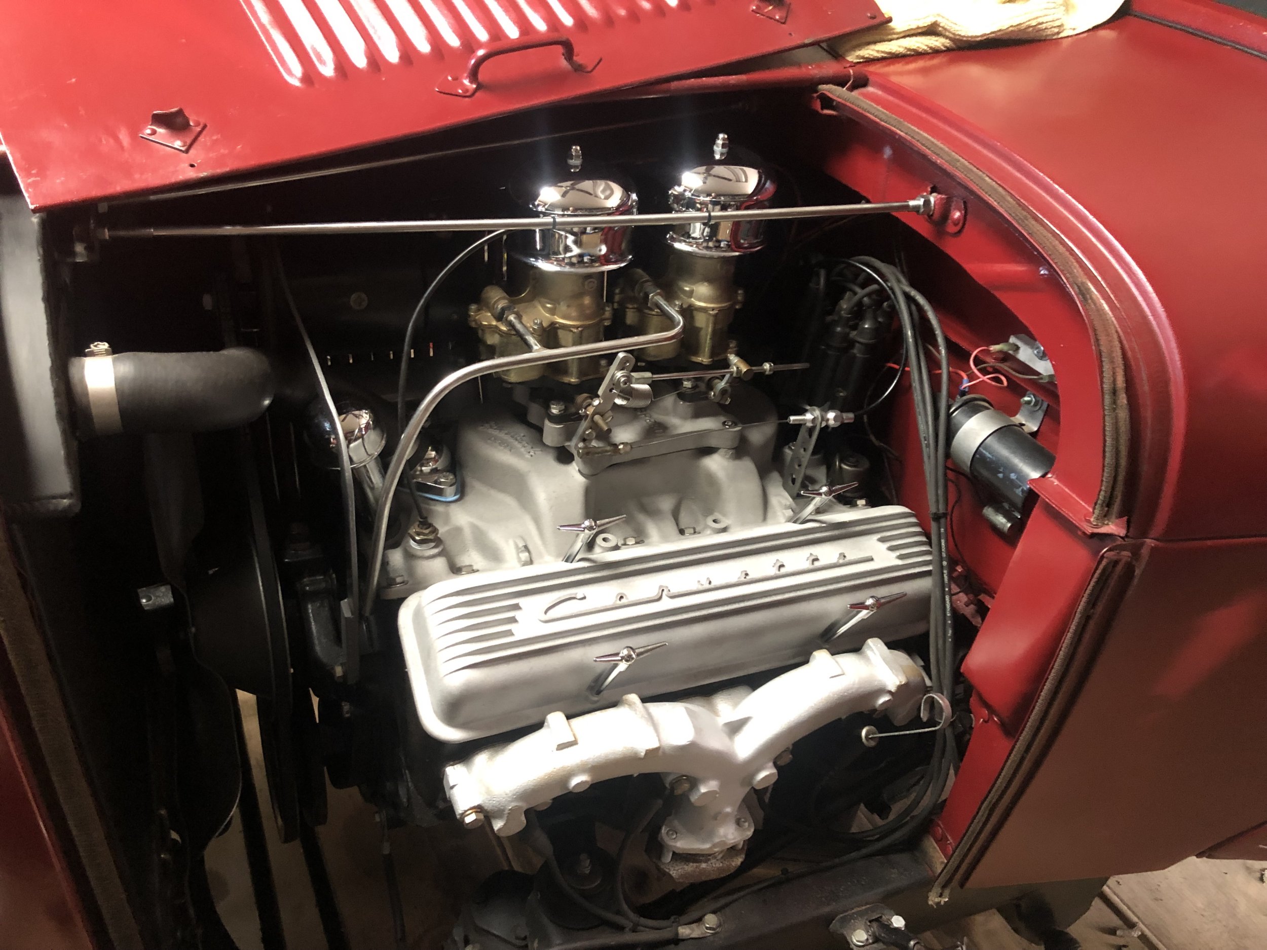

    76504569766__554C7A51-BCFE-431D-BF18-93AE93D295FD.jpeg IMG_6085.jpeg IMG_6086.jpeg Thank you 50mercfan for asking this question, and thank you Bruce Lancaster for delivering me from ignorance.
