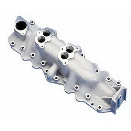

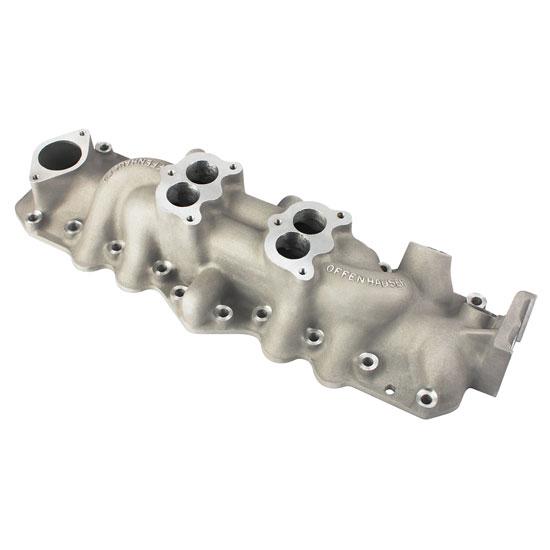

    I am running an offenhauser 1090 style dual
  7. tubman
    Joined: May 16, 2007
    Posts: 8,294
    tubman
    A Offenhauser 1090 is a "Biased" type. They have the extra advantage of being able to run the generator (alternator) in the stock position without extra brackets. I have never run one, because I consider them to be a compromise at best, with more thought given to generator mounting than to fuel distribution. That being said, they are a candidate for using progressive linkage with the front carburetor being the primary. Since it is almost in the stock location, the fuel distribution should be reasonable when running on the primary only. with the rear cylinders getting the lions share of the fuel when the secondary kicks in. If you end up running a progressive, it would be interesting to see how it works out, so keep in touch.

  9. I run a similar setup with two '94s on an Offenhauser street manifold ( front carb is close to the center and the other is offset to the rear). I have used straight linkage as well as progressive. The problem with progressive is that the secondary carburetor throttle plates will stick in the bore if you shut them completely. If you don't shut them completely they will bleed air and mess up your idle and low speed operation. You can buy new throttle plates with special bevelled edges to help with this. Instead I went back to the straight linkage. Performance is great that way. I definitely use power valves in both carbs. I have tried running with one or both plugged but it works best with both power valves.
    Now as to the question of unequal fuel distribution, take a look at a 6 or 8 cylinder inline engine with a single carburetor and you will see very uneven manifold spacing but it doesn't seem to affect performance. Actually it does have a small effect. I read an article comparing performance of flathead manifolds and the super dual outperformed the street manifold by a very small margin. I doubt that you would even notice it at the seat of your pants. So try the progressive linkage with your setup without worries about fuel distribution and have some fun with it.
