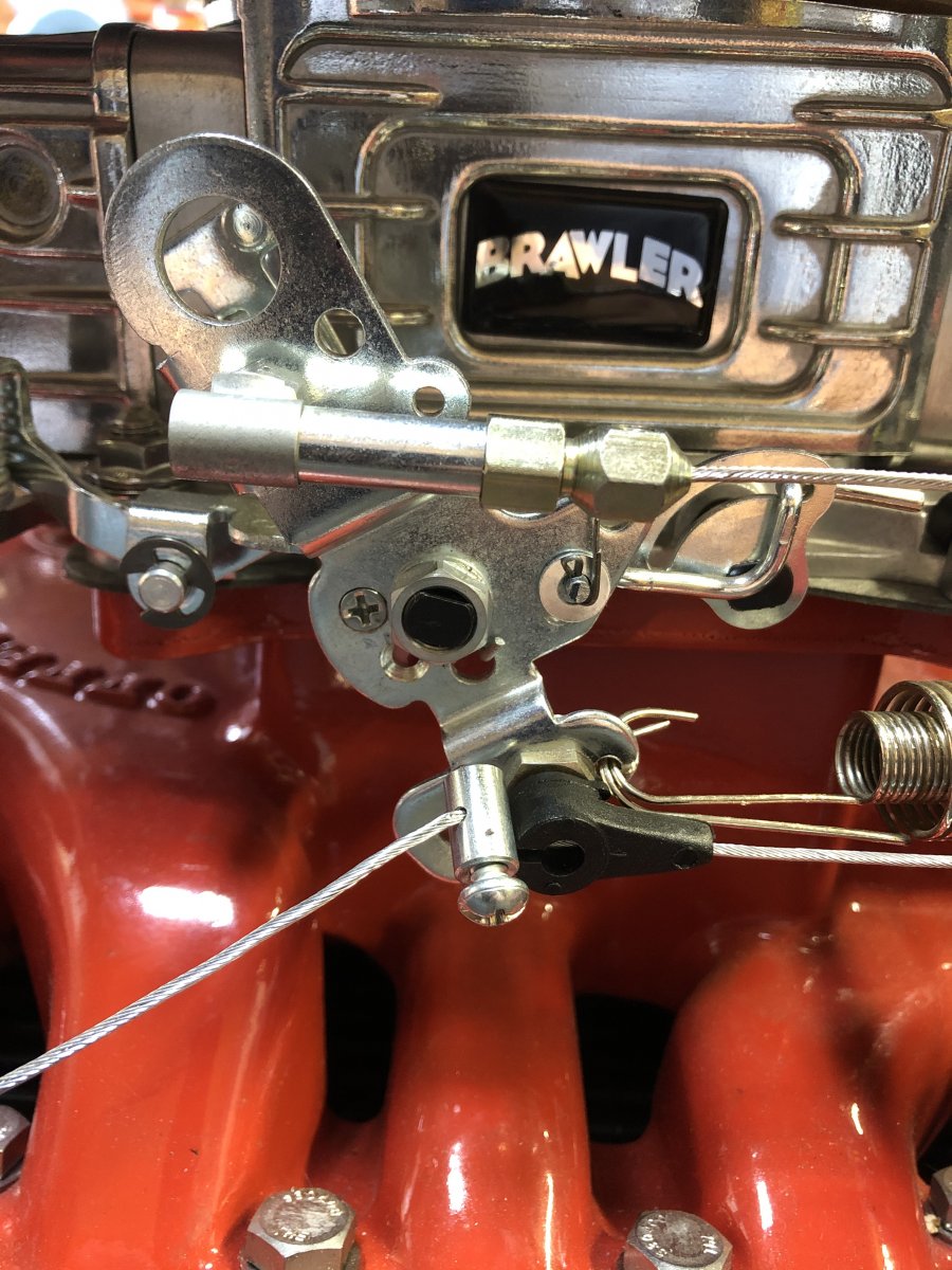

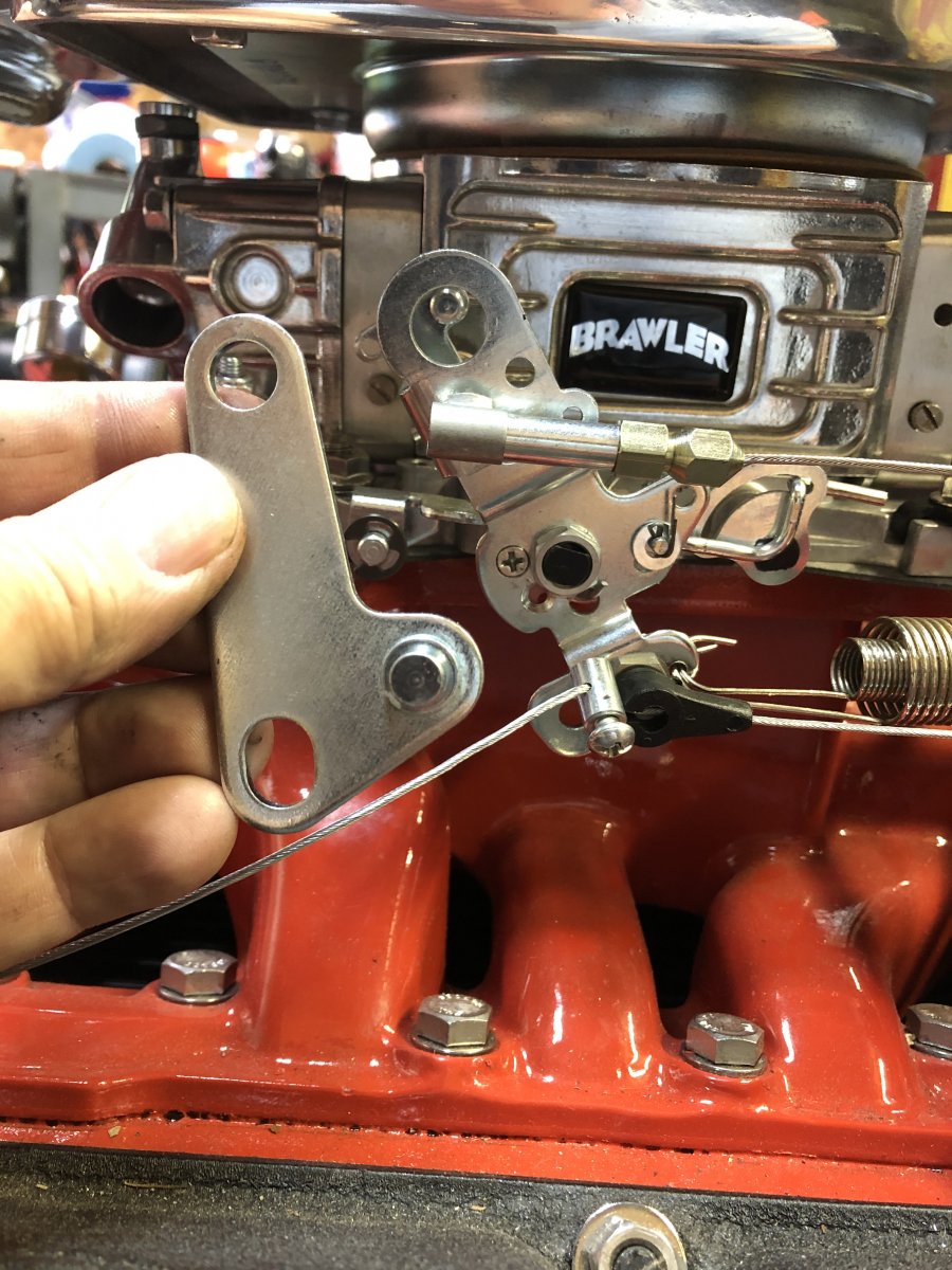

    EE82F460-498D-439F-B135-404290D678BF.jpeg FACFC78F-F1F3-44C7-B281-1B53418872BB.jpeg E9DCC00C-169C-464E-97B1-B1CB1FED1AA9.jpeg C356C2A9-AB78-47E5-9B43-4CDA712A820C.jpeg C356C2A9-AB78-47E5-9B43-4CDA712A820C.jpeg So, I replaced my induction with a new Holley Brawler carb and mated it to a 200f4 ******. Now I am well aware of the relationship to the TV cable and the carb linkage. My problem is I am not sure if the way I have it set up is correct. I have contacted Holly performance and their tech department actually was not very much help. I showed him the photo that I have, and the best I could get was, it looks like it should work. Well I don’t want to damage the transmission. Does anybody have any experience with hooking up the TV cable to a Holly brawler carb? The Brawler side linkage is different from the typical 4150/60 linkage. Supposedly the new linkage already has attachments, but, my setup looks sketchy to me. The adapter arm I thought I may need doesn’t look like it would work on this application. Thanks and sorry for long post!
