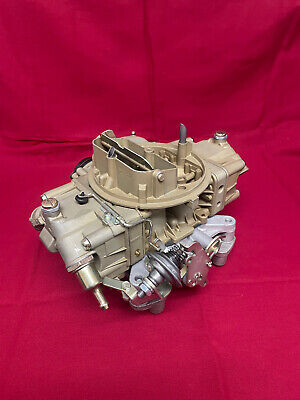

  11. Deuces
    Joined: Nov 3, 2009
    Posts: 26,705
    Deuces
    Here's some pictures of one on ebay... The seller is asking $1500.00 for it... Yikes!:confused:
    s-l400 - 2024-04-30T064315.050.jpg s-l1600 (15).jpg s-l400 - 2024-04-30T064426.079.jpg
    Bob Lowry and squirrel like this.
