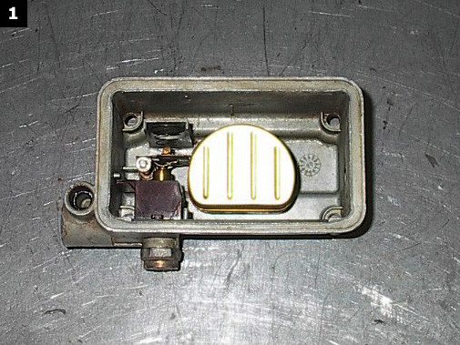

    I have one of those carbs too and will check into the recall,if I known it had that type of floats I would not have bought it. I guess it would need new fuel bowls to convert it.

    You may not consider that an adjustment, but every carb maker other than Holley does, and now with the new version Holley does also! For many years every repair kit for all makes of carbs describes the "adjustment procedure" for floats as bending the tab to set float level. This is the industry standard method for adjusting float levels, not a modification. This is not like bending springs on your suspension to adjust ride height, since that is NOT the way you adjust ride height normally. Bad comparison.

    Ok so I took the float bowl off of the carb and cleaned out the needle and seat. No issues there, and BB427, I understand what you mean by bending the tab on the float and was able to adjust it to a better position; however, when I put everything back together it started up great and ran for a few seconds but while trying to tune the idle circuit everything started flooding again so I tried turning the idle mixture set screws all the way in on both sides and test the power valve and turns out it was blown...got a new one and now waiting on time to install it. more to follow. Thanks all for the help.

    How did you determine the "better position?"

    Check your floats .Make sure they will float and that there not full of gas. You can buy a kit for the externally adjustment needles.

    I made a calculated presumption that a flooded engine means too much fuel in the bowls. Based on that I looked at the maximum vertical position that the float could reach (well above parallel to float bowl floor) and decided it would be appropriate to try and lower the float maximum slightly within the bowl. I can't decide if it's truly better until I get proper fuel pressure going into the carb, but based on what I have been researching it was a logical step.

    there is no sight plug in the fuel bowl with the 4160 non adjustable float version. It is all guess and check with either a afr gauge or the trusty spark plug test.

    Or pull the bowls off and do a quick visual. I use the blue gaskets on mine, so dropping a bowl quickly is easy, and they are reusable so saves money. A shot of Pam cooking spray also keeps them from sticking.
