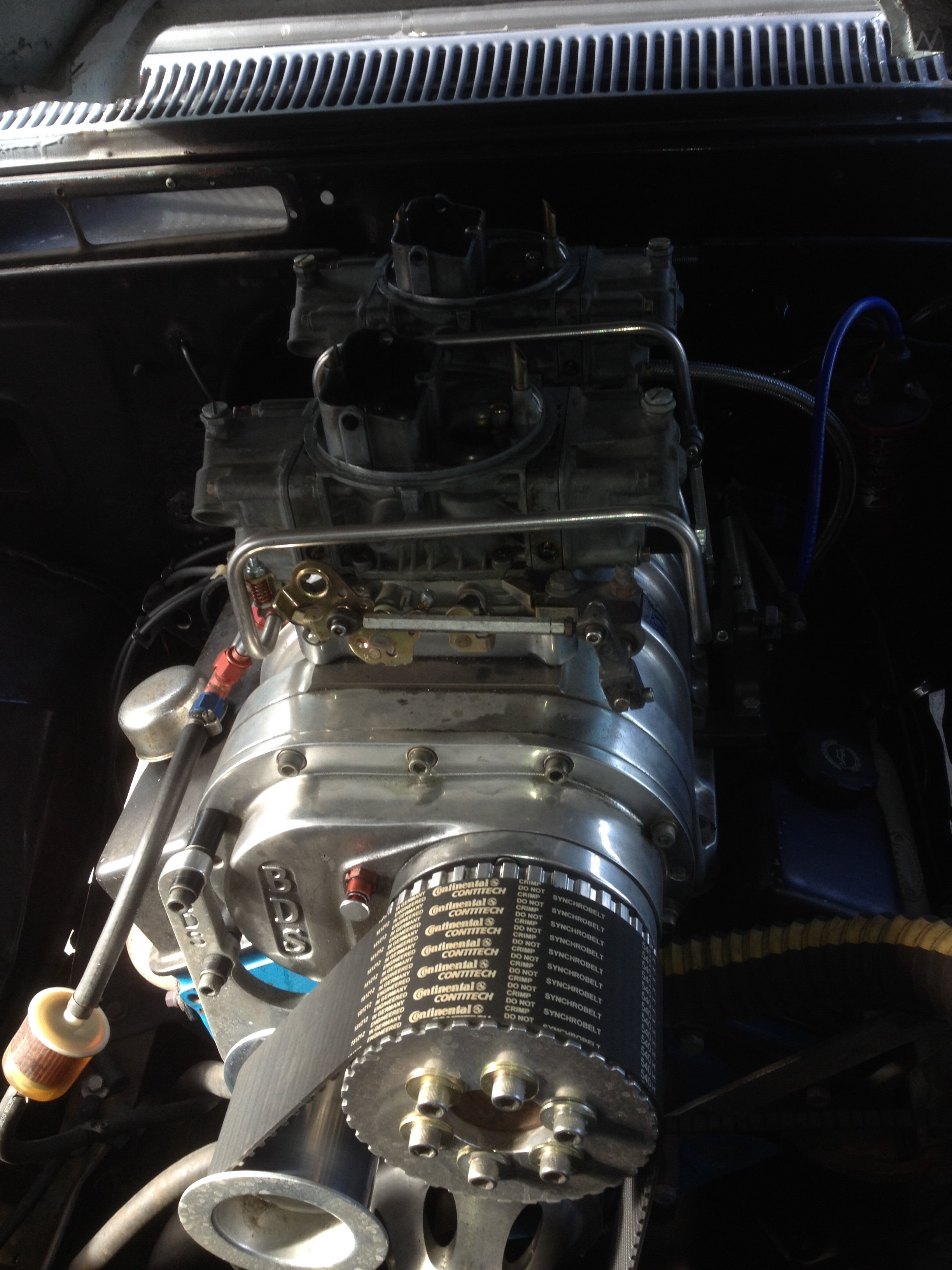

    image.jpg Blowers also like a wide lsa. I would go minimum of 112*. Even at 6# you're talking 40% hp increase with a roots blower. I hope I'm not discouraging you, that's not my intention at all. I just don't want you to melt down your engine or chase a terrible idle situation that can't be fixed without the proper parts. Boost referenced power valves are quite simple also. Especially on a single carb set up.
  8. IMG_2155.JPG [/ATTACH]
    This blower installation is more about nostalgic appearance than it is performance. To me it is another high dollar fashion item like a Halibrand quick change. I'll probably never drive it like it was a race car so I don't care too much about the performance. I'd just like it to be reliable and not over heat. This engine has a couple thousand miles on it and I'm locked into it for now. I can change carbs now if it is necessary. If I change cams it will have to be when I replace the melted pistons.

    Just asking...Would a 4-71 be large enough to make much boost, at the ratio in the pic, I'd be supprised if it got to 5psi..yes/no?
  13. Sorry for the late reply. You are right, probably about 5 pounds boost. It is intended to look early 60's and even though it is not apparent in the picture, it is slightly over driven. It is also a very snug fit.

    from ct
    Yes it do look tite...In my opinion you have a proportionate package, nothing overwhelms..Wonder how long those belt labels will stay lined up..:)
