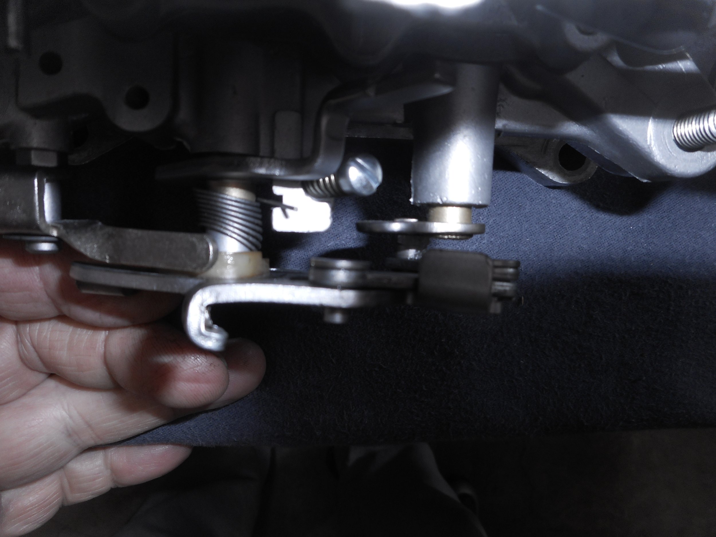

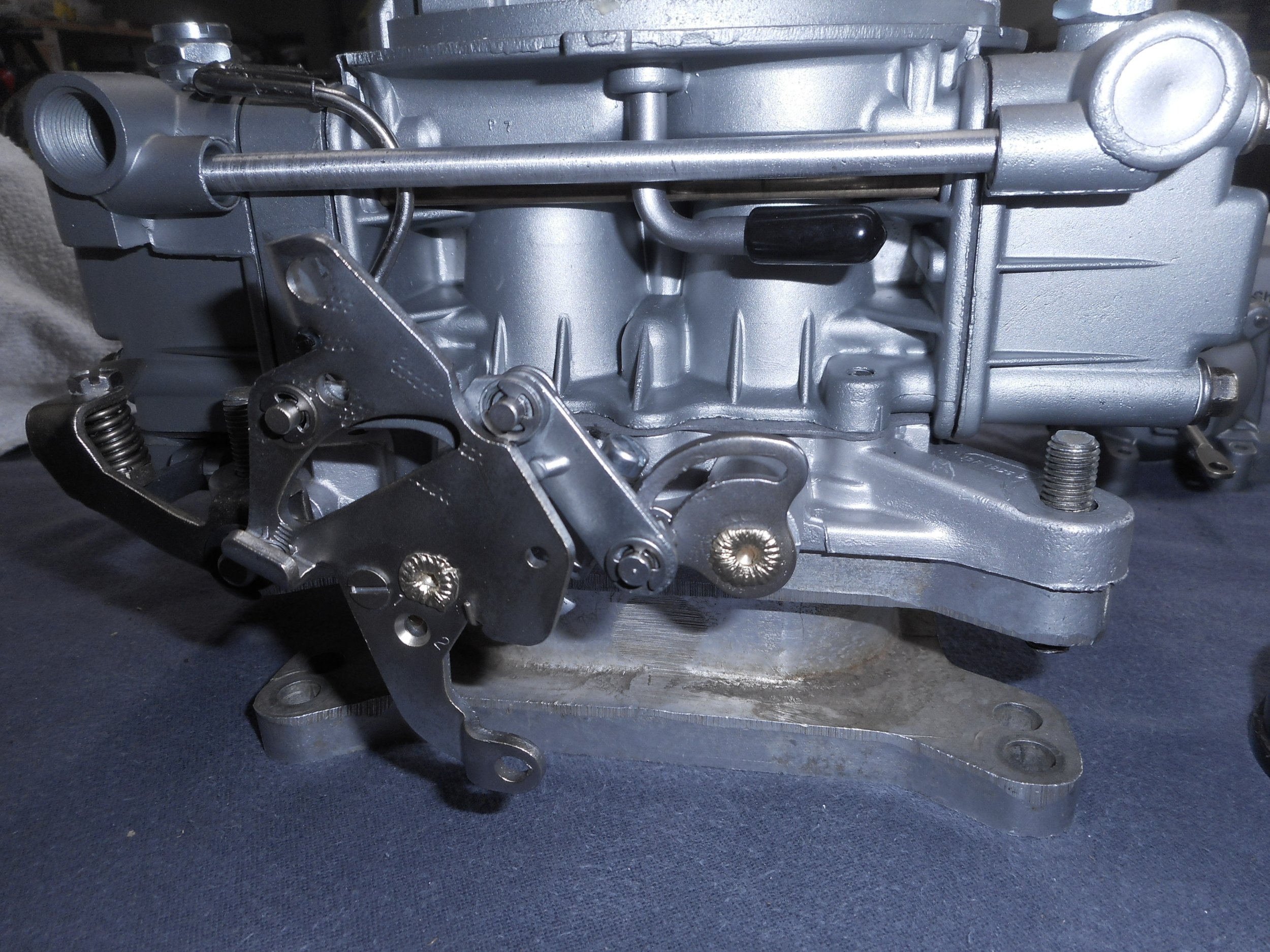

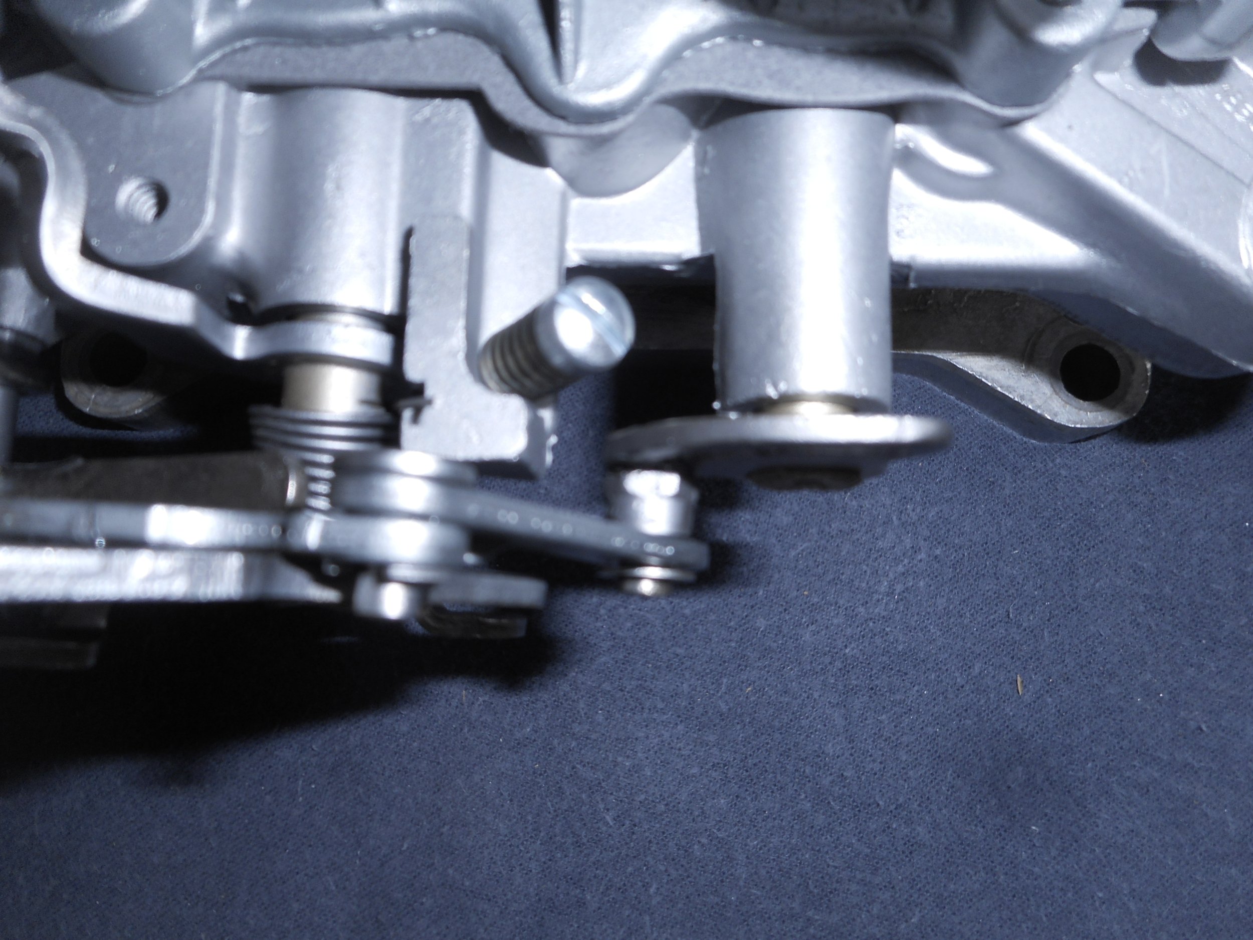

    I should have mentioned, I have been restoring and rebuilding carburetors for 25 plus years and have never seen a carburetor like this. I haven't had much luck finding information for this carb, but I really don't think it needs the vacuum canister. That is why I'm here hoping to get an answer from some smart people. Here's some pictures. Buy the way, Allstate had what I needed. Thanks

    so you are curious about the direct link on the secondaries? Perhaps it is a kit that was installed long ago, to do away with the vacuum can to make the carb into a fake double pumper, but without the secondary pump?
    That linkage does not look like Holley stuff.
    jaracer likes this.
  10. jaracer
    Joined: Oct 4, 2008
    Posts: 3,046
    jaracer
    Like Squirrel said, I also do not believe that looks like a Holley setup. It's almost like what we used to do with a small machine screw and nut in the slotted link.
