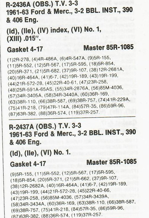

  4. Boneyard51
    Joined: Dec 10, 2017
    Posts: 6,776
    Boneyard51
    Jim could you check to see what metering blocks were used on List # 2436 and 2437? Thanks!
    That’s ok Squirrel, I got that info just now on another thread! Bones

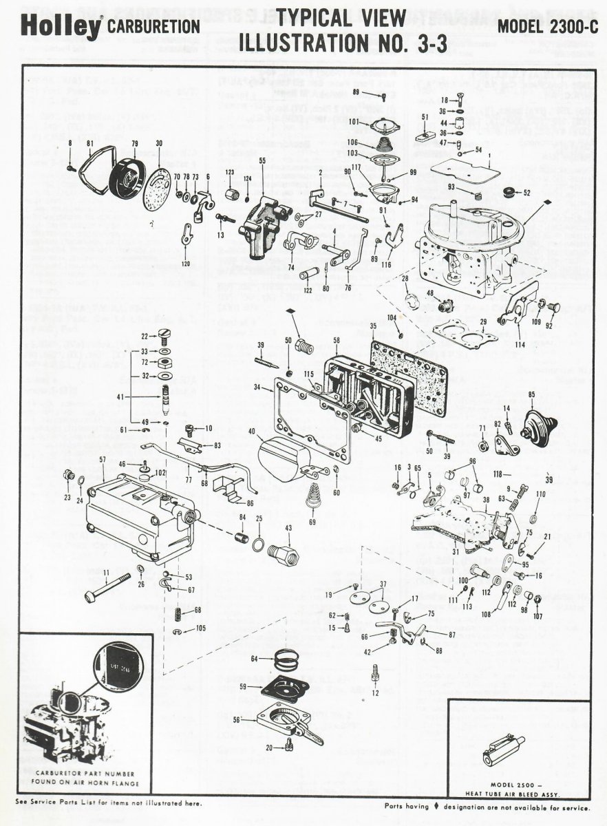

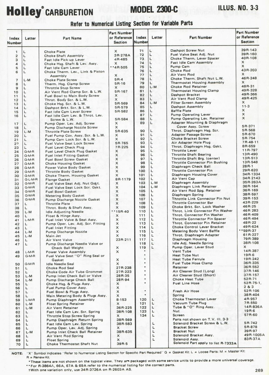

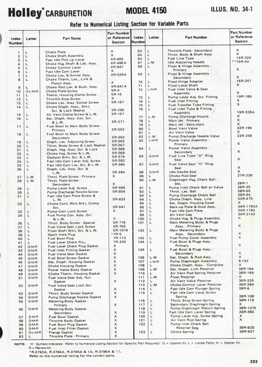

  8. squirrel
    Joined: Sep 23, 2004
    Posts: 59,927
    squirrel
    here you go, have fun

  13. squirrel
    Posts: 59,927
    squirrel
    I expect there was information about it at Holley, but for internal use only, not released to the public.
    I wonder if it's still around?
    Boneyard51 likes this.
  14. Boneyard51
    Posts: 6,776
    Boneyard51
    Thanks Jim, that is the first chart that I have seen, that actually told what metering block went with the 2436/37 carbs. I don’t have these metering blocks, so I am trying to figure out what will work in stead of these. Again thanks!
    Edit: I do have a bunch of Holley carbs with a bunch of different numbered metering blocks on them. I would just like to know if one of them would work on my 2436/37 carbs? And if so, which would work best? There has to be a reason there are hundreds on different numbers on metering blocks!?
    Bones
