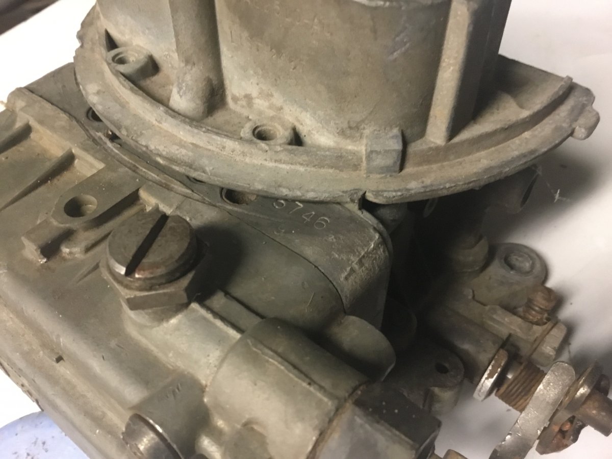

    Here’s what I’m talking about. 9B77687E-34A7-43C5-A4AE-7BE98E26D6C5.jpeg 8EA92D43-37F9-4AB5-AE40-0BE4F3D3A8A4.jpeg
    I know where swade got that, I used “ plates” instead of “ blocks” ! I’m looking metering “ blocks”! Sorry for the confusion.

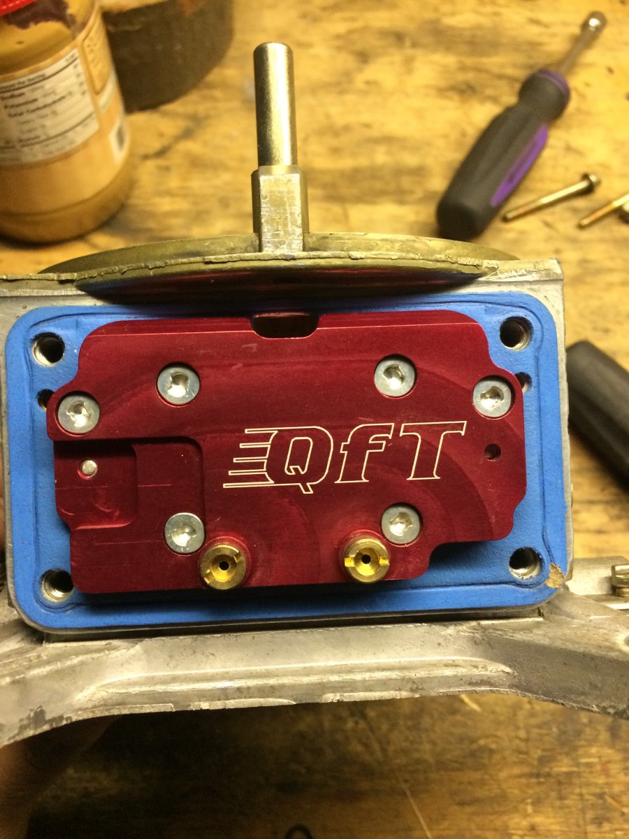

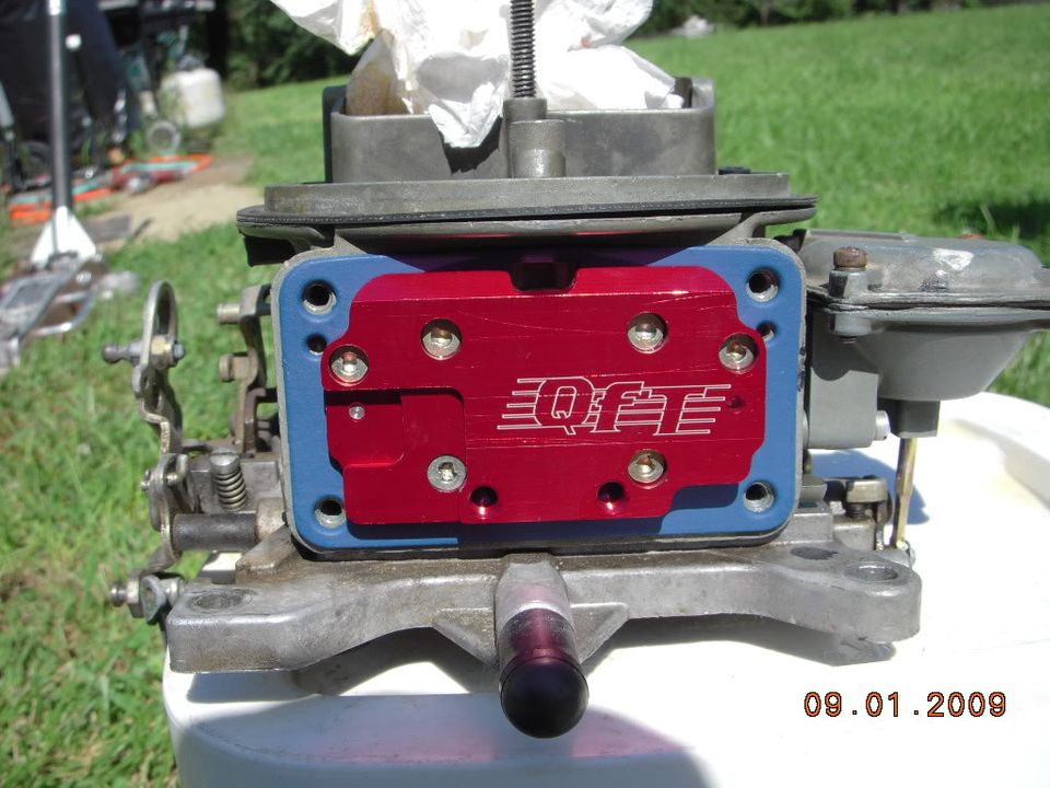

    You can buy aftermarket metering plates with jets installed.... Those use high speed air bleeds....
    Correction... You have to install your own jets.....:rolleyes::oops:
    Here's a couple of pictures of hat they look like....

    If you look at the pics Deuces posted you can see that the plate replaces the metering block on that carburetor. Then look at Swade ‘s post and you can see all the different plates and what the differences are. This is the chart I’m looking for for metering blocks, even thought those blocks have changeable jets. There are differences in them. I’m going to be trying to make a three deuce set up run and run right, and at this time I do not have the correct metering blocks. So , I have no problem using another number, as long as it will work. But it you look at swade’s chart, you will see a lot of differences in different numbers! Also look at Holleys numbering system..... or lack of system to be more accurate. While the chart is progressive in size, the actual numbers are all over the place!

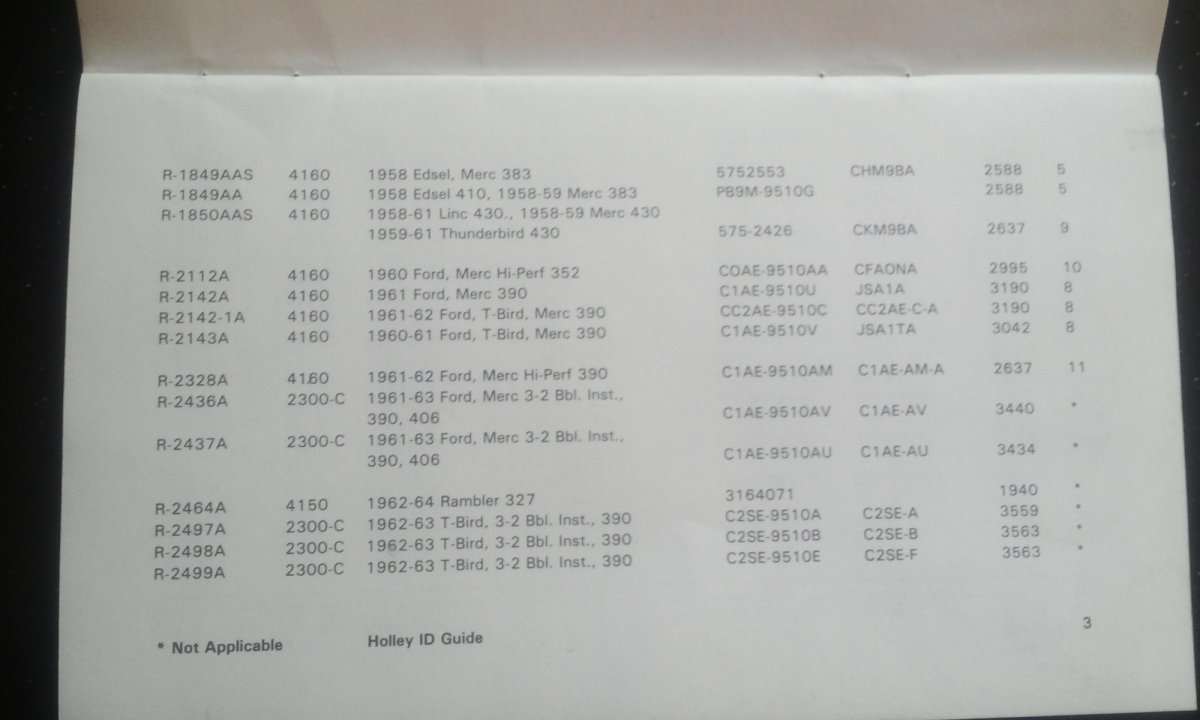

    This is the book I have, I guess I was trying to convey that each number had a different size idle hole and main hole the same thing to a point on a metering block, sometimes those numbers even match between plate and block, but the time to actually look at those numbers and sizes were lost in the haste to post I was posting the wrong thing.
    These are indeed for plates not blocks as Bones suggested, I use them in the rear of my 4160 style 450's for adjustablity instead of swapping out plates to get a bigger main hole, just wanted to clear that up.

    I have never seen the info you are looking for printed. I have this Holley identification guide, it will tell you what blocks go with what carbs. Not just Ford carbs either, Chevy and Chrysler too book.jpg print.jpg print.jpg
