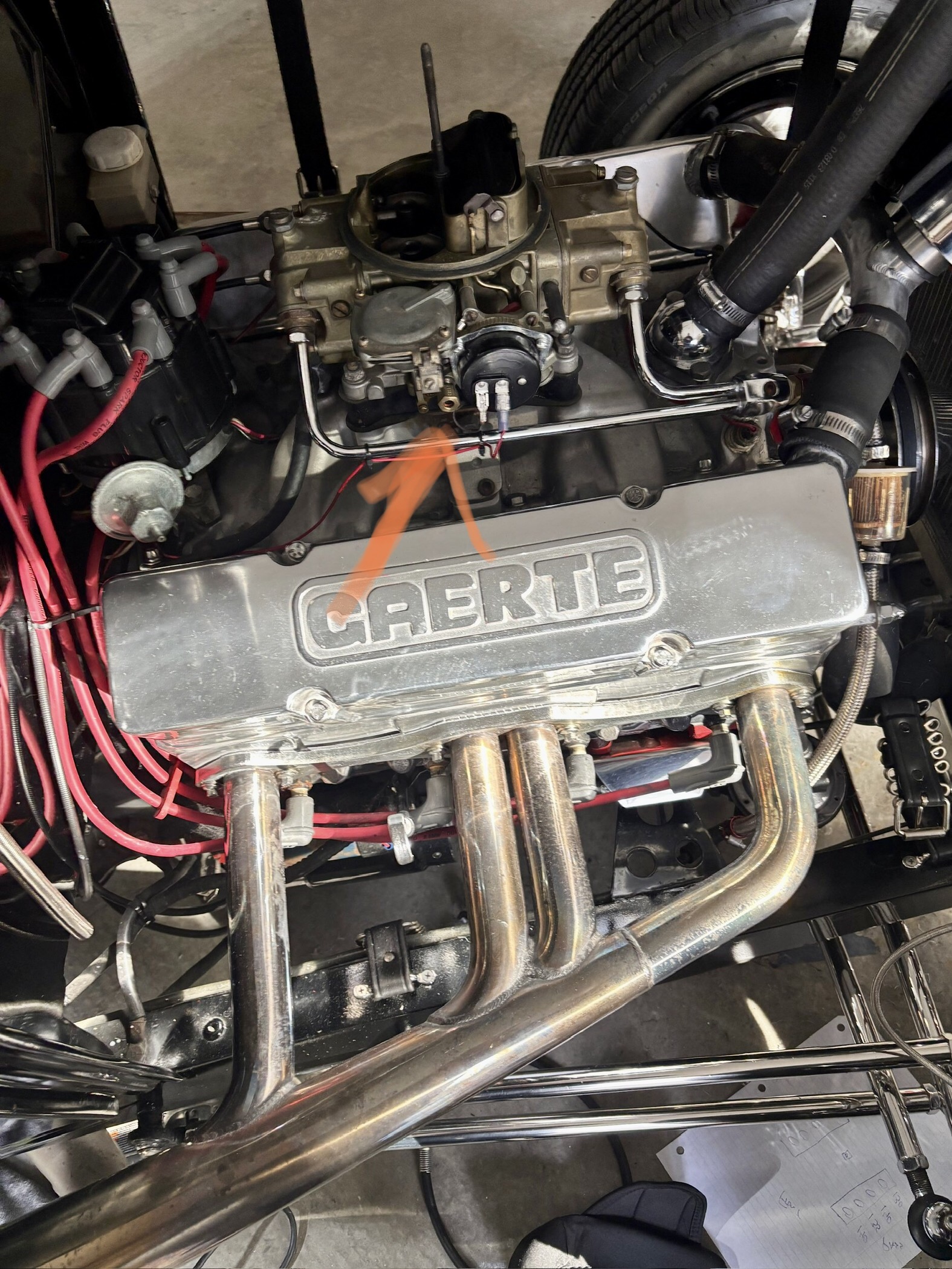

    Sure of course it is difficult to diagnose long distance. Kinda why some of us focused on the one thing that shows in the picture ( disconnected vac adv) that would literally take less than a minute to hook up and see. Then if it didn’t make a difference he can diagnose from there…

    To hook it up and see what?
    If it's a stock, unmodified HEI (which I believe it is by the picture), that would automatically give it 20* vacuum advance at Idle when hooked up. That's ***uming the vacuum diaphragm isn't broken... and it was connected to a full manifold vacuum source.
    Of course, if it was connected to the ported vacuum source, it wouldn't give it advance until the throttle blade was opened past the transfer slots, and then it would add advance. The factory set it up that way to p*** EPA idle emissions tests, thus mandating only a 6* initial timing. Remember that from the gas crunch era of the mid-70's?
    Of course, all of us "hot rodders" know that more initial ignition advance gives better throttle response, more power and better gas mileage, at the expense of oxides of nitrogen, which is supposed to be bad for the environment (yeah right).
    What if this set up (with their choice of cam, heads, carb, etc.) wants (let's say) 12* initial, 14* mechanical and only 10* vacuum adv. because of cam, compression, cylinder heads, fuel quality, etc.?
    To make this puppy run right, it would require a fully adjustable electronic distributor, (and know how to adjust it), which could cost upwards of 1000 bucks, maybe more. Maybe the guy that ***embled this combination got cold feet and decided to sell the project as is, and WAHLA!, "Let's just put that old HEI in 'er and sell it..."
    To make it run "good enough", it would mean setting the stock HEI at about 12*-15* initial advance, plus the 20* mechanical advance built in from the factory and unplug the vacuum advance... but it may have an off idle flat spot... especially if he doesn't know how to adjust the jetting in the carb to match. This is why a lot of these sort-of-cool projects get a bad track record.
    Maybe that's why somebody left the vacuum advance unplugged. IDK Just guessing...
    But any way, back to the subject at hand: Holley or Edelbrock Help!
    Nicholas, I believe it's neither Holley nor Edelbrock... It's a combination of ignition timing and fuel requirements with this set-up. Roll up your sleeves and get into it, it's not that hard. You can do it!

    The choke heat tube isn’t hooked up either, I’d hook it up along with the vacuum advance and see how it runs.
    Looks to me some money was spent on the engine, guessing it has a performance cam and depending on what cam etc. more than likely it will idle rough. A vacuum check at idle will tell a few tales.

    The vacuum for the heat tube may be blocked as with an electric choke heater , it's not needed .

    I know it's been awhile but I think I got it pretty well tuned in now hooked up a vacuum Line and also tweaked the distributor a very little bit and adjust the idle some seems like it has helped a bunch now if we start getting some better weather I might be able to enjoy it a little
