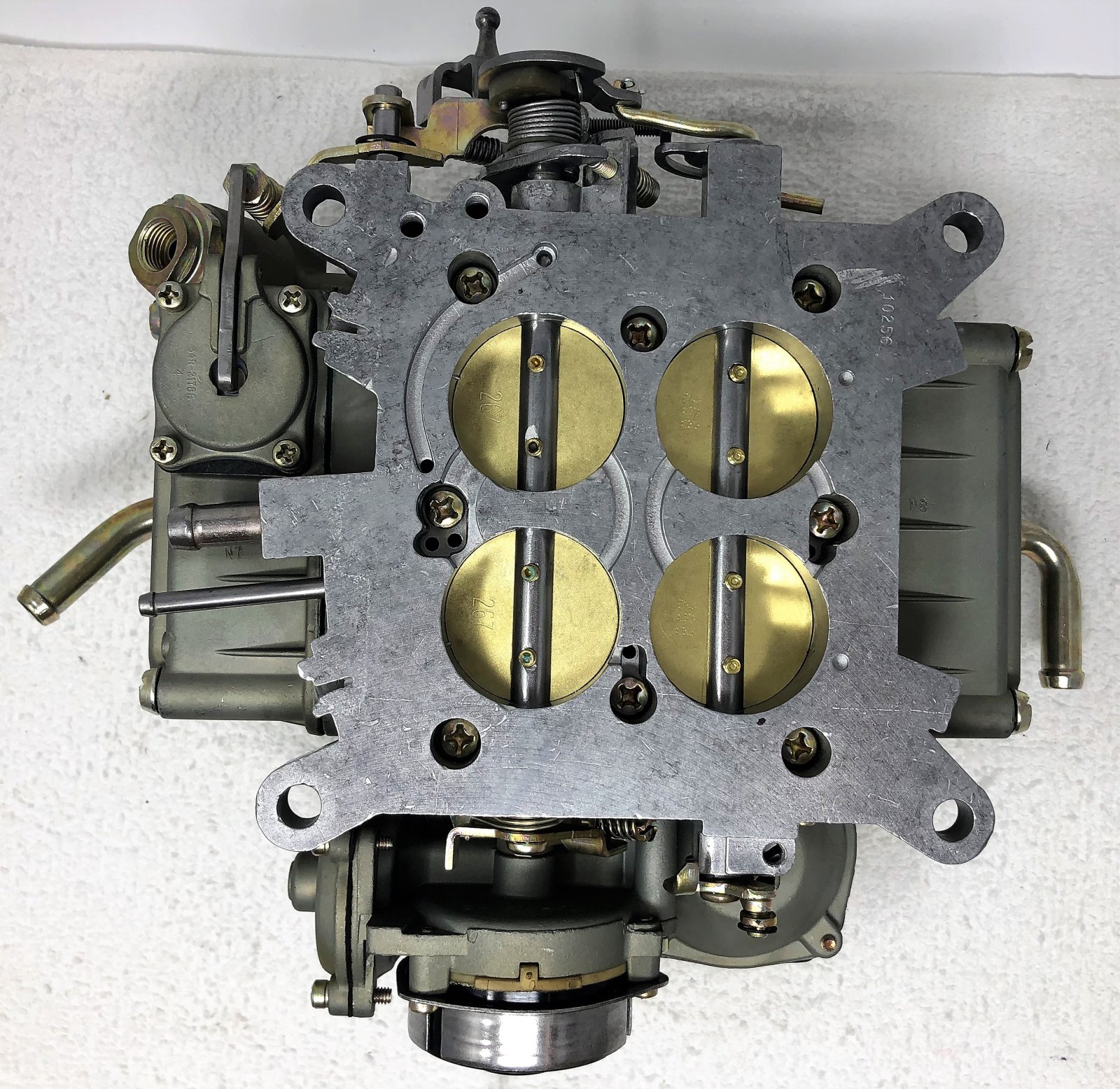

    Chuck the 50259-2 in the nearest can, it does have mixture screws but are in the base plate and plugged. The plugs have been removed in this one by cutting slots and knocking out the plugs. I dont even keep those for parts. ND4851A-Bottom.jpg
