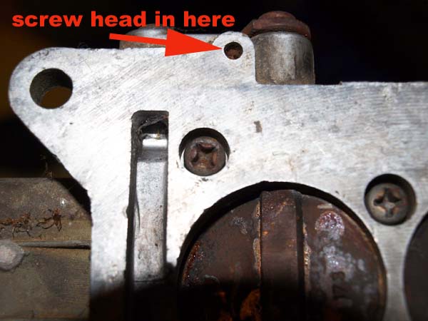

  9. Also on a holley if you turn it over there is a tiny little screw that adjusts the opening of the secondary*****erflys at idle. Check and make sure that they are not propped open to far, it will draw fuel at idle from the secondaries if they are proppeed open to far and make it an eye burner. You should just barley be able to see light though the throttle bore when they are set correctly.

  10. Porknbeaner, any pics you can post of this screw for the secondaries? I will take a look at it later....yeah just going to be a mild street car
  11. I have to snap some pics of some carbs I have for sale I'll get you one then. Let me look and see if I have a pic of one that is usable in the mean time.
    Nope don'y have a good pic. Give me a bit and I'll get you something.
    OK here are some pics that may help, nearly all holleys have a way to adjust the initial opening of the secondaries and it will normally be on one end or the other of the rear throttle shaft, more often than not on the opposite side from the throttle linkage. It will almost always be done though a hole in the bottom of the carb as well.
    What happens is when these*****erflies are open too far the vacum draws fuel from the booster, if you are idleing you don't need that extra fuel and you get an eye burner.
    Hope this helps a bit.

  12. thanks....I know years ago my dad drilled the*****erflies on my brothers 67 Camaro due to a similar situation, it worked great that car ran the balls and with a healthy cam...but I really dont want to go that route, just want to do adjustments...the car ran great as mentioned, just loading up a bit at idle.
